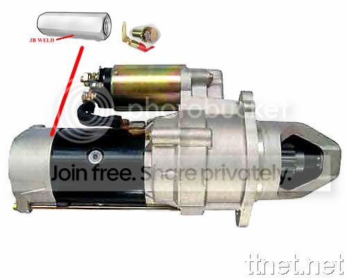

Uh OH, hold the phone. The copper lead that comes out of the starter motor will run away if not secured? Or are you all worried that the end of this lead once connected to a 2g battery cable will wobble around and eventually short against the starter case?
I could JB Weld a brass coupler on the starter housing, then attach the Starter motor tab with a bolt/lock washer to one side and the HOT lead from the Ford solenoid to the other end of the coupler with a bolt/lock washer. Semi permanent and secure.

Mostly worried about flexing causing the copper lead to break, or touching something.
If your starter looks like that pic, its slightly different from the last one I worked on.
The one I worked on just had a short square tab coming out of the starter directly below the place it mounts on the solenoid, and was just long enough to reach.
If you have that much to work with, its going to be easier.
Your idea for a coupling sounds OK, but I would put something besides starter paint and JB weld between the coupling and the steel housing. Maybe glue or clamp a piece of heavy plastic on the starter first.
Make sure that the coupling is as short as possible. Brass conducts pretty good, but not as good as copper.
FORDUM, thanks for the feedback. My starter motor Tab is a long pigtail. In the neighborhood of 4 inches with a zinc plated tab. What I think I'll try is to simply overlap the battery cable lug with it and run a short nut/bolt/star washer set through them and cover the section with this heavy duty 3/4" MILSPEC shrink tube. It is NOT going to wear. I may end up running a zip tie around it locking it to the end of the starter motor. That should be enough. I'll see if I can get some pics later.
