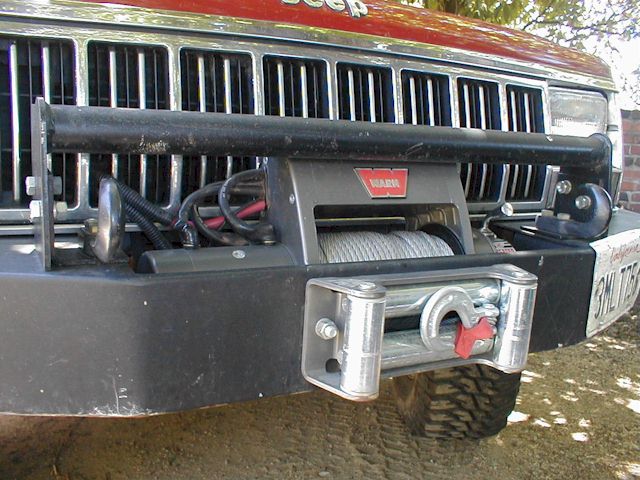

Last time we went out, I had to winch out of some semi-deep mud. The closest tree was in front and to the left (about a 45* angle). My spotter neglected to mention that the cable was bunching up on the left side of the drum. Even when I asked if the cable was fine he gave the universal thumbs up. :waytogo: Then I heard a snap and when I checked it out, I found that the cable pushed up on the two chrome bars/rollers that are on top of the winch until the mounting points broke clean off. Now that I think about it he may have been sticking out his middle fingers and not his thumbs! :angry1:
Also, now it seems that the drum does not lock when I release the button. It keeps spinning and won't hold the weight after released.
1. Do I really need those two bars or can I just pull them off?
2. What could be cause the problem with line lock? Could it just be a relay?
Any help would be great.
-Alex-
sounds line you have a burnt up brake. Call the manufacturer. those rollers keep you from tearing up things when winching, fairleads is their real name.
I think he is talking about the two cross bars on top of the winch not the fairlead rollers. IIRC they add strength to the winch assy. If just the bolts broke and the housing and bars are fine, I would get some new bolts from the service center that does the repair on the possible brake problem.
Big Sub, that you? cool!
yup, I would keep/fix those chrome bars, swap to synthetic line, and call it good. :) chrome bars are the support from one side of the winch to the other.
might be toasted clutch, how old is the winch?
This will give you a better idea of what I mean. The red is where the metal broke off. The screws are still iin the bars.
Then the housing is broken? If so, that sucks:doah: . Time to see how good the warranty is. You might have to get a housing from a bad winch to get the pieces you need. Or how 'bout JB Weld?
Crap! That what I thought. i don't think I can use the warranty for this, so I'll just get someone to weld it up. Thanks
