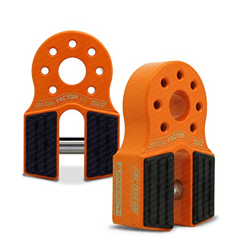

All that said, I'm thinking about getting one of these flat links and putting a hook in the tool box.
http://factor55.com/product/flatlink-e-expert/

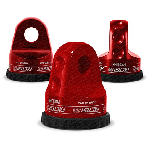

Cool products. I like this:
http://www.amazon.com/Factor55-FlatLink-Loaded-Shackle-16-000/dp/B00K284HKE/
or this maybe, though it may look a little funny sticking straight out:
http://www.amazon.com/Factor55-ProLink-Loaded-Shackle-Titanium/dp/B00QQNKPE6/
I guess it would take two clevis's to hook to a bumper with this? One to attach to the other person's bumper, and one to go through the prolink/flatlink? I mean, assuming there are clevis mounts on the bumper.

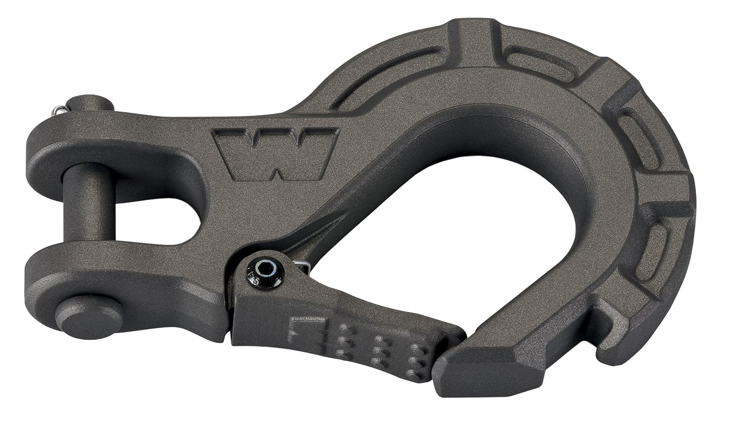

Raising this one from the dead because I'm still thinking about what to do for a hook. I thought I was going to go with a flatlink, but I'm liking the idea of the large sized hooks that can fit easily over a shackle. Any opinions on the Warn "epic", or the Master Pull? Warn is like half the price, not sure what the other offers for an extra $75 (besides 25K limit instead of 18K).
I hate tab lock hooks like pics posted.

I've been rethinking winch hooks myself. I have a Prolink, although I wish they flatlink would have been available when I got as I like it better. Anyway, when we had our snowmageddon fiasco of a trail run back in November I found that we had some trouble getting enough d-rings for all the recover connections we needed. So I've been trying to figure out ways to eliminate the need for d-rings where possible like using a hook for the winch line.
I really like the looks of the new Warn stuff, but we all know we shouldn't choose based solely on looks alone. My preference for a hook would be the style sweekk30 linked.
Those hooks come in 10K, 18K, and 25K ratings. I have a 9K winch, do you guys think the 10K hook is sufficient? It's big enough to easily fit over a 7/8" shackle. I know people like to overkill stuff...
I think overkill is the standard, really. Having been in several "Snowmageddon"™ winch fests, I reevaluated how heavy my equipment is, as well as how much. I will not use synthetic line, and replace all my cable with 7/16
