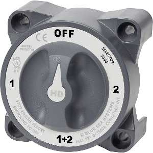

first thing is definitely put an inline fuse.... and maybe a battery selector.. so you can shut power off to the winch if you need to...
i got a 500a fuse to put inside of this..
my winch can draw 460A max
and this switch
just remember.. you want to be able to shut power off on that thing if anything happens...
