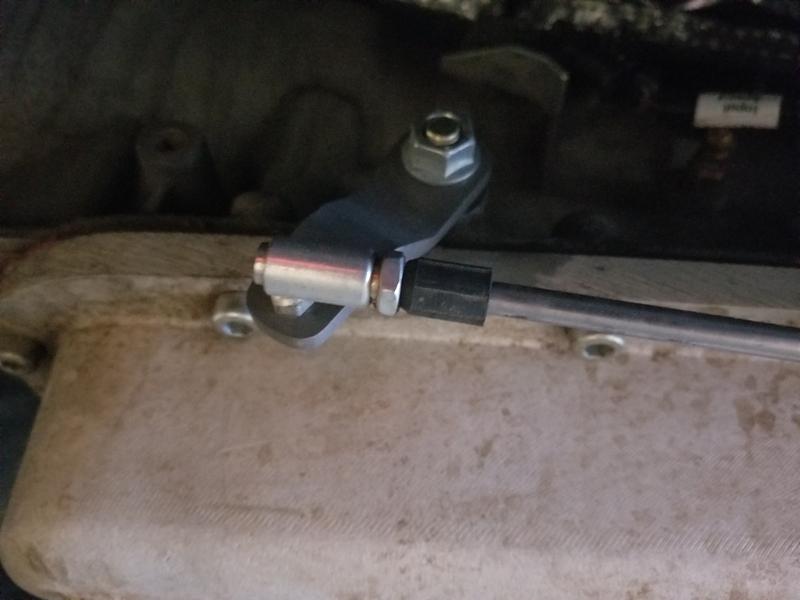

I assume the arm you made is longer? Do you have measurements or a side by side comparison to the one that was supplied with the shifter?
Yeah, my brother (the one on the rockwells/47's) told me about that. It was also a bit of a shakedown run for my oldest brothers blue 78 K5 you saw after swapping t-cases (in fact, he swapped the old SYE 241 that used to be in my blazer into his), new shafts and a locker too. My brother sent me a pic he took of your rig and I instantly recognized it.
I'd have to disassemble it to get an accurate measurement. If I recall correctly it was longer and clocked differently. I machined the broached section, but you could easily grind it out with a die grinder, or just weld on a new end to the existing arm.
Here's my chitty attempt to make one thats clocked differently out of some steel bar scrap I had. I left the 2 holes already cut the scrap which gives me more adjust-ability. Unfortunately, I rushed the slotted hole and made it too big. I have maybe 5 minutes into it as you can tell. I can try to make another with the correct bends and correct size of slotted hole along with corners ground and paint.
ANOTHER option is this guy from Lokar. It allows infinite positions of clocking and distance from trans shift shaft. I was worried it was straight but if you look closely, its recessed at the shaft area and its suppose to clear the 4L80. Only problem is its price of $55. They sell another one with nice shifter rod and heim joints for $61. Flaming River and Summit also make something similar. Flaming River is like $93 and Summits is almost same price as Lokar. CPP looks like theirs is $38. I might just do that option and be done with it.

I just ordered the CPP part along with some other things from Summit. I think this will be the fix without relocating the cable back.

Finally got that arm installed and removed the bracket I made. That did the trick! I used the same ball/socket on the arm but had to use a couple small washers. I'm not sure if the heim joints would fit the winters cable and never tried. And I used a couple thin washers to space out the brass center a little. Shifts much better like its suppose to.

Nice! And it goes into all gears now?
