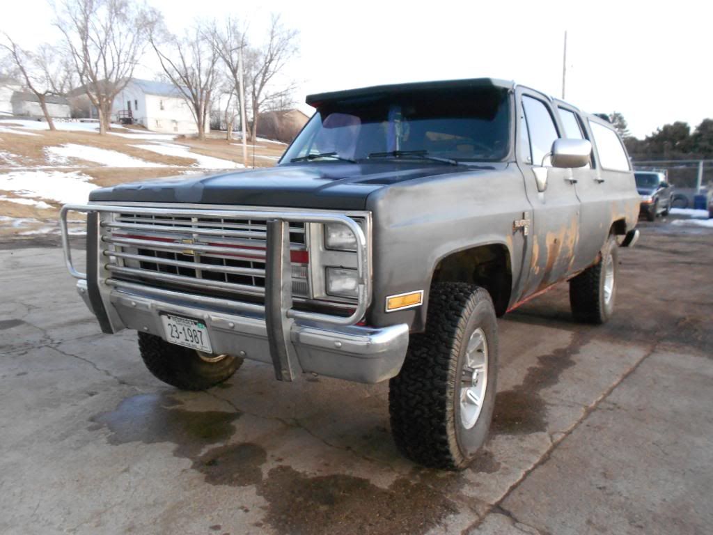

WL: 1988 V10 Suburban
Pretty awesome.

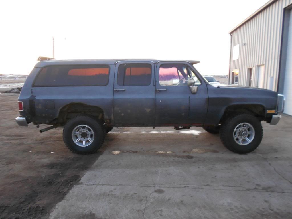

I prob have dropped the shroud a lil but that's just me
Thank you.
As for the shroud, it barely rubbed and nothing was hurt by the "self clearancing". I guess I am just lazy.
Martin

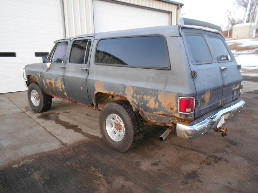

nice looking rig man, i like that stance with the narrow wheels and low lift. though i have no idea how you guys deal with rust, i wouldnt even bother building 4x4s if i lived somewhere that had rust.
I guess the rust doesn't really bother me. It has no ill effect on off roading capabilities, and I don't feel bad smashing up ****ty sheet metal. I have no desire to own something that has a clean body on it.
Martin
Balanced the tires last night. Wow those Hummer tires are junk. I had never seen a tire machine ask for a 9oz weight before.
Martin
Ncie build man makes me miss my old burb. what are you going to do about the rot on the body?
Power wash it, and spray a fresh coat of Krylon over it. Maybe. Depends on how ambitious I get. I really don't care what the body looks like. To tell the truth, I preferred how it looked with the stock 16.5 wheels, but those tires I had were shot. I stumbled across a good deal on a set of 17" tires, so I needed some wheels for them. That is when I went looking for the H2 wheels. Then just by chance I found these with brand new tires on them for $500. I think I will just run these BFG's for awhile. I'll still be looking for another set of H2 wheels though.

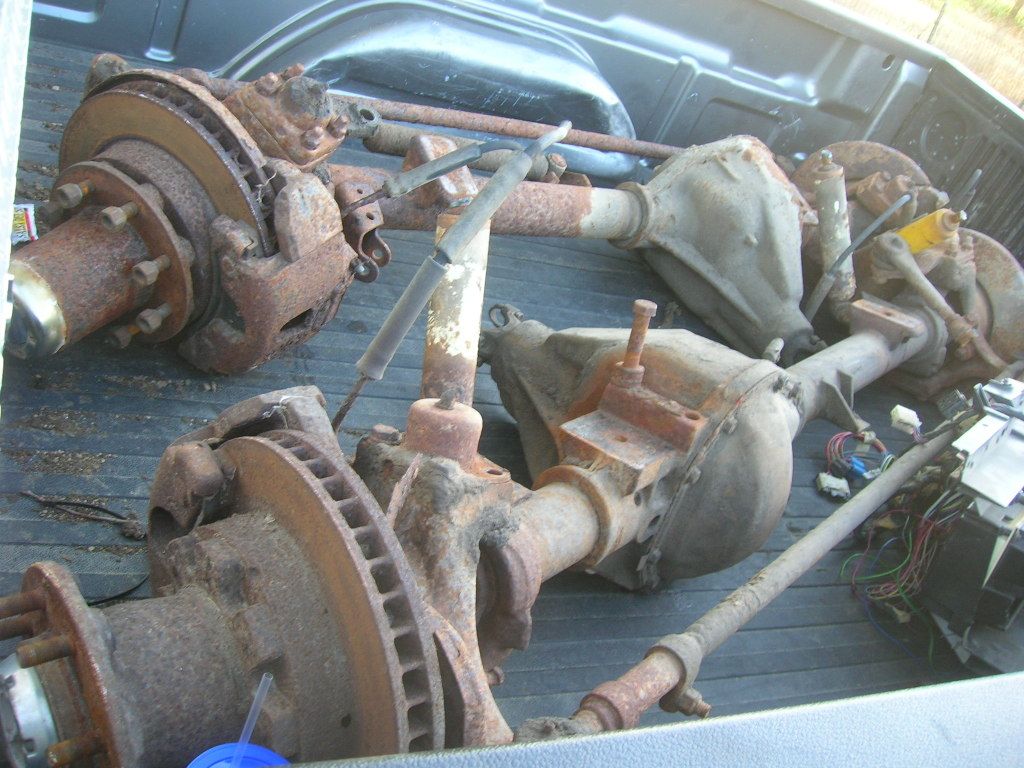

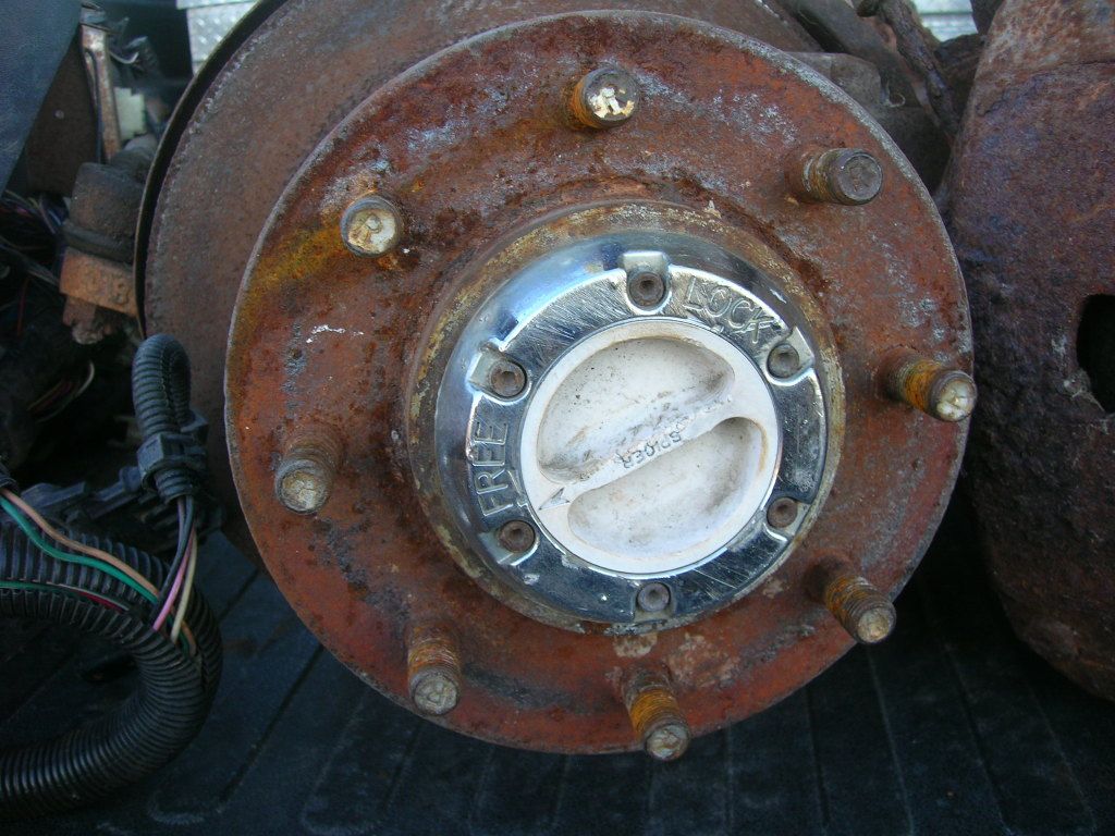

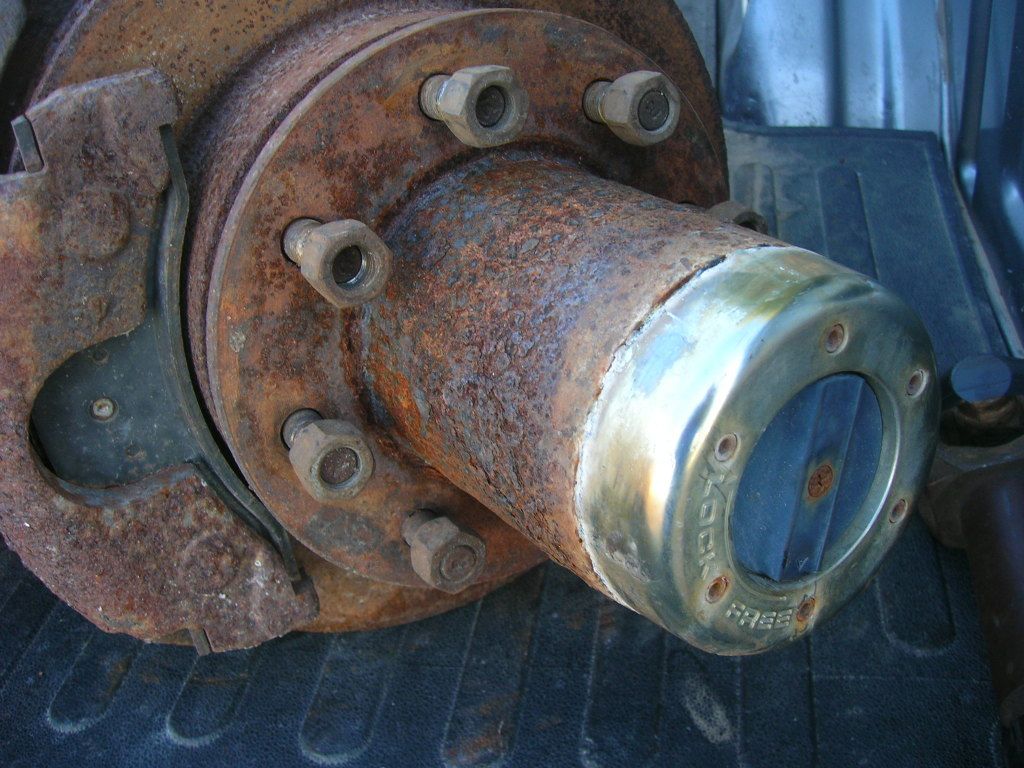

Picked up a 4.10 SRW for $650, and a 4.10 DRW for $550. They're a little crusty, but complete.
Martin

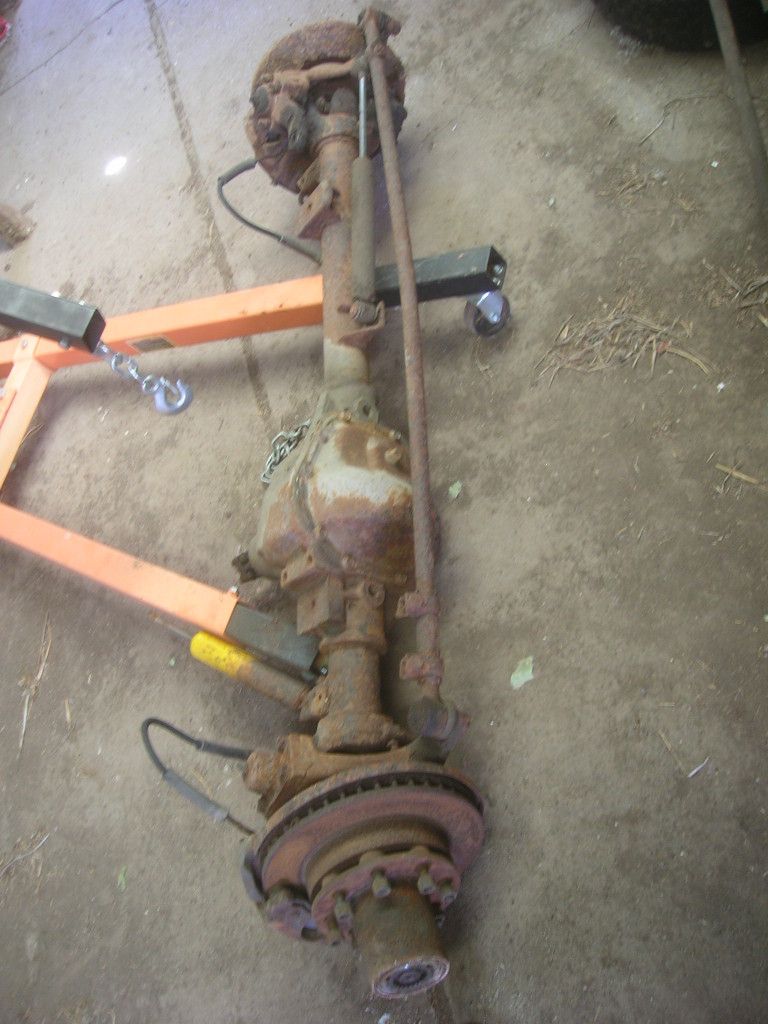

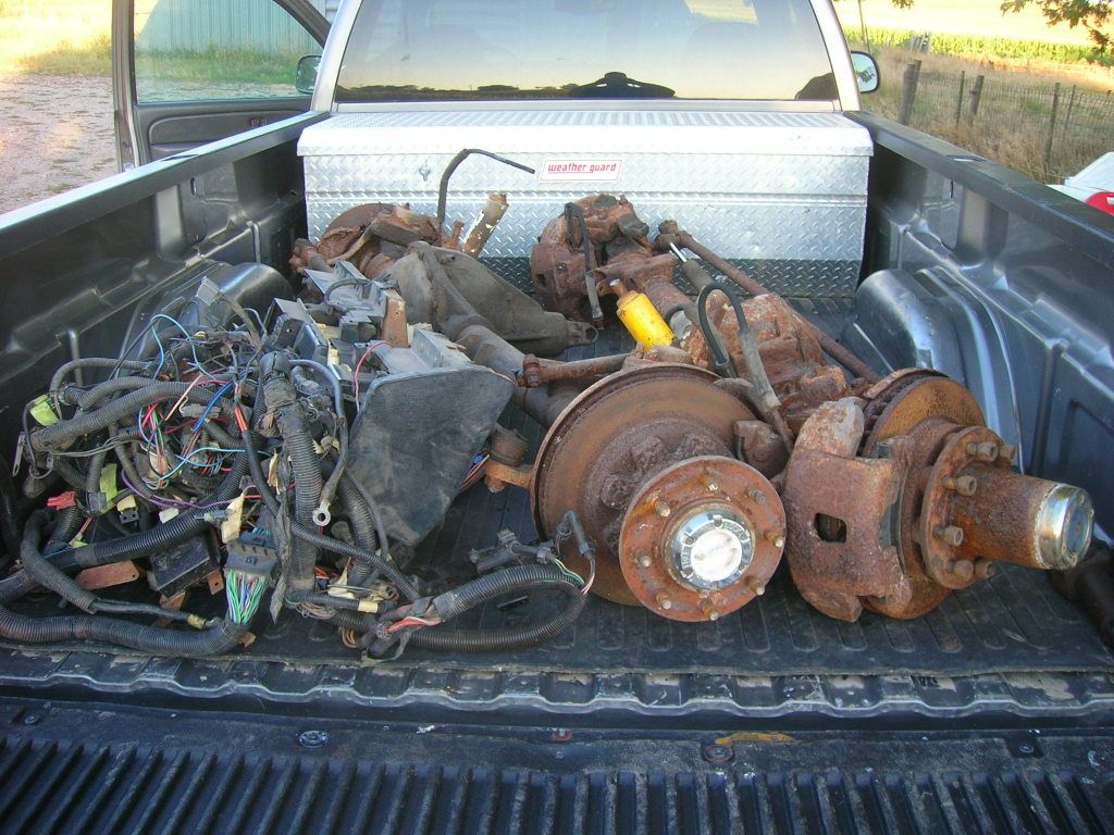

Where my Dana 60 was sitting around 6 pm.
Loaded it up in a pickup box trailer I need to take back tomorrow.

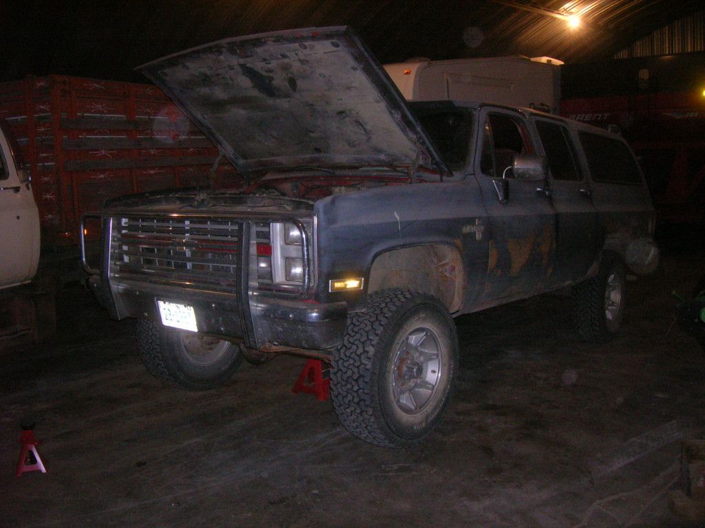

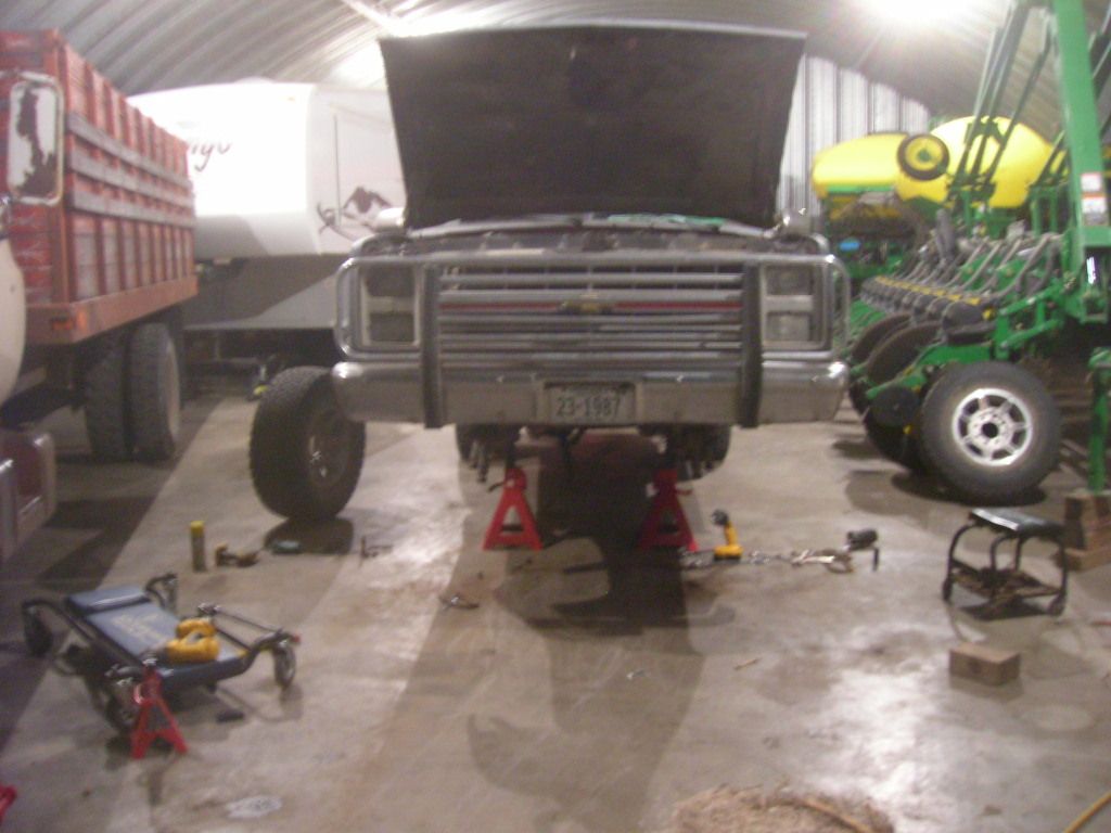

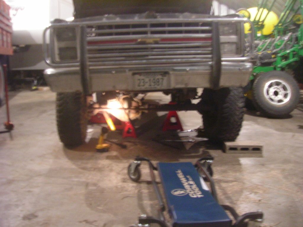

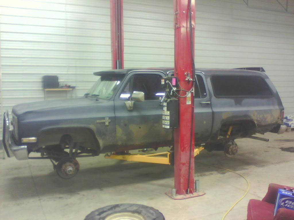

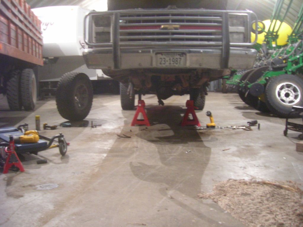

Backed the Suburban in the quonset, jacked it up, and started the disassembly.

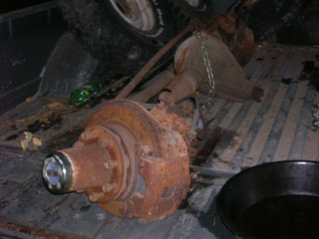

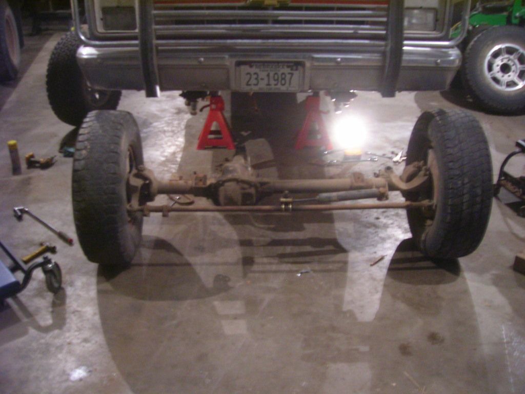

Dana 44 out.

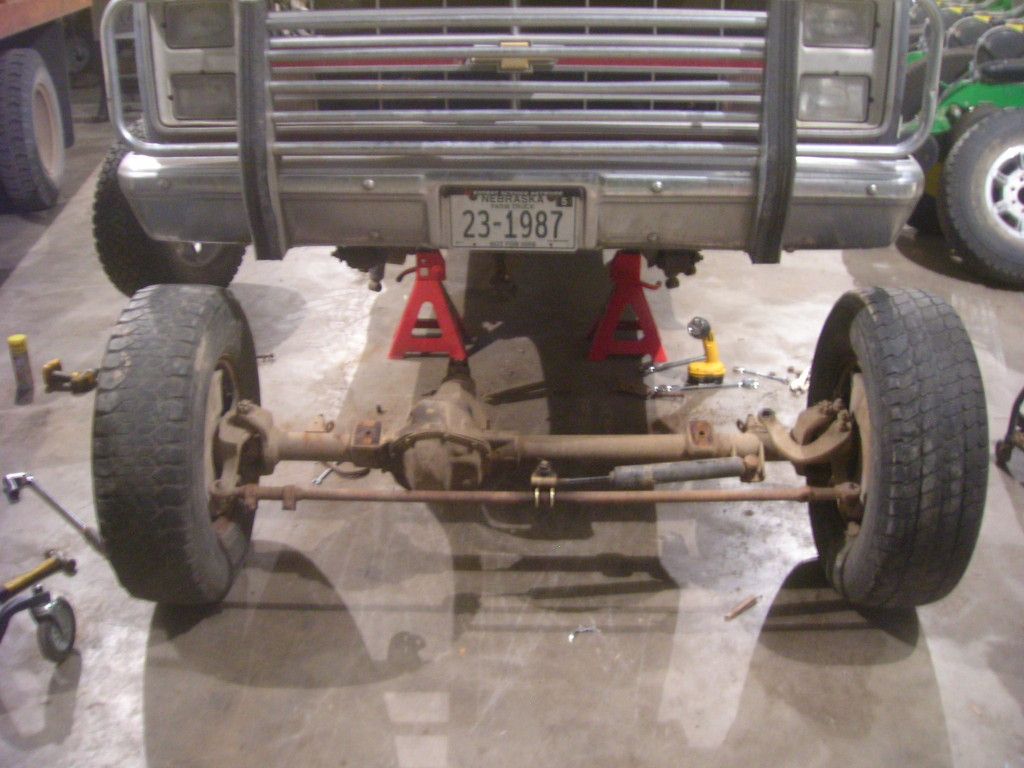

Dana 60 in, then the tired old hand me down camera died.
