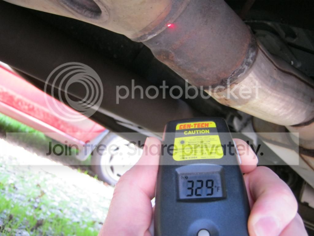

6. Thermometer – a properly running catalytic converterwill have an operating temperature of roughly 300-500* at the inlet welds. The media will heat the exhaust gases another ~150* by the rear welds. Use an infrared thermometer to take the temperature of the cat at both the front and rear welds (not on the heat shield).
Temp at the inlet is 329*, so that is within range.
Temp at the outlet is quite a lot cooler. Worse, the outlet temp varies widely from a low of 240* to a high of nearly 450*. The outlet temp is well out of range and highly erratic. This is a bad cat.
