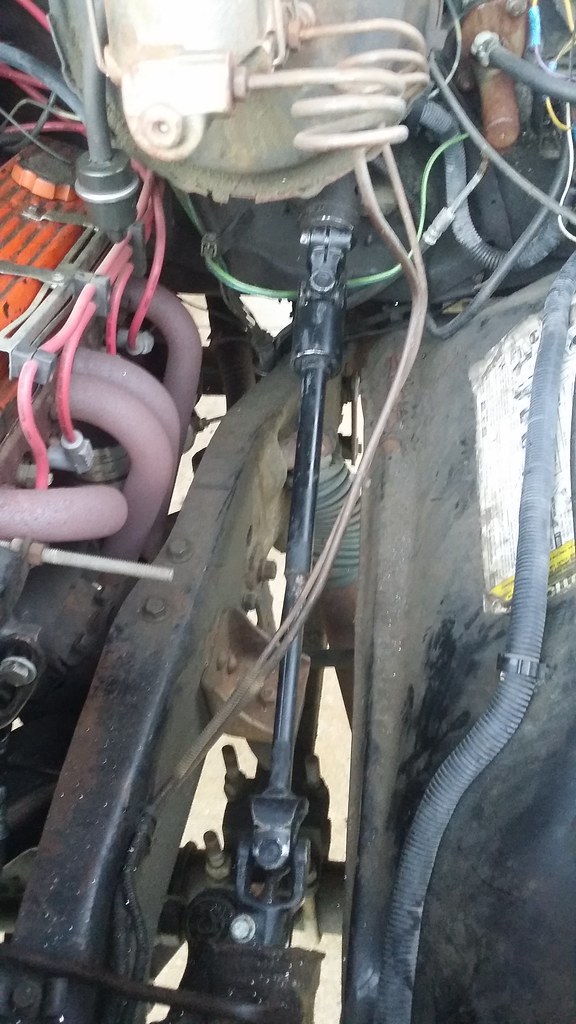

XJ shaft on the right... brand new one at that. :(

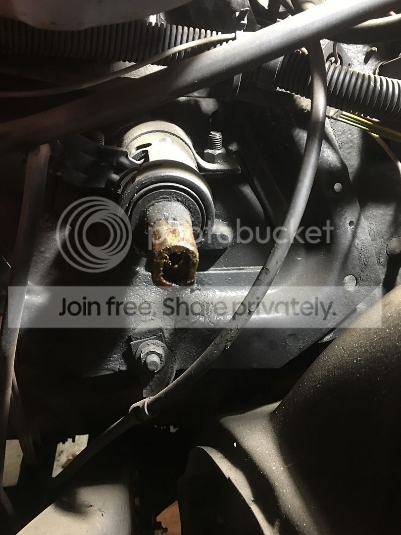

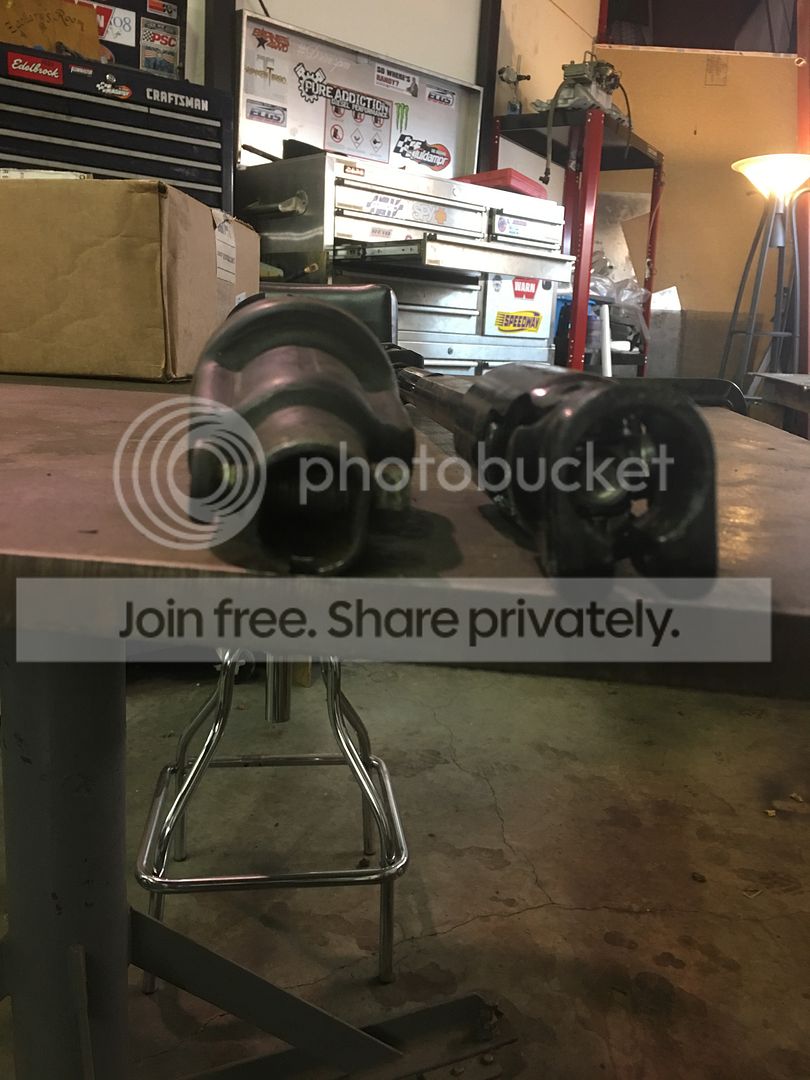

Just did this yesterday on my truck after doing a friends k5 over a year ago, I used a pick n pull shaft in good shape. I didn't need to heat the shaft or any of that nonsense, just stuck it in the press and slid it together 1/2" which allowed it to move freely with light tapping keeping the factory plastic rings intact when completed. If you don't have a press you could use a floor jack and your bumper, they really aren't that tight. My pressure gauge on my pump didn't even register enough force to move the needle when the shaft started moving.
