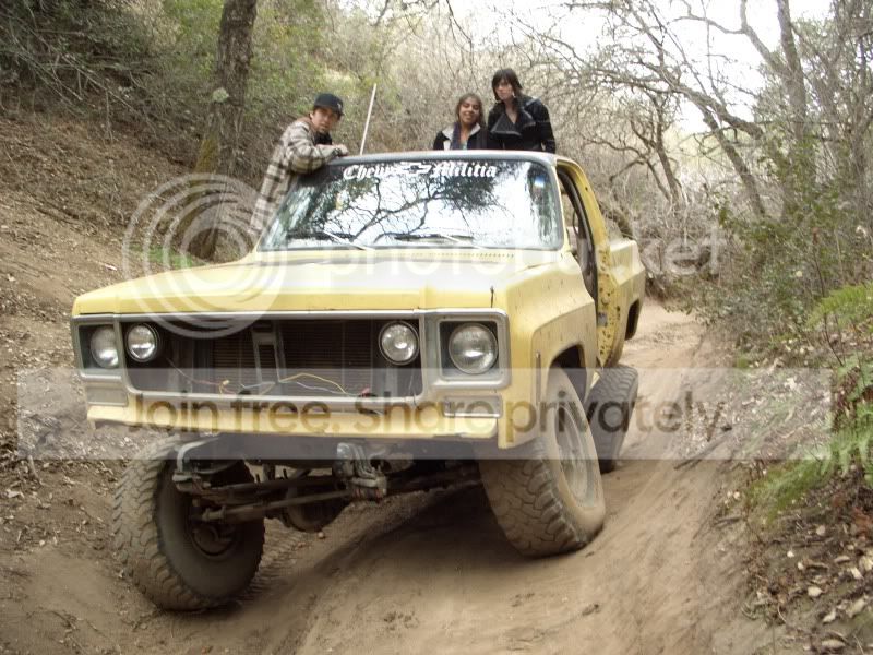

Ok so I've been driving it on the street and wheelin it and I'm totally happy with the 52"s, probably one of the best mods I've done so far. I drove it with only one shock for about 30 miles and I realized the shocks make a huge difference. It was pretty sketch without a shock, a LOT of body roll. There is body roll with the shocks but nothing too bad. The ride is much smoother, there is a huge difference sitting in the front seat and the back seat.
Offroad the springs are amazing. They flex great but I really need bumpstops (workin on it). The crossover steering is workin great too, I replaced the power steering pump and I can kinda steer at a stop now. I'm gonna do the pump mods and see what happens then.

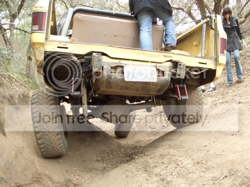

Allright so i finsihed the 64"s swap awhile ago. Works great, rides like a caddy and flexes like crazy offorad. Doesn't handle too bad on the street either, I got used to it. I moved the DIY4x flip so the fornt holes line up with the rear holes for the the stock hanger (its not flipped around). I moved the front hanger so it lined up with the 4 rivets for the body mount (its differnet on other years- 78 and up i think are differnet). Axle is in the stock location and the the shackle angle is perfect. mORE PICS coming soon
Flopped the truck on its side into the wall right afterwards

I hate to be a downer - but you guys are gonna kill or maim somebody wheeling with people hanging out of your truck all over the place. What if somebody slipped and had an arm, leg, or head between your truck and the wall in that last pic?
It is not worth the risk.
