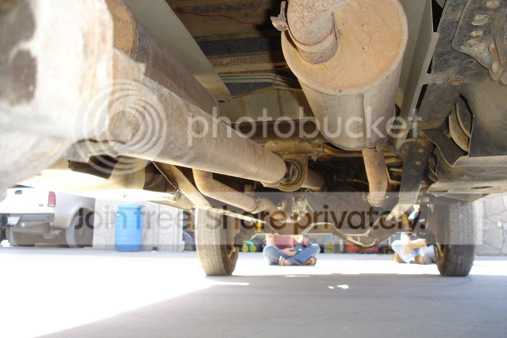

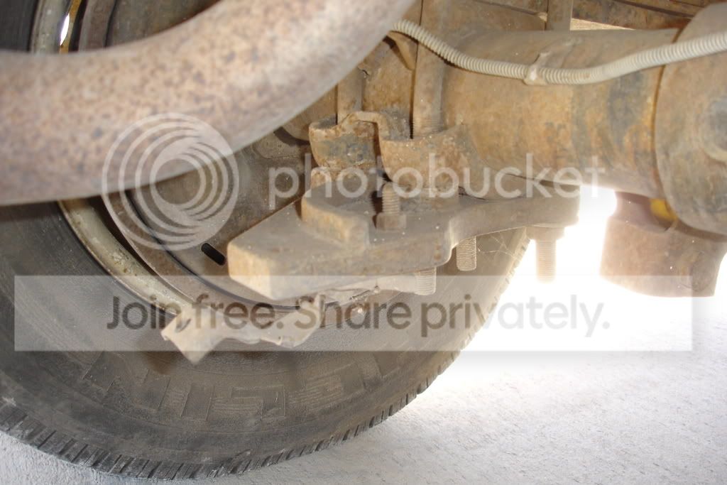

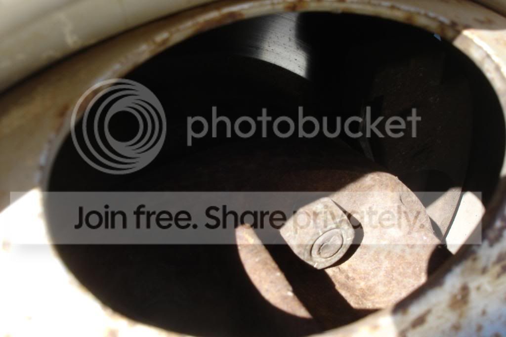

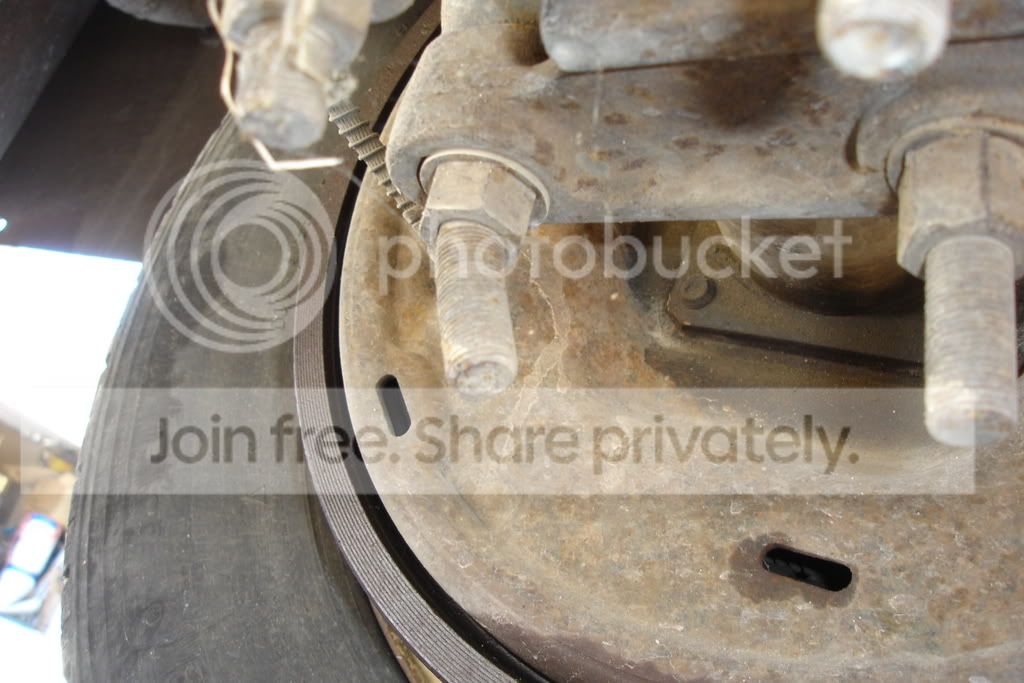

first, is this a drw hub for the 60 or just some aftermarket spacer? i thought the drw hubs had 8 little ears all over it. this truck started life as an srw truck.

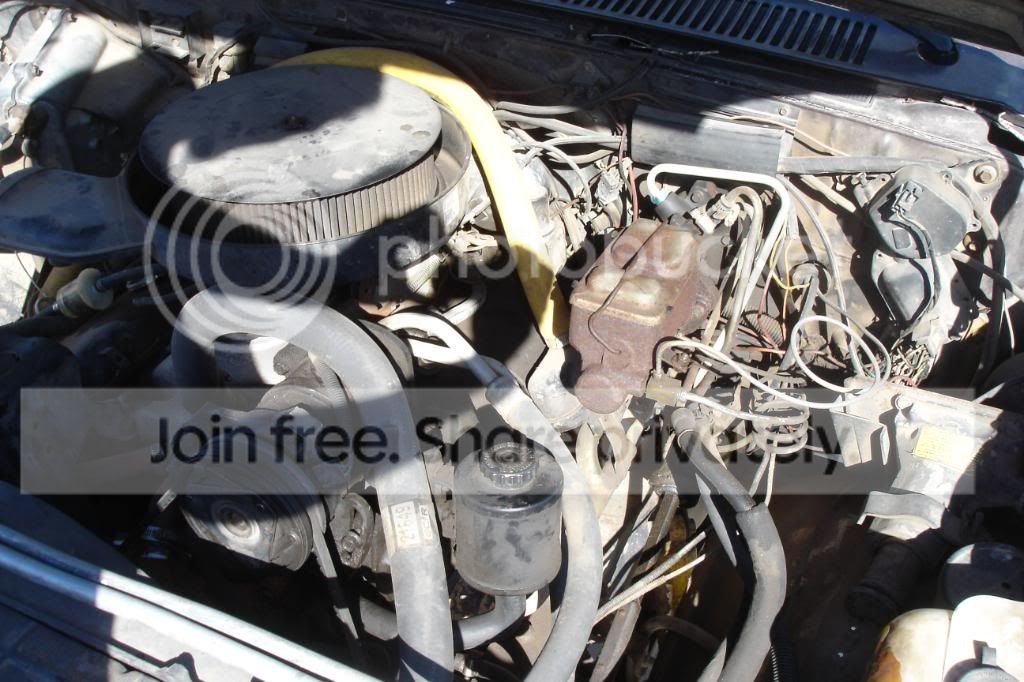

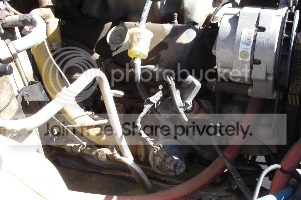

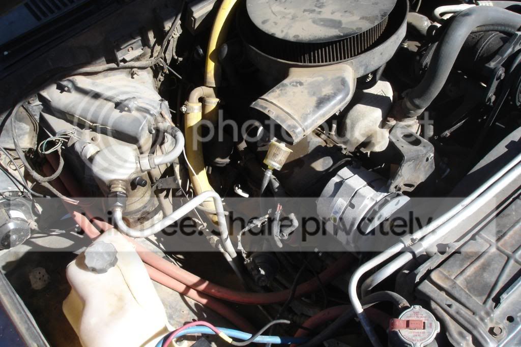

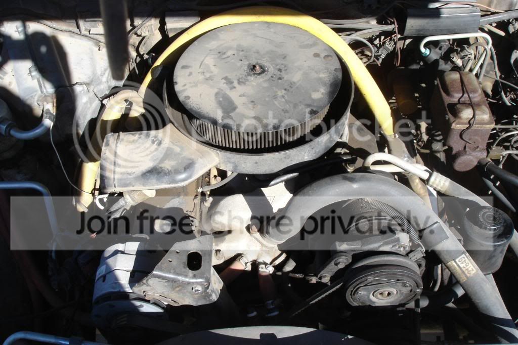

what the hell is all this emissions crap? its an 86 and it has a serp style and vbelt setup? id like to eliminate all of it and get an older qjet and some nice headers eventually, will losing all that crap make me have to get new pulleys and accessories?

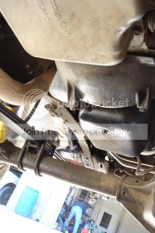

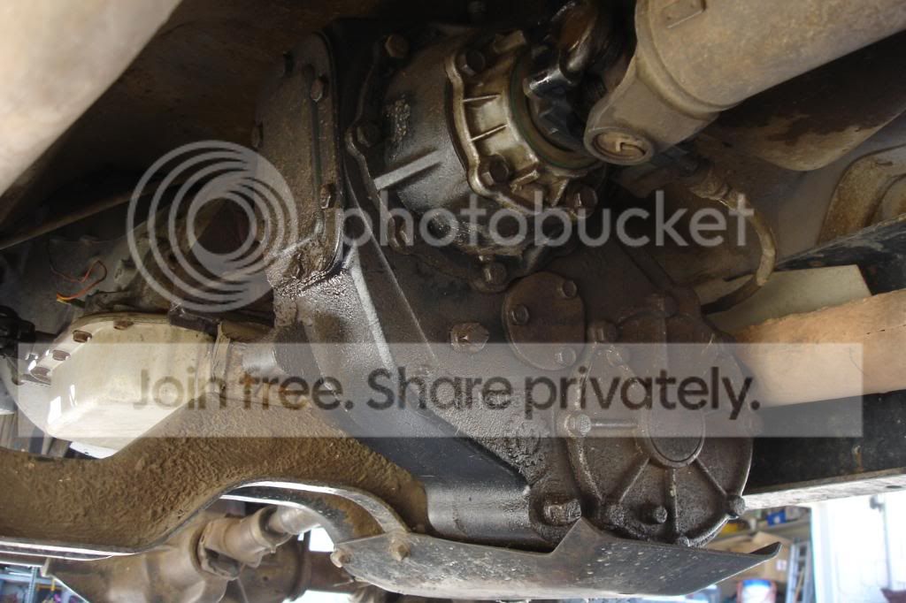

then heres the tcase trans and motor pans:

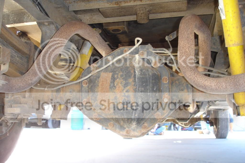

then heres the 14 bolt

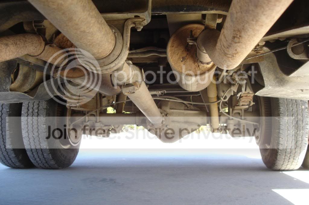

wierd ass swaybar brackets?
nice bent upside down ubolts

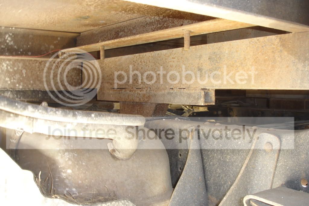

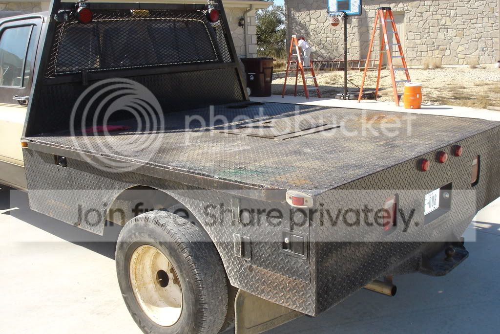

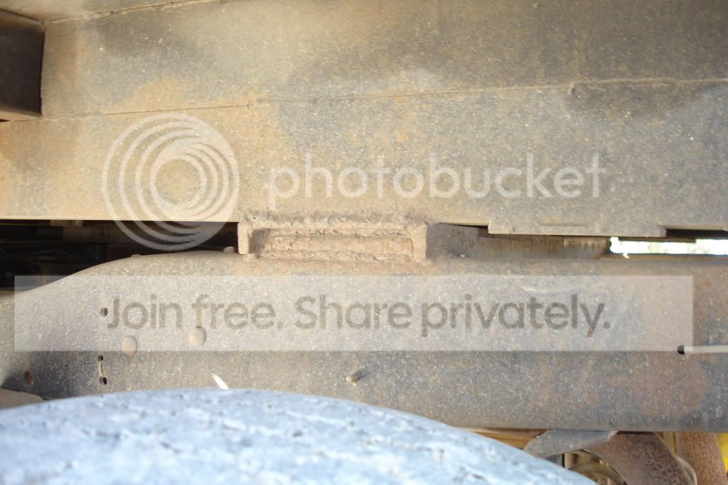

heres a really cool flatbed but its welded to the frame as is the big ass front bumper. i planned on putting a srw bed on it but that popped the bubble right there. lots of work getting that off the frame. also they cut the rear frame horns about 6 inches after the shackle hangers.

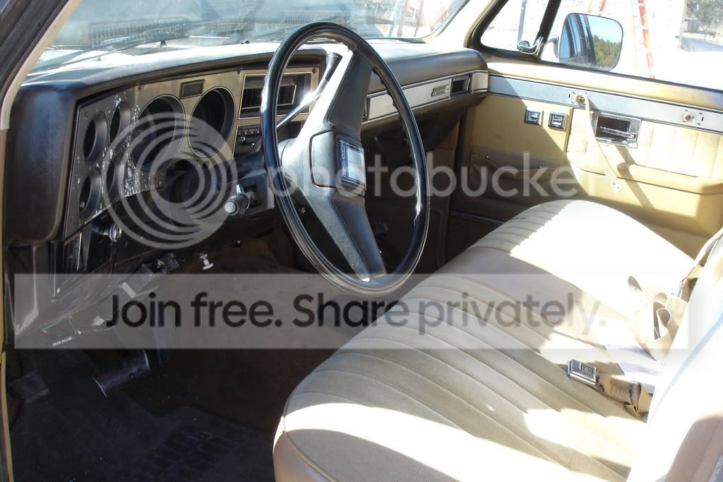

and heres the inside which is pretty nice, ac blows ice cold! its been parked in a barn for a while when hes not using it. lots of free mud daubers everywhere.

It's hard to see much from that pic, but it looks like spacers on the front to me. I could be wrong though. If it runs and drives well, I'd be willing to spend the asking price on it.
On a side note, the rear u-bolt and shock mount setup looks identical to the 1ton 2WD 14bolt that I pulled today, save for those lower beefy looking brackets.
looks like tires are spaced apart, somehow....1st pic shows hub sticking thru the rim 1-1 1/2''..not much, but idk much about drw's
whats up w/people sittin indian style in front of truck w/you snapping pics?
I believe that's his GF...

Don't be afraid of the bed removal either... a torch or air-arc could have that off in a matter of minutes...

It's all about what you are either willing to do to either get a good condition SRW or fix all the issues with this thing. I look at it and see a lot of work and de-redneckifying before you can get down to actually building the truck you want. Welded on bumper and bed? Who the **** does that? Common...

even if you get it for 3k, how much money would you need to through at it to get it restored? It may just abut equal the amount people want for a running stock one. That welded bed looks hairy. Though my technical abilities are limited and im not sure of yours. It does look like alot of work.

i dont want to restore it really, just offroad it and work it. it would take near 10-12 grand to get it really really nice. i like the fact it is a little beat up so i wont feel so bad when i put the dents in it. my k5 has dents only on one side. thats the ugly side lol. the inside will be nice though for the old lady. that would be like 500 bucks for new interior pieces and stuff. less if i am frugal and get stuff locally. the bed doesnt look like too much of a project. a good weekend and a few die grinder wheels i can have a new bed on it. i estimated im going to drop about 500 on general maintenence i want to get done. more preventative than anything.
