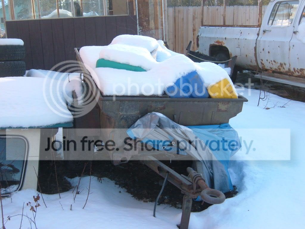

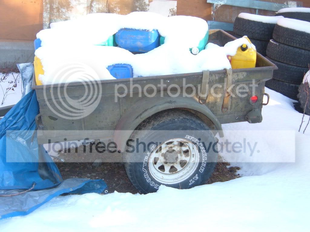

how many use a trailer off road for long trips? it is looking like we will need to bring a trailer with us this year for our 8 day trip for hauling gas etc.i have one of the smaller military trailers that we will be doing a soa and a set of 35s to get the axle up out of the ruts.was wanting to see how you have yours set up etc. it will be towed by my jimmy on 44s or a friends blazer on 42s.
thanks
heres the trailer i am are starting with.it does have a box built to fit in side it.will get a pic of it later.
