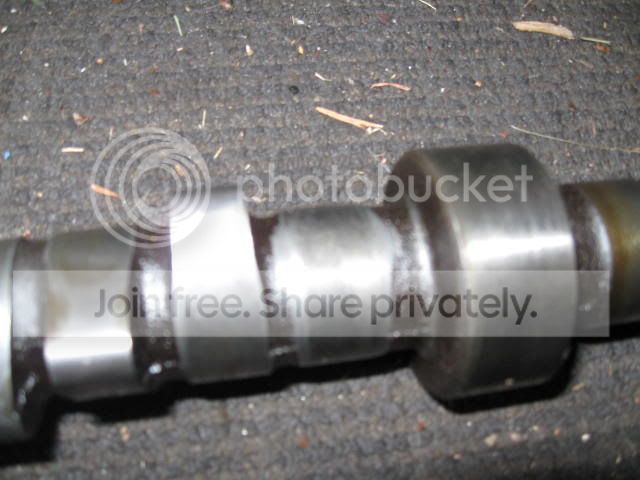

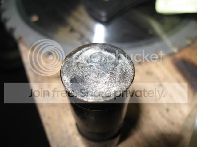

My #4 intake (IIRC) is groved or worn pretty good, should I buy a cam/lift kit or say screw it for a while? Or might as well since I have most of it apart already. Oh and a good ammount of the lifters have little knicks here and there on the outside ring edge.

Ya need a cam and lifter set my friend.
Change oil and filter as you would, and put a big ass magnet on new oil filter and change it to try and get as much metal out after its ran a bit
Edit, even after breaking in new cam run a magnet on oil filter after break-in oil and filter change

Right now you are killing your engine. Every revolution is putting more iron into your engine which is killing the bearings and piston skirts. I had a engine kill 3 cylinders in under 500 miles like that. Time to get at least a cam and lifters.

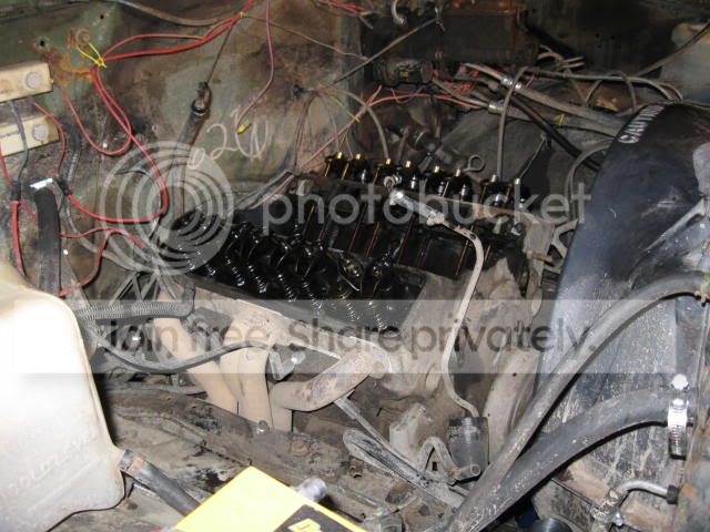

So got the lifters and cam out this morning, it was #2 intake that the picture was taken, there's no lobe left on the cam for that one. Another was bad too, just not as bad. Had some metal 'strings' shavings on the cam when I pulled it out. I'm also dropping the pan, and cleaning that out, and pulling the oil strainer, cleaning it as well. There was a bunch of RTV coiled around the pushrods, I bet a chunk plugged a pushrod. Two owners ago, my buddy loved his RTV to say the least.

#2 intake, completely worn down, there was another lobe worn fairly low too, but not as bad.
