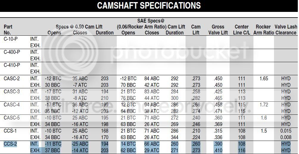

The Lunati cams you listed are there bare-bones line, which is the less expensive version of the voodoo series. Not sure on their performance, but I can say the Voodoos are fantastic. THe voodoo kits with lifters are about 184.

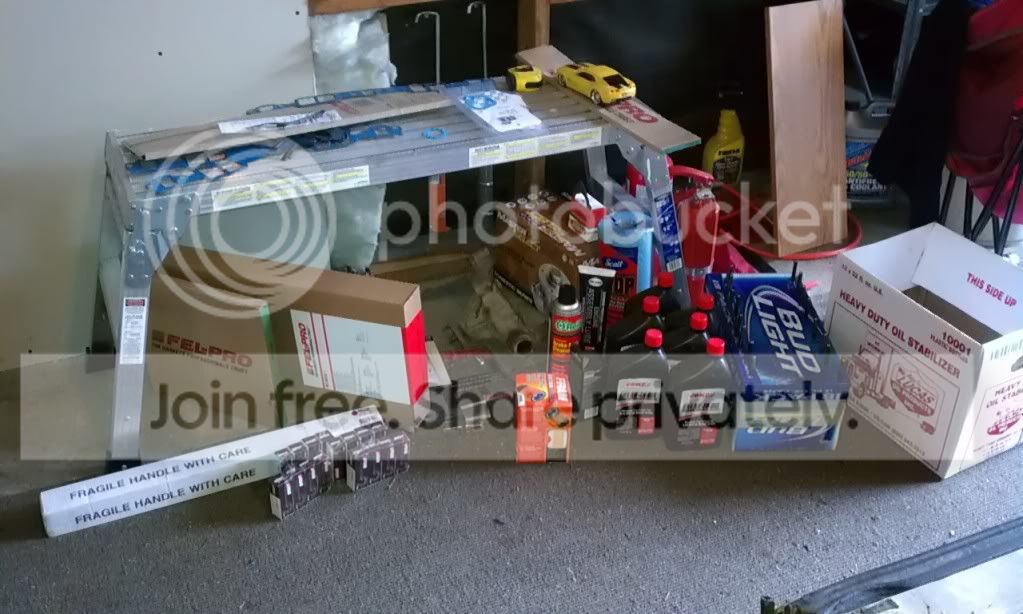

I was curious how the model Camaro gets used as a tool in the garage?
Martin
I was gonna say you got the most important part, but then I realized it's just an empty box for the push rods.:doah:
It gets emptied and put in the cooler so I don't have to go back in the house as I'm working. :waytogo: Been wanting to get a mini fridge, but this stupid house has one 15amp breaker for the entire garage, porch lights, the back bedroom, and the lights in the laundry room. :dunno: Its hell running the air compressor, I gotta turn everything off.
Martin
One of the kids brought it in there, I think it's taking up valuable junk I never put away room. :rolleyes:

To ask about vacuum issues with my new cam, here are the specs.
4bbl Quadrajet.
sbc 350
33" tires
TH400
