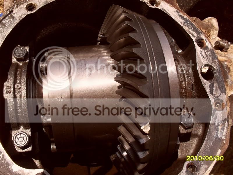

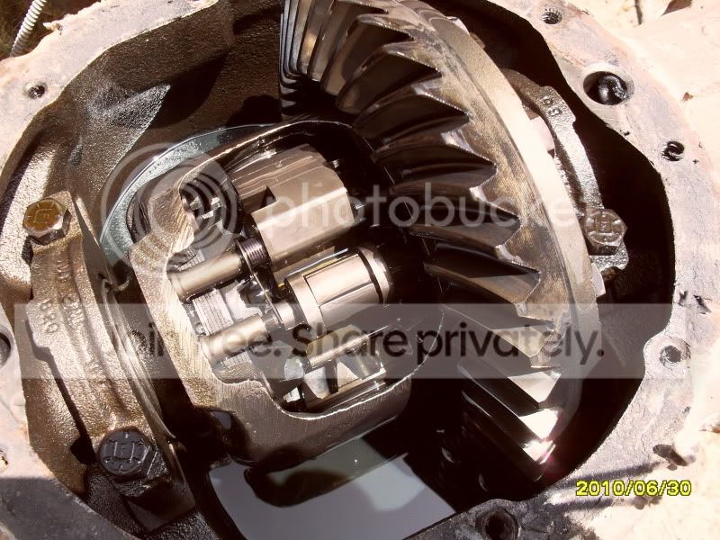

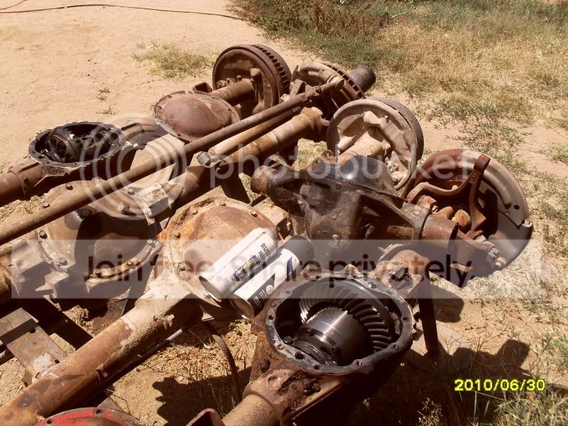

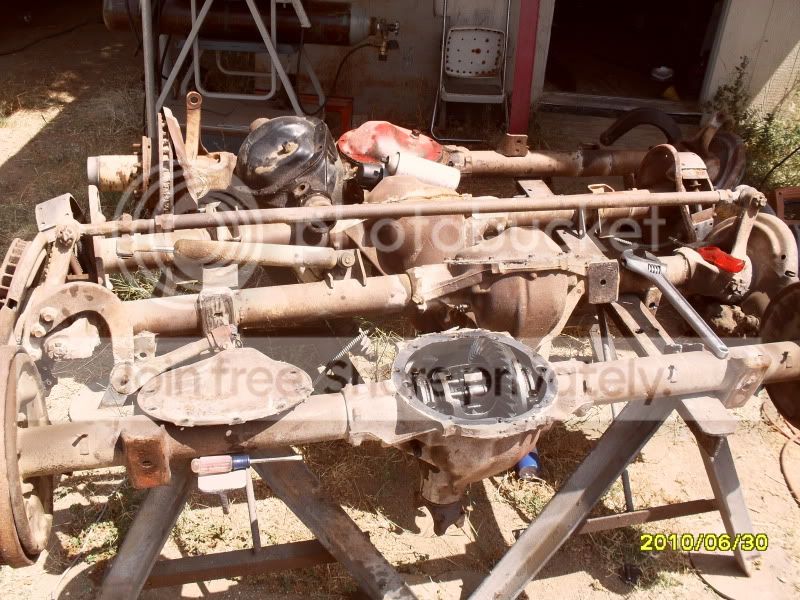

anyone got an email i can send the pics to so you can either post them up here or ID the lockers in them?
yea thats why I thought it was bogus or odd at first....but when he said the trucks where lifted with Pro comp shocks, bad ass roll cages, etc, painted blue....and the other member on here said the base, when I asked the guy what base he named the same one...so it makes sense these were modded...now I just want to see if someone can ID what kind of lockers/LS are in them.....and if its worth to get them even though they wont be as strong as 14 bolt....but if the price was right its 4.10 gears i need bad...
ya no kidding i want some 4.10s! Rears are def gov bombs.

Thats not good then.....front and rear govt bombs? ugh....I was hoping they were some other full locker (not that Id want a full locker up front), so they might last a little bit compared to a govt bomb....Ive grenaded two of them bastards in my fist K5...granted I was heavy footed hard core mud stomping every weekend beating it....but two rear ends in 2 years of high school ugh....I finally went to a 12 bolt and never blew it, not sure if it had the govt bomb or not....
So probably not a good idea to get these things?

the front looks like a detroit.
i say get em' and swap an open carrier into the rear with a lockrite.
Front definitely is a full case locker, likely Detroit. Grab em both, swap the Detroit in the rear, find an open carrier for the front.
Gotta look closer, but for now I'm not seeing any ratio numbers.

It is a guess without seeing some pic's of it rotated.
10 bolt Detroit for comparison sake...

So buy these? I'm intrigued now.
Ft Irwin is where the Army does the OPFOR training. Guys pretending to be our enemies and using their weaponry and equipment along with our stuff modified to act and look like theirs. Might be they needed some more capable rigs to drive around in and built up some M1009's.
I know I've seen a few M1009's done up with plywood "armor" to look like some kind of armored truck come out of there on GovLiquidation.
Definitely check the gears though.
