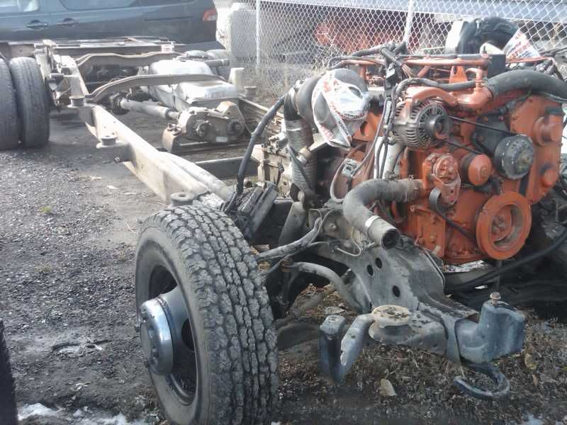

thats exactly whats in my '97 crewcab. exactly too the Tee!
'95 12v cummins
'98 dodge 2wd nv4500
'70s ford divorced np205.
heres a couple without the body on it.
