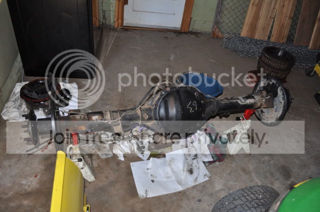

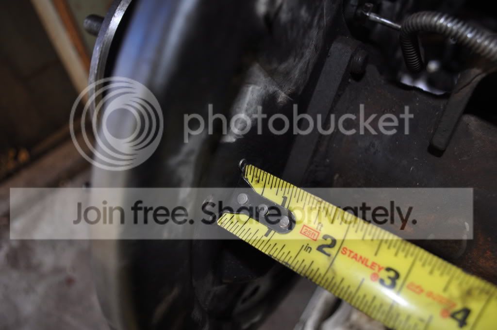

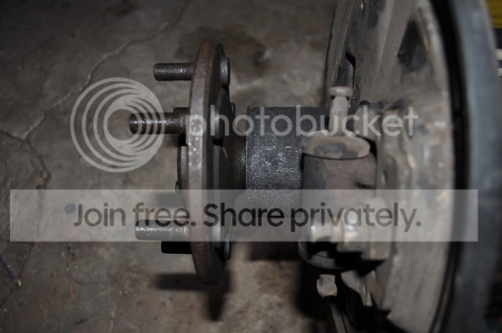

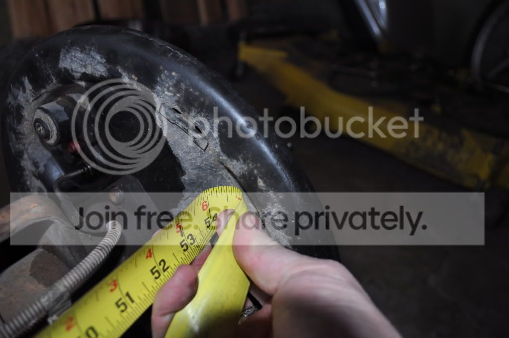

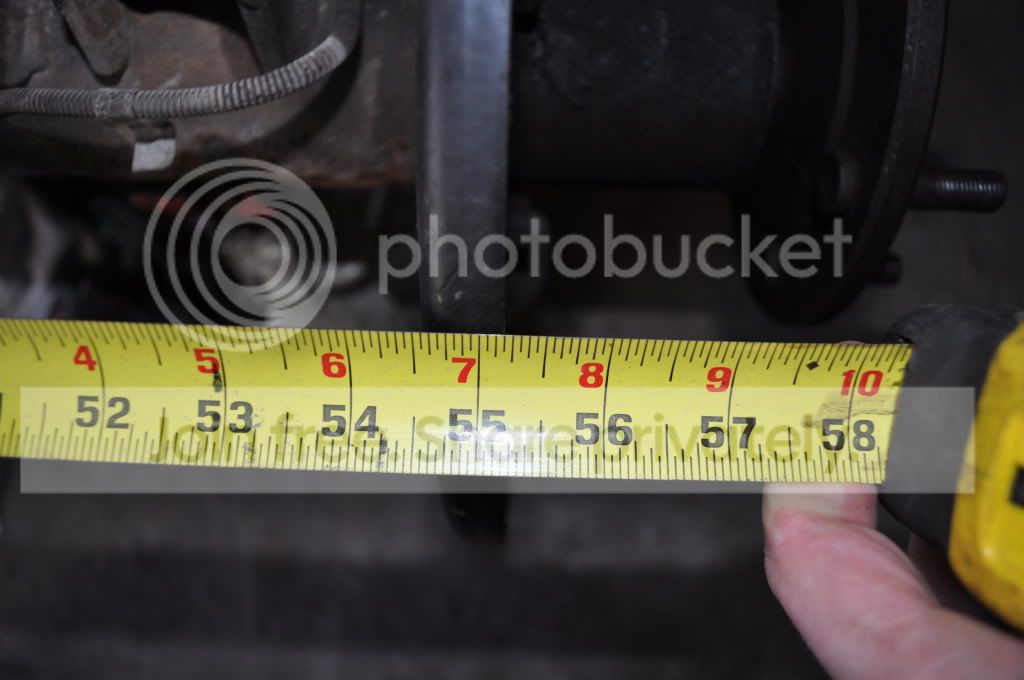

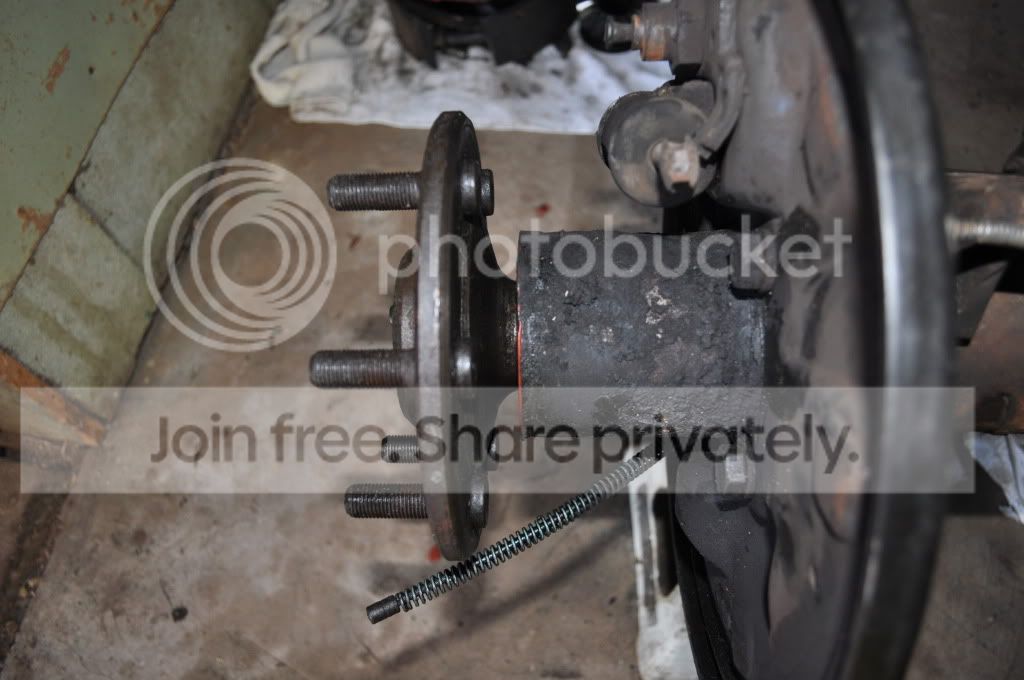

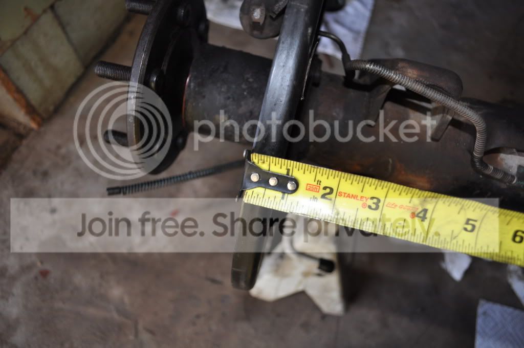

Here is what I have....
hub face surface to hub face surface:
Does it help if I take any measurements from mine? It was an 8-lug that I converted to 6. I can't help much with the alignment of the drums since I'm running disc.
