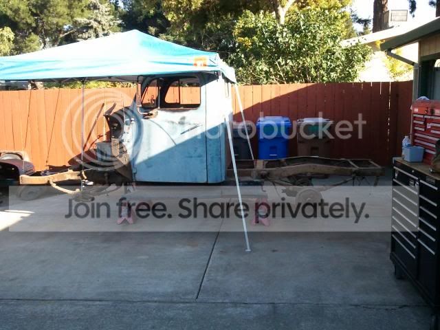

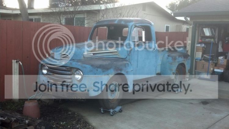

so plans have taken a complete 180 with this project when my dad found a nearly complete '48 Ford F1 for sale in the local paper for $800obo.
but really plans began changing well before this when I sold the front Dana 60 axle to my buddy to help him along with his 1st generation pickup build.
once that happened I kinda gave up on finding another front 60 for as cheap as I had found that one and really didn't want to go 3/4 ton front especially with 42's
I ended up selling the 42's and the np205 case i had planned on using, then scrapped the 'Yota frame and flatbed thing that was on it.
however, i do still have the cab but am not sure what to do with it at this point because as mentioned above my dad and I went halves on the near complete '48 after talking the deal down to $650
so plans for this build are now to be a daily driving rat-roddish 2wd pickup with a 351W and C6 auto.
We're going to add power steering but really keep this project budget minded and keep all leaf spring suspension, just a bit lower than stock.

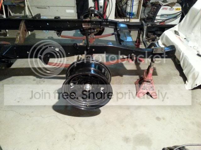

oh yeah we're probably going to keep the stock front I-beam but they make some drop leaf springs, I think 3" all around, for a good stance and front disc conversion will definitely be added, I don't trust those front drums as far as i could throw them

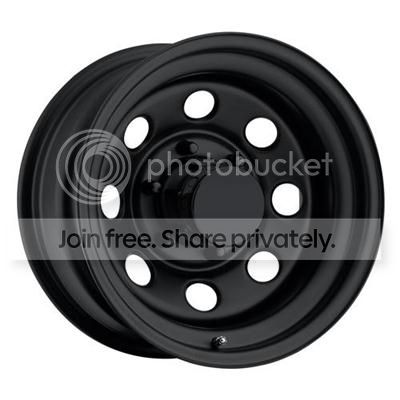

for wheels I'm thinking either plain flat or gloss black steel "round hole" style in a staggered fitment like 15x8 fronts and 15x10 rears
like these
I could see it. Staying with old school tall and skinnies or modern wider tires?

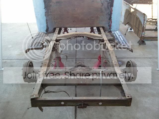

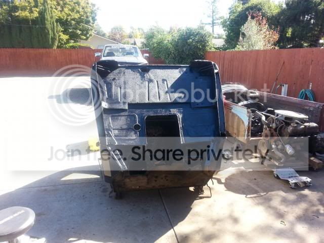

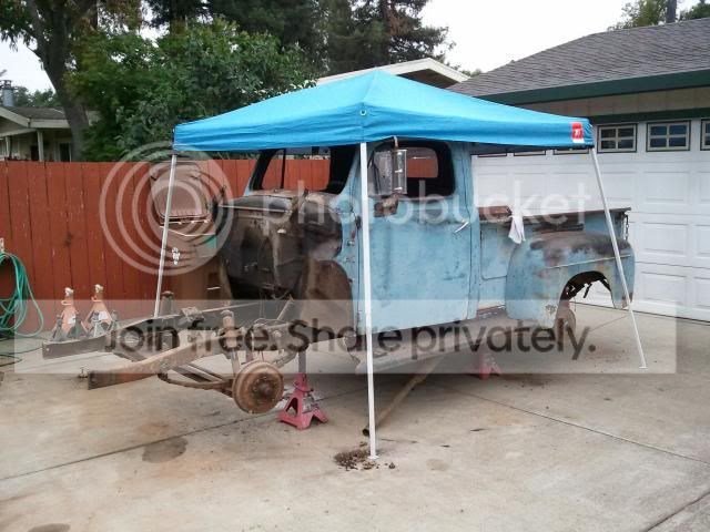

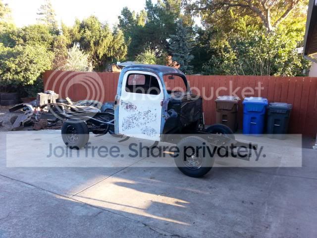

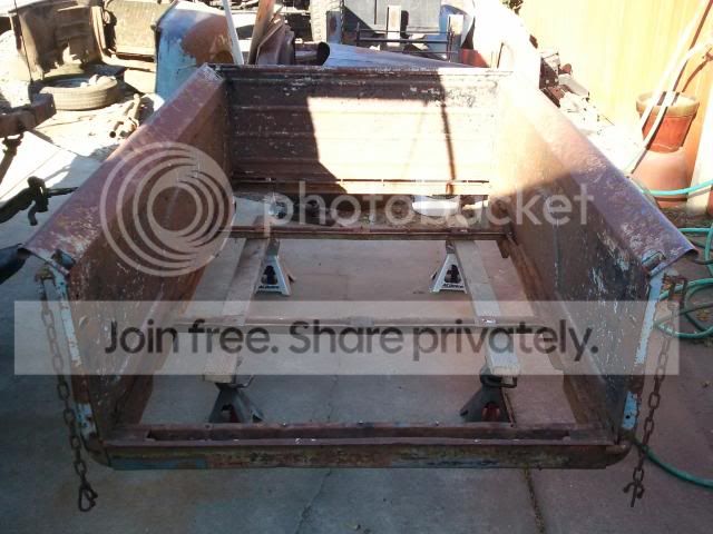

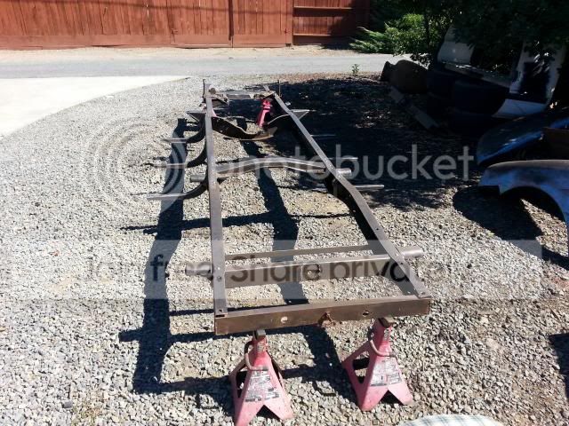

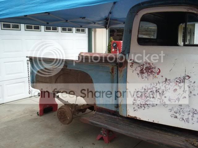

so began disassembling the Ford this weekend and got the front clip, old motor/tranny, and bed pulled off

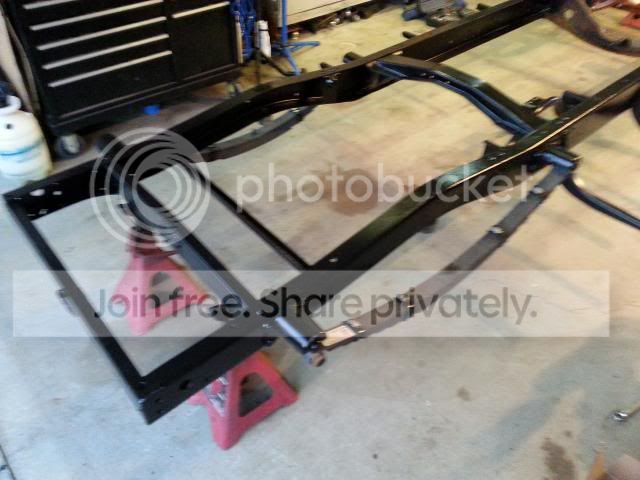

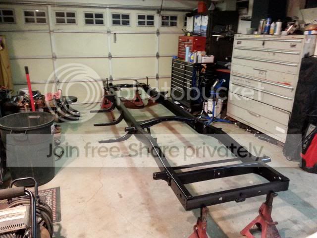

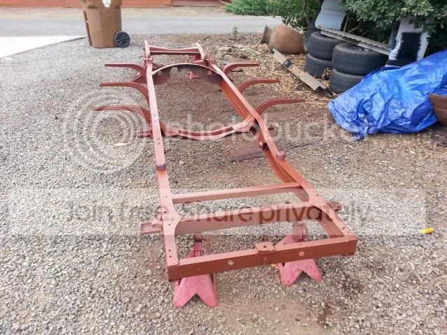

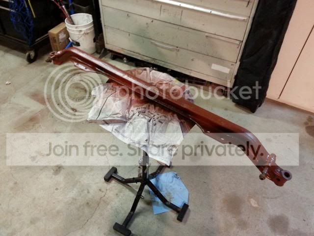

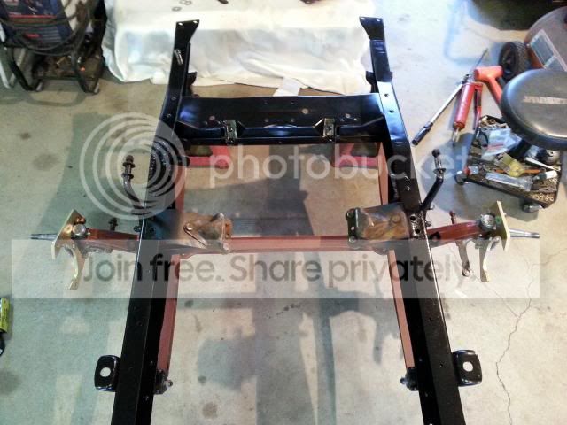

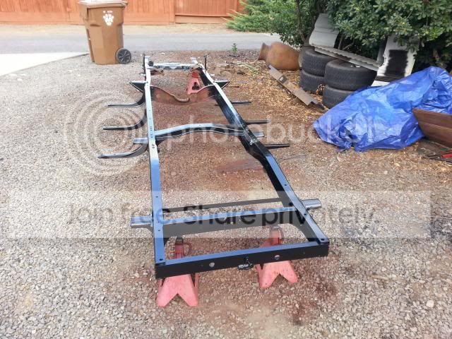

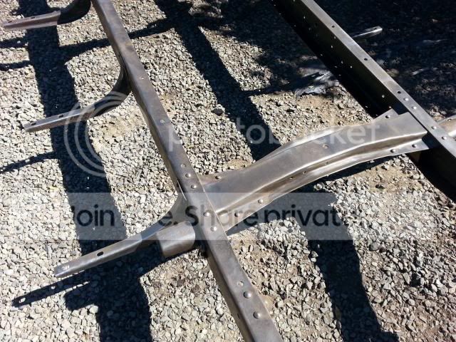

so i've been busy working on the truck and have gotten the frame stripped down, cleaned, and painted and have been collecting parts here and there slowly.
the springs are 3" lowering
a couple more things going on , found some wheels, 15x7s got all 5 for $100 and they're in good shape

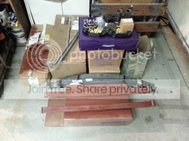

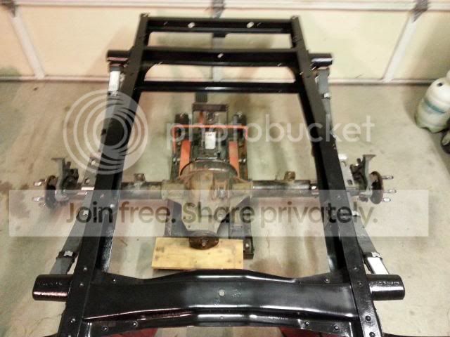

and got the rear Ford 8.8 mocked up found this at the pick-n-pull on a half off day it has 4.10s, posi, and disc brakes
spring perches for the swap are from Ruff Stuff they have narrow perches and u bolt plates for older jeeps but works perfectly for the old Ford as well

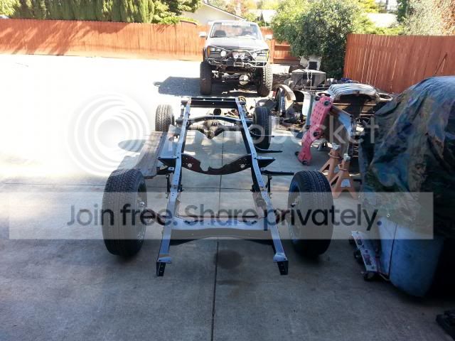

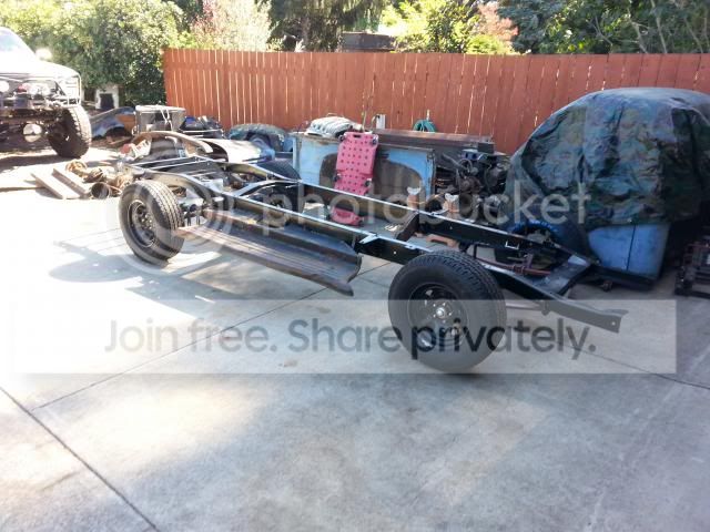

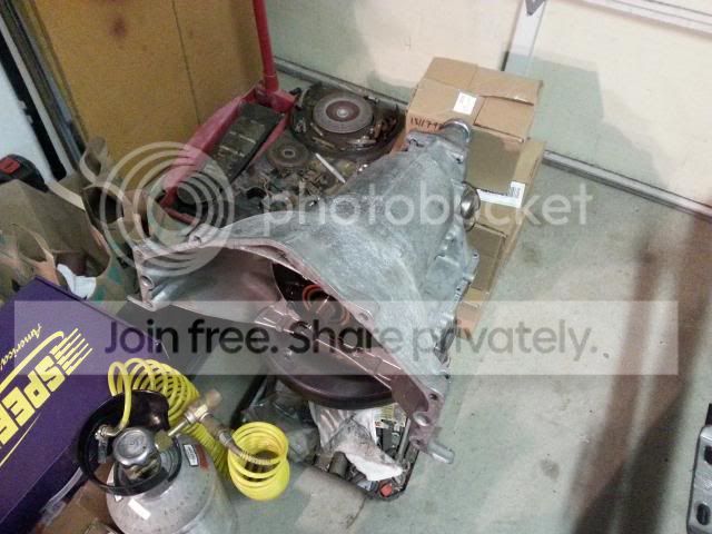

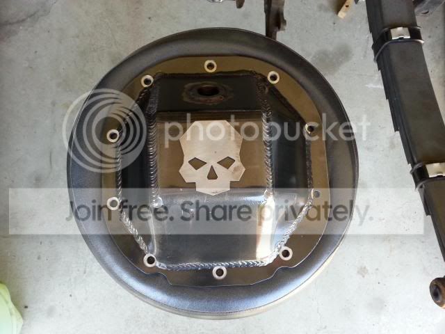

I found a rebuilt th350 to use and also clearcoated the Ballistic Fab diff cover I'll be using for the rear axle
Also got some tires

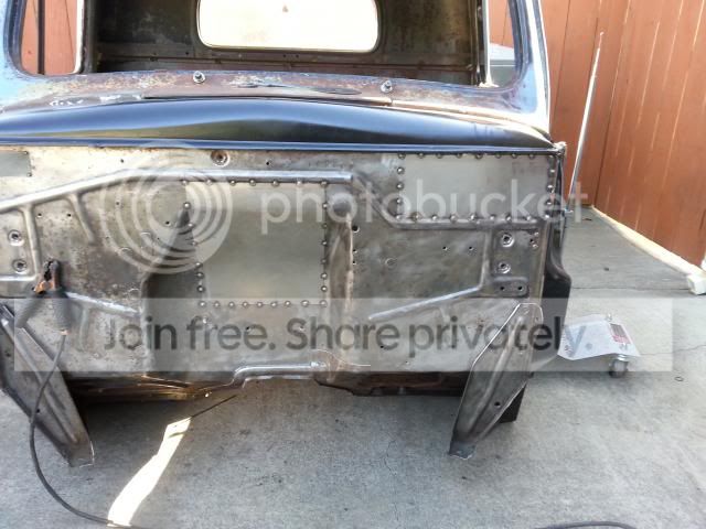

with the firewall i wire wheeled it and welded some sheetmetal sections over areas that had a bunch of random holes put in over the years then clear coated it

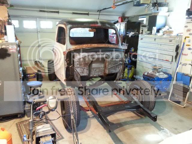

cab is mounted
and still fits in the garage

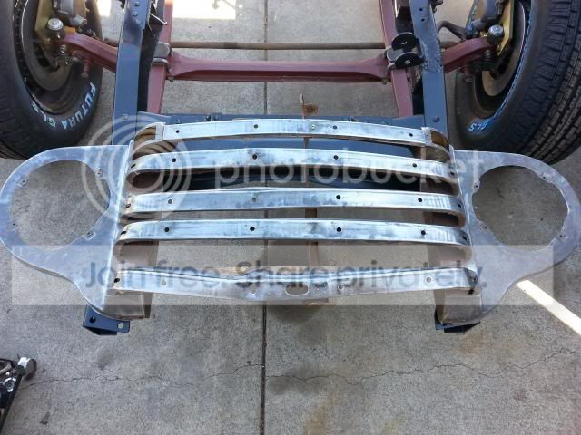

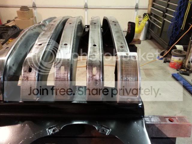

i did the same thing with the grill as the firewall except painted the areas between and im leaving the original aluminum trim off because i like the way the holes and the bare steel looks

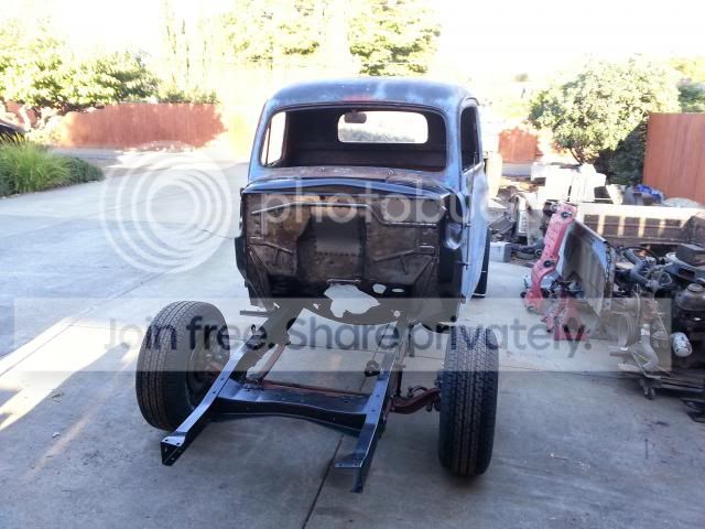

made some progress over the weekend

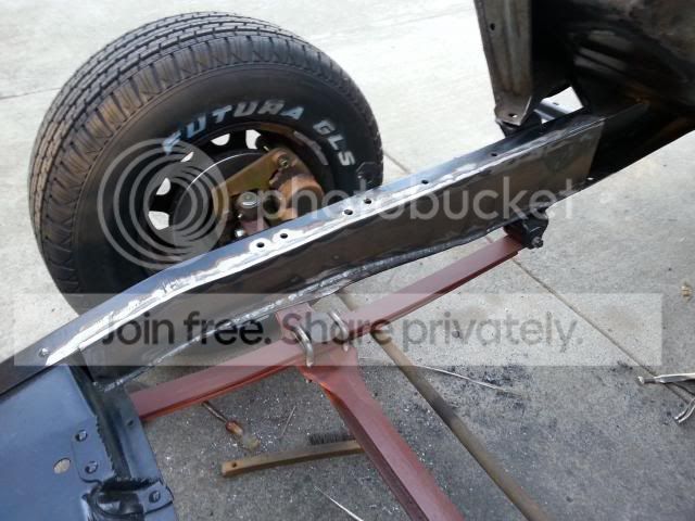

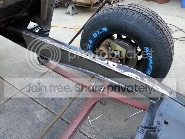

boxed the front portion of the frame and got the motor and transmission mounts all mocked up, will finish up next weekend
