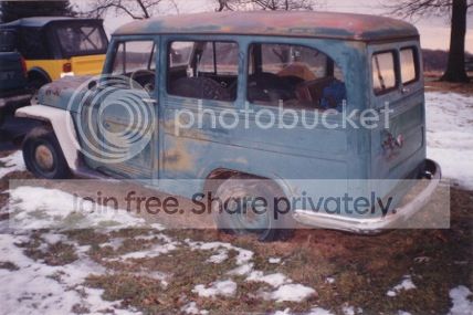

Found some old pics :D
this was the 53 when dad bought it

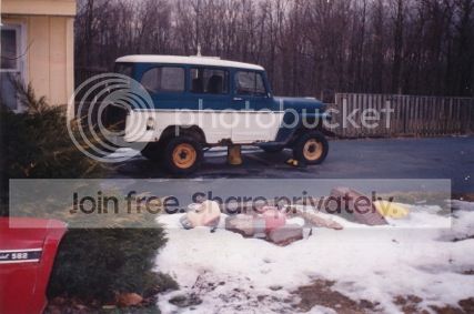

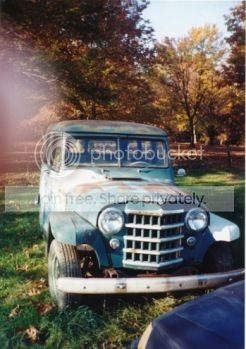

Found some
And one of the 62
This is the 53 body, the front floors were pretty bad and the trans tunnel and firewall were not going to work with the new drivetrain, sooo...........

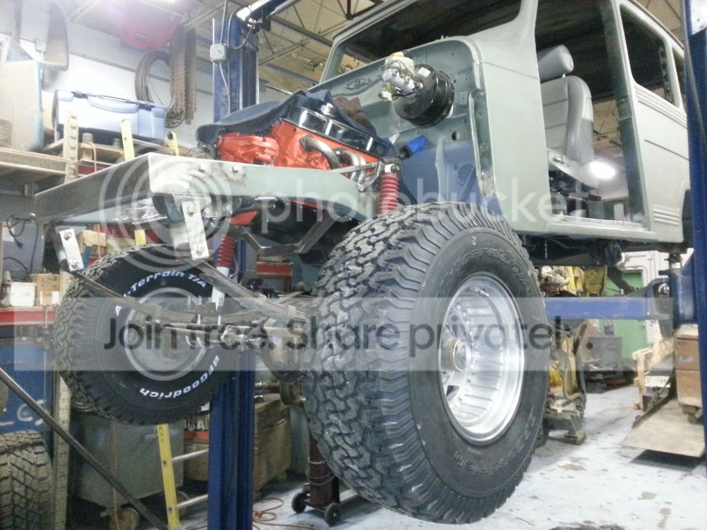

reman 350 engine approx 8k on rebuild, rebuilt 700 trans, pass side drop np241, TBI injection, speedway block bugger shorties, custom mounts
1989 wagoneer Dana 44 front, 1993 Isuzu rodeo Dana 44 rear w/ disc's 4.10's, solid diff covers, front and rear completely rebuilt-completely
HD 6 leaf YJ front springs, stock XJ rear springs, spring over front and rear, cross over steering w/ GM 1 ton tre's
Power brake and pedals from 94ish XJ, wagooner steering box, 2 XJ steering shafts, summit racing tilt column, grant wood steering wheel, leather power Audi seats, wagoneer front sway bar, old school Centerline HT cast 15x10 wheels, 33x12.50 BFG AT's, AL's liner underside, frame stretched ~6" in front, boxed front half of frame, custom.......well.......everything :D

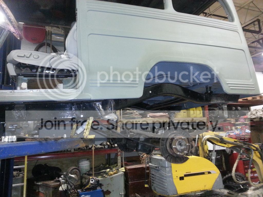

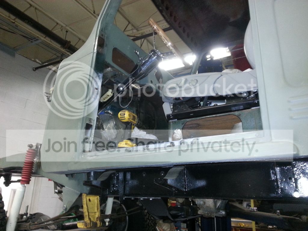

Hopefully I'll be pulling the body off the frame for the last time very soon, we will finish the chassis painting, a few things need to be finish welded, and I need to touch up the liner under the body where I missed a few places.

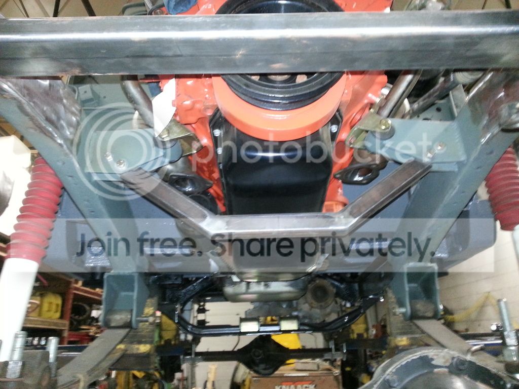

This project was a one step forward, three steps back for a while, but finally is moving forward. This is suspension and axle combo #3 now :doah:, but finally everyone is happy and it should ride and drive pretty darn good :D

A few more semi- current shots I had, these were before we finished the axle rebuilds last week :D

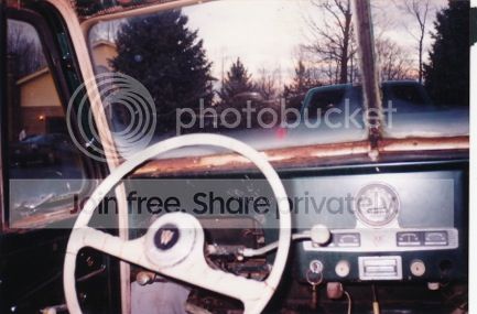

You can also see in this pic, I cut the center of the dash out and replaced it with the single large gauge setup from the 62 body.

No new pics today, but, I did make mounts for a front sway bar that worked out really nice and use the factory bar from my brothers Wagoneer. Also should have driveshafts by the end of the week :woot: and maybe some brake lines.
