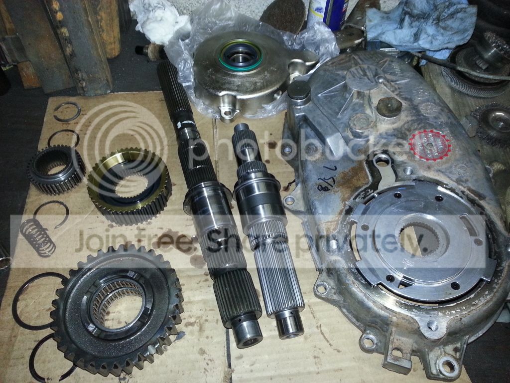

Also got a front drivshaft and ended up having to do a sye on the 241, it should be here this week. No new pics right now :(

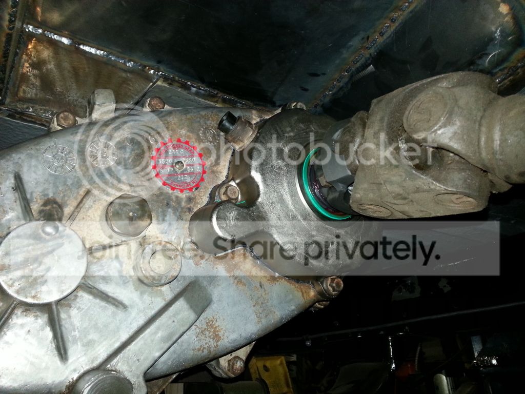

After some measuring it was determined there was no way the rear driveshaft was going to work due to length and angles :doah: so a quick call to JB conversions solved that :D
241 super short hd kit, I must say this install could not have been easier, even after I realized I forgot to put the snap ring back on the front output and had to take it apart, clean off the gasket goo and re install it all :doah: :haha:it still only took an hour total :pimp:
Ended up gaining 9"s of d shaft lengh which dropped about 14* out of the operating angle :waytogo:

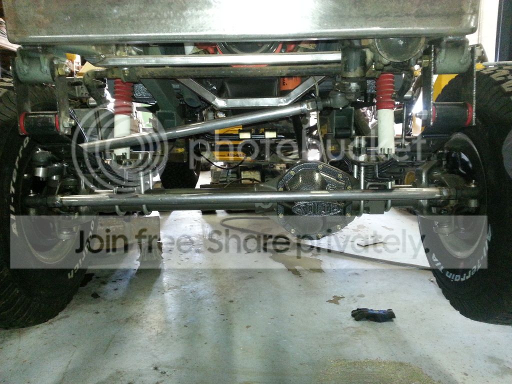

Crossover steering done :D
1.25" x .250 DOM, ruffstuff ends, Sky steering arm and GM TRE's. This is full droop , at ride height the drag link is within a degree of being parallel.

The front axel is a Dana 44 that was sourced from a 1989 Jeep Grand Wagoneer
Looks good! :waytogo:
What front axle is that? Are jeeps Driver side?
Like my brother said, it's originally from his Wagoneer, he now has a Dodge 60 in his. Although it's from a Jeep, it is a 6x5.5 bolt pattern, uses the regular GM rotors, pads and calipers but is drivers side drop, originally set up for spring under and about ~6"s narrower then a GM d44. IIRC WMS on this axle is around 60" or so........I think :doah: :D

what steering box does it have? I need to get rid of the POS Ross system on my Jeepster, and put a 30 in front w/ discs as well.
Im running the factory box from my brothers 89 wagoneer. It is a 4 bolt inside the frame setup and apparently has the same bolt pattern minus 1 as the mini round body blazers. My brother swapped in a box from one of those as the ratio is different :dunno: and thats what FSJ (fullsize jeep) guys do. It really looks just like our boxes, except it goes inside the frame and xj shafts bolt right up also.
