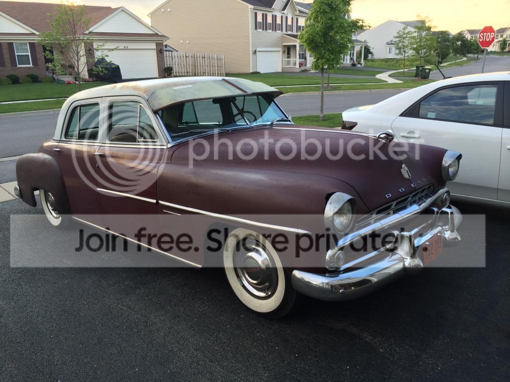

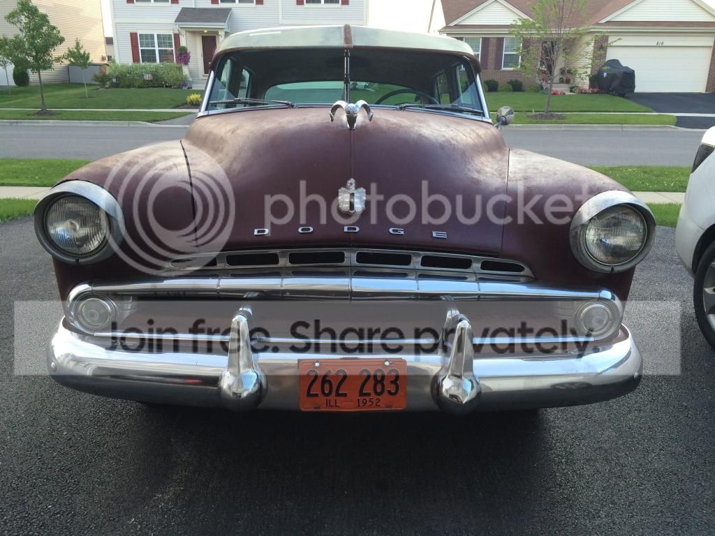

Personally, I think if you're going to lower the front too, you need to rock it withOUT the hubcaps. I think it would look weird to leave them on if you're going towards the rat rod look. The black steelies with huge whitewalls are :pimp:
If you're staying with the wide whites I'd keep the hubcaps, or look for something like a baby moon. But I've always liked the little hubcaps on steel wheels for post war era cars. And the stone guards are cool.
New carpeting should be here pretty soon. I went with dark grey from JC Whitney. We will see how good it actually is. This Saturday I hope to get the title transferred and get license plates so that I can actually drive it next week (if the weather is any good)
Wide whites are definitely staying. I like steelies with Moon spider caps. But I will probably stick with the full caps for now
