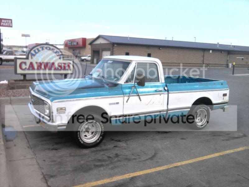

this is my 71 short bed
I want to put a 67 front clip that I have on it and do a 5.3/4l60
drop it maybe air ride and more modern wheels
but I am having a hard time with putting the 67 clip on it since it has a awesome patina
nice truck

I want to put the 67 clip on it with the chrome head light rings and grill trim. then paint it a bright cherry red with 17'' cragar ss wheels

some chevy trucks got leaf springs it was an option my 71 is leaf so its not just a gmc thing. and yes it is original I am the third owner I got it from the son of the original owner. I was the first person to change anything from stock on it.
