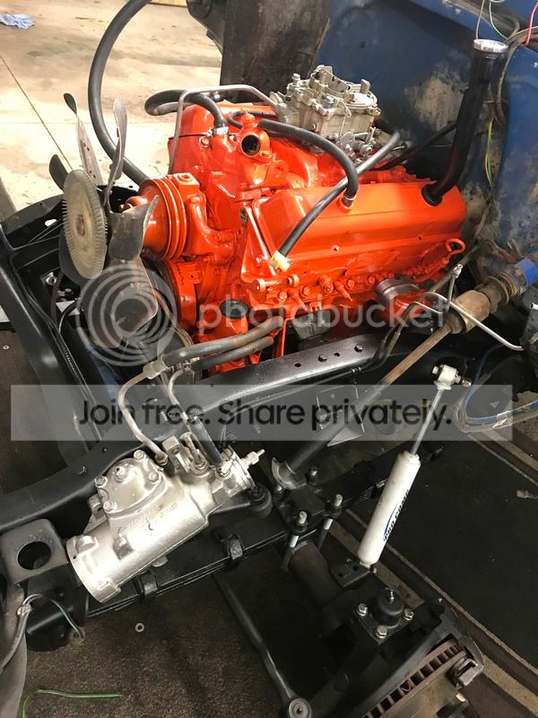

Spent some time tonight removing some bolts, grease and all connecting wires. Seems the motor is separated from the bell. Ready to yank it out!
Set motor back in last night. Didn't get much else done
