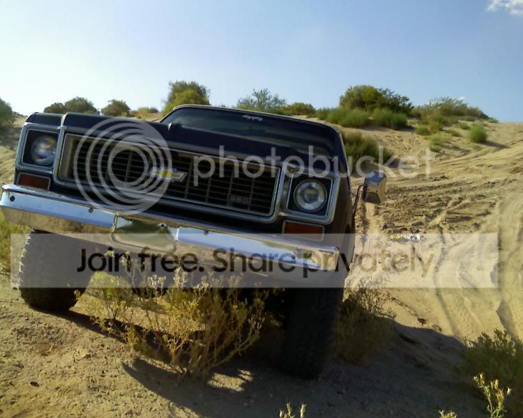

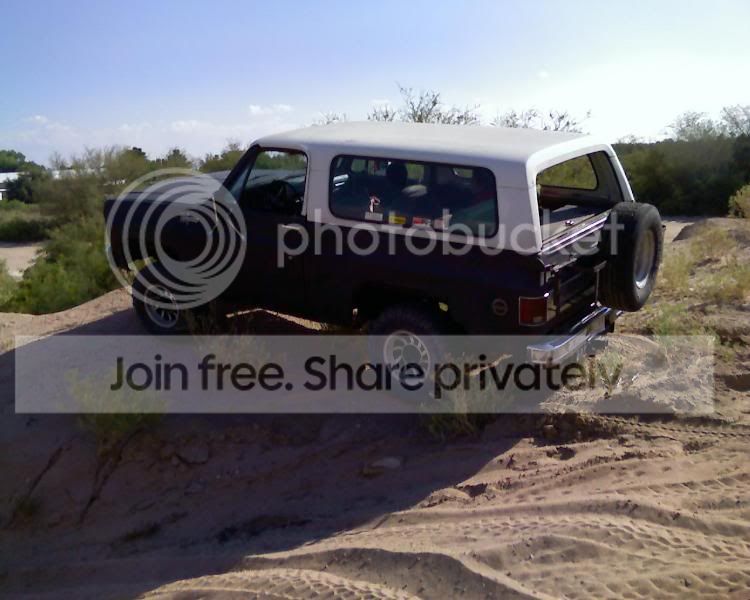

well after a long day and an even longer night i just finished added the lift to the blazer after subtracting it from the truck :) its tall!!!!!!
well i still need to put the brakes(front)
retorque the bolts again
and then add the 35"s
and ima about to go to work at the 24hr burger PAD
9pm -3am :(
but tomorrow ill be done and will take some picks
oh one more thing
there was a 2" block bolted to the leaf pack on the rear and i added the 4" one to it
is that safe???
oh one more thing
is that safe???

You took out the 2" block and put in an add-a-leaf that gave you what...about 1/8"-1/4" more lift... so where did you get the other 1 3/4" lift in the rear from? It looks like it's sitting pretty level...
