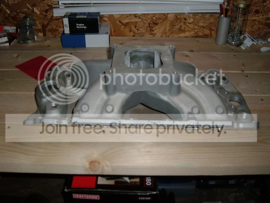

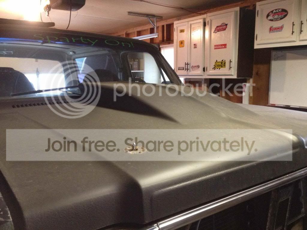

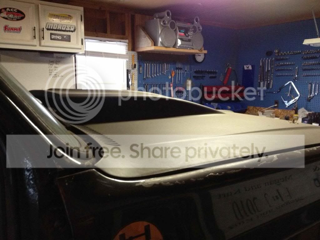

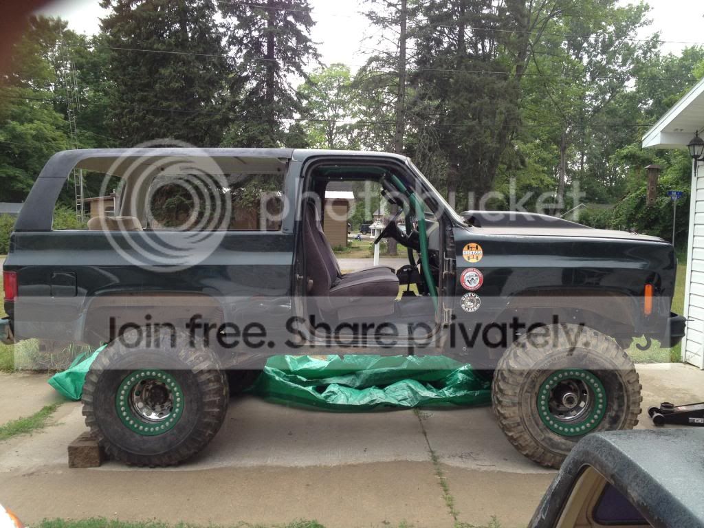

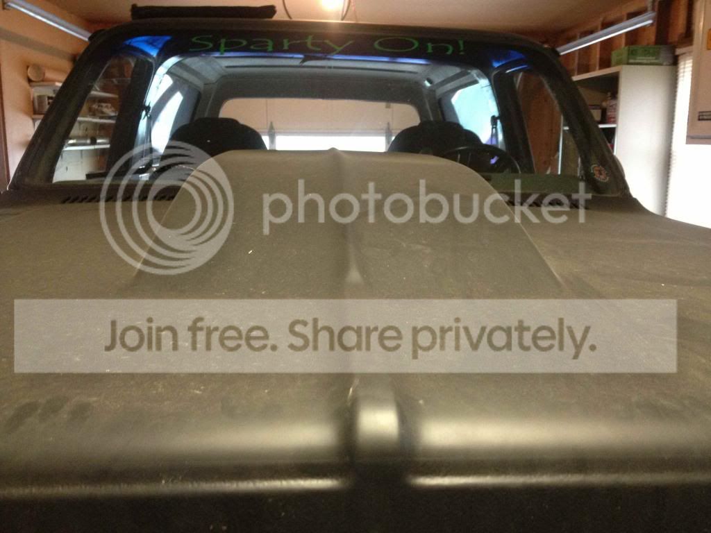

Well be looking for awhile and decided that I should start a build thread.....
Here's the Specs:

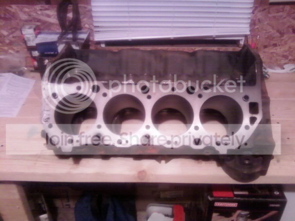

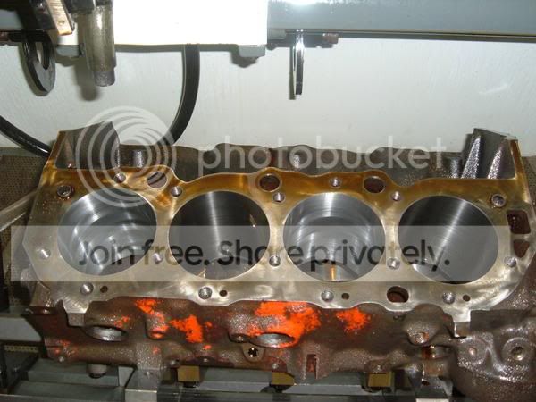

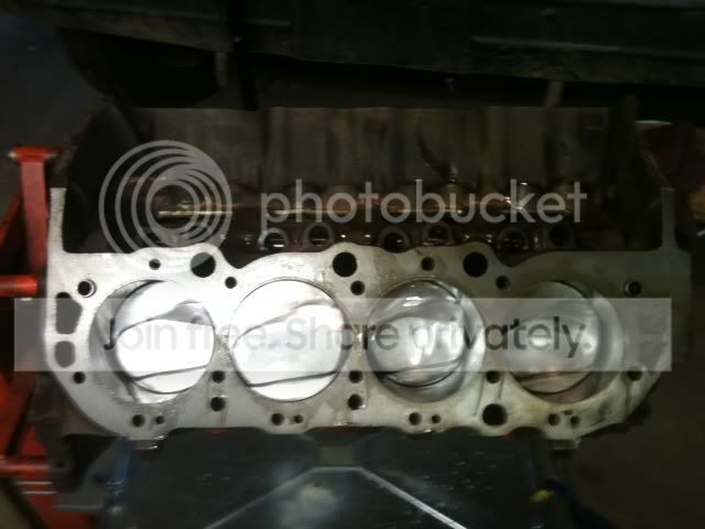

468ci

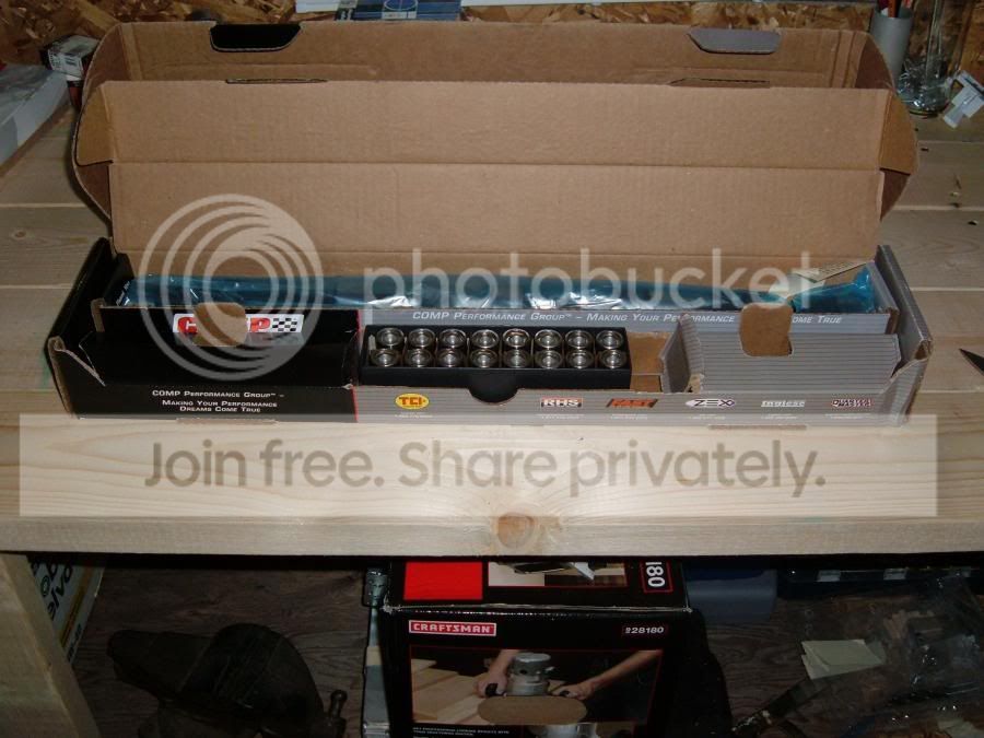

-Extreme 4x4 cam
-750 Holley DP
-Ported & Polished 990 heads w/ 2.25/1.88 valves
-Hurricanee single plane intake
-Summit ignition
TH350/NP205

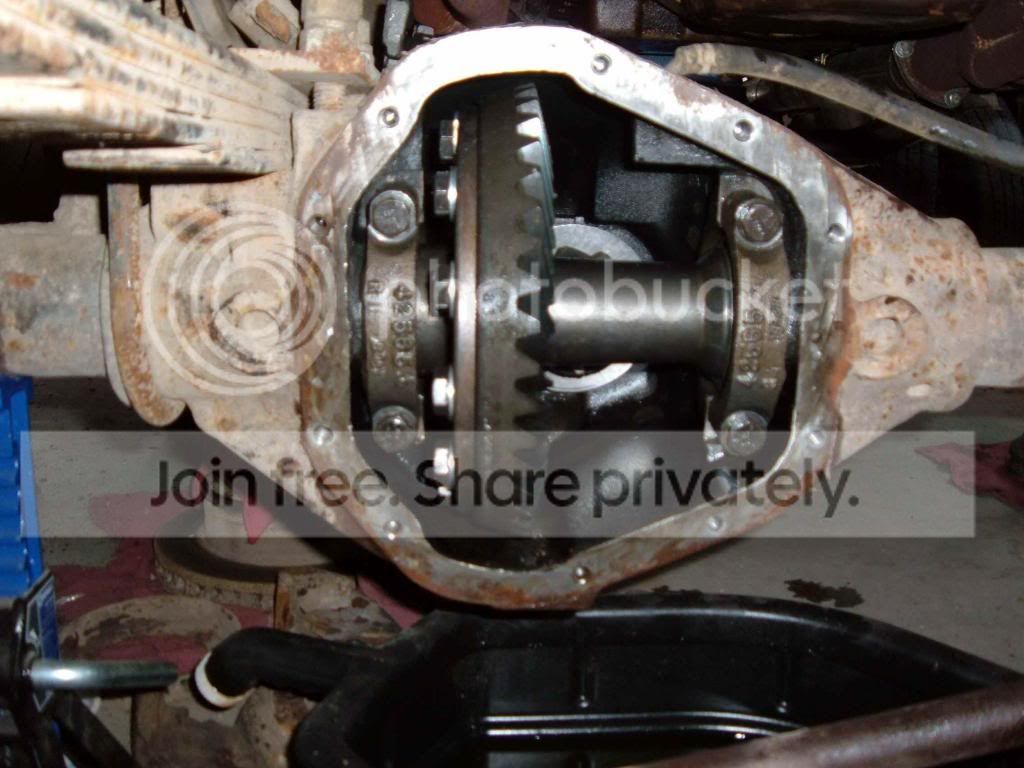

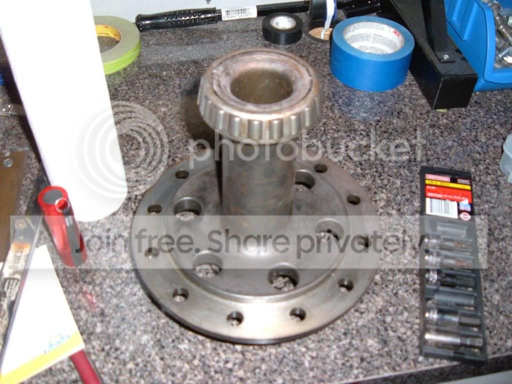

Dana 60 spooled w/ ram assist, crossover steering & 5.13's

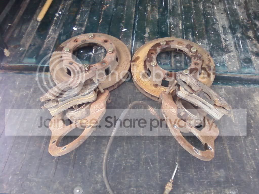

14 bolt disc conversion w/ 5.13's & welded
15x3935x15 TSL's
22 gallon fuel cell
I'll update more later...

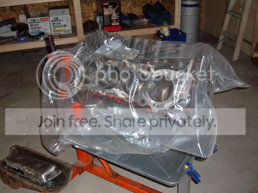

Here's the skinny on the engine....

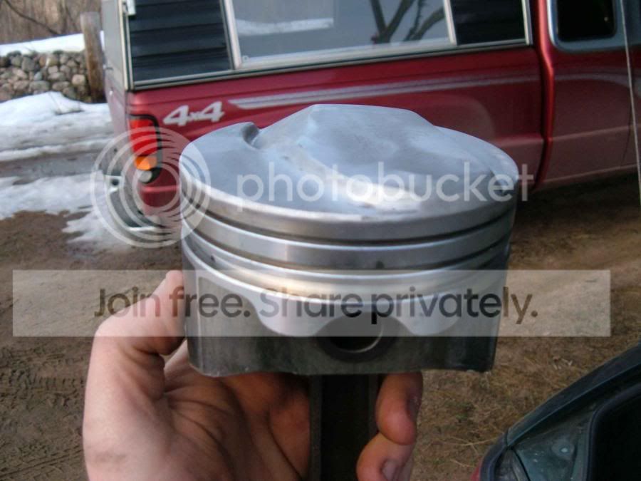

-Speed pro domed Pistons
-HD truck rods
-Cast crank
-990 heads ported & polished, 2.25/1.88 valves, roller rockers, Comp Cam springs
-Extreme 4x4 Cam
-Hurricane single plane intake
-Holleg 750 DP

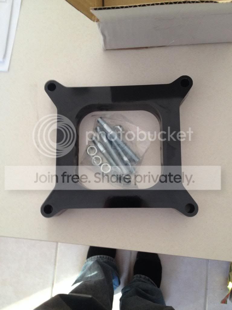

-Carb spacer

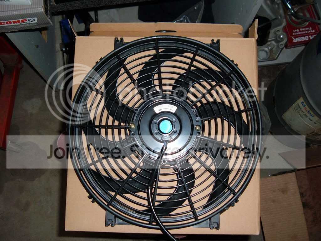

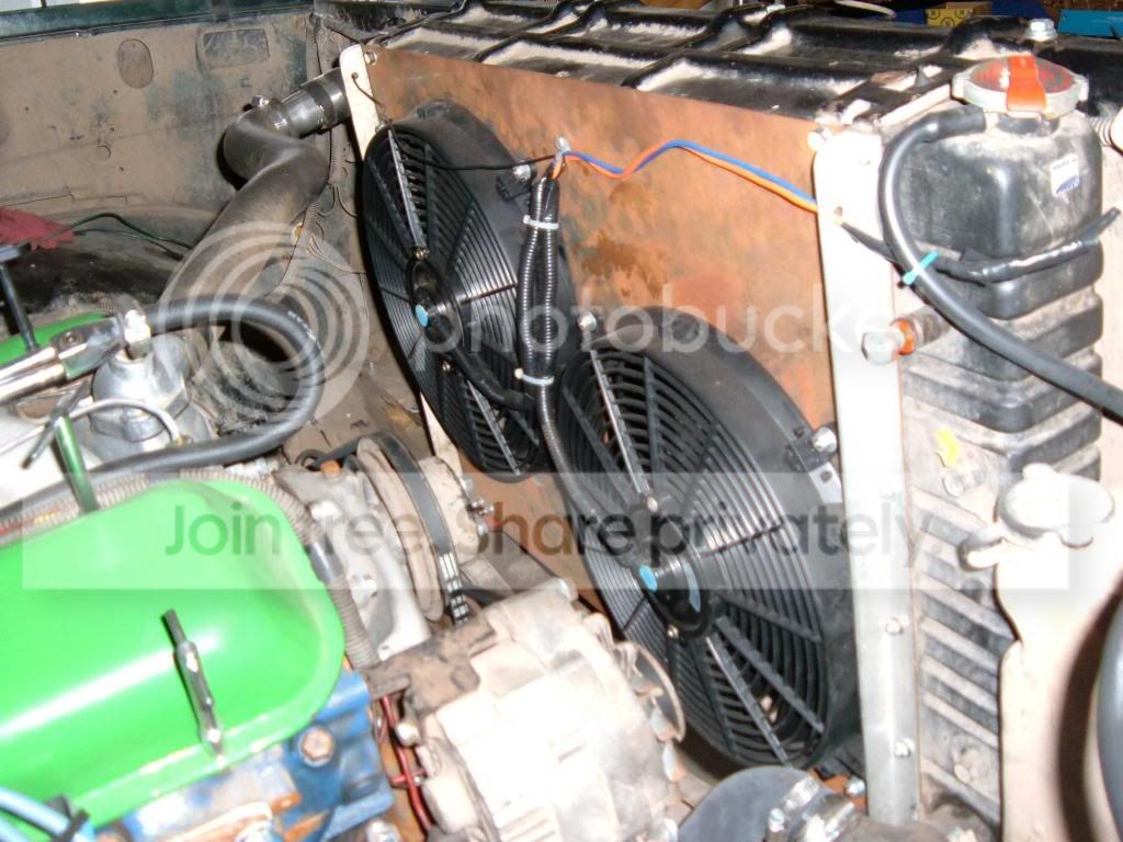

-ProForm electric water pump
-Dual electric engine fans
-Quick Fuel regulator w/ return
-Summit electric fuel pump

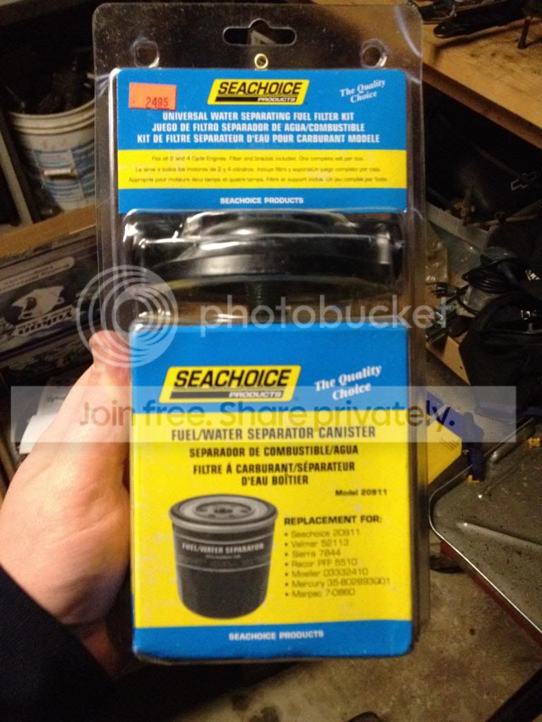

-Boat screw on style fuel filter
-1 wire alternator
-22 gallon fuel cell

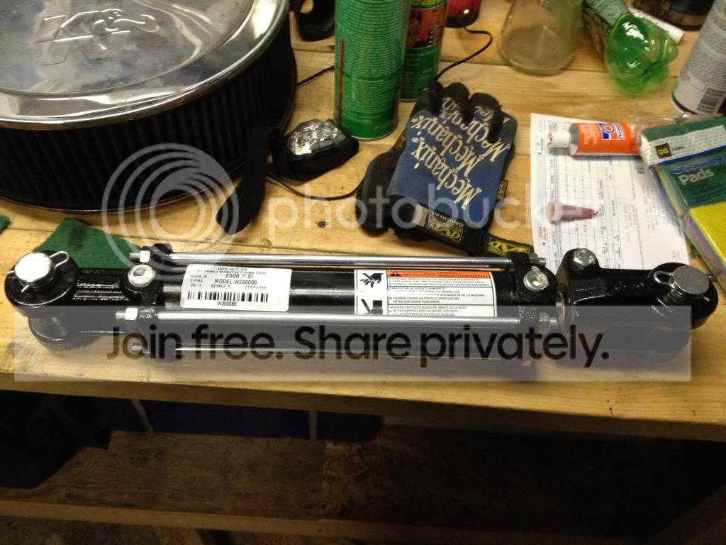

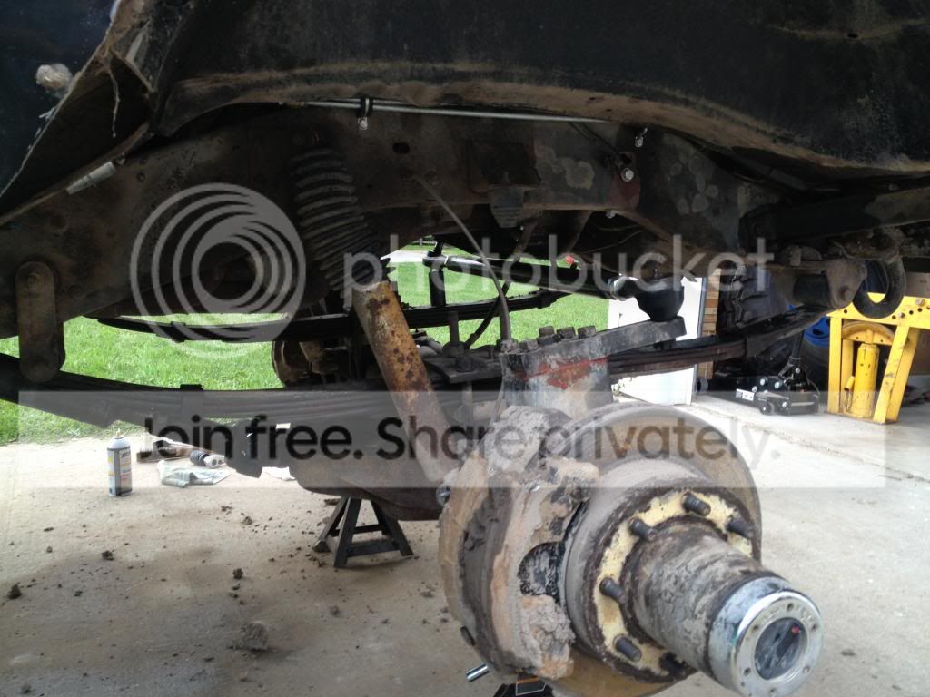

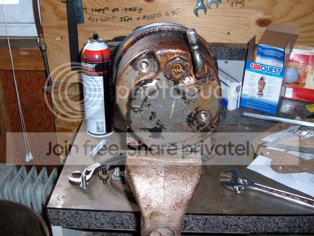

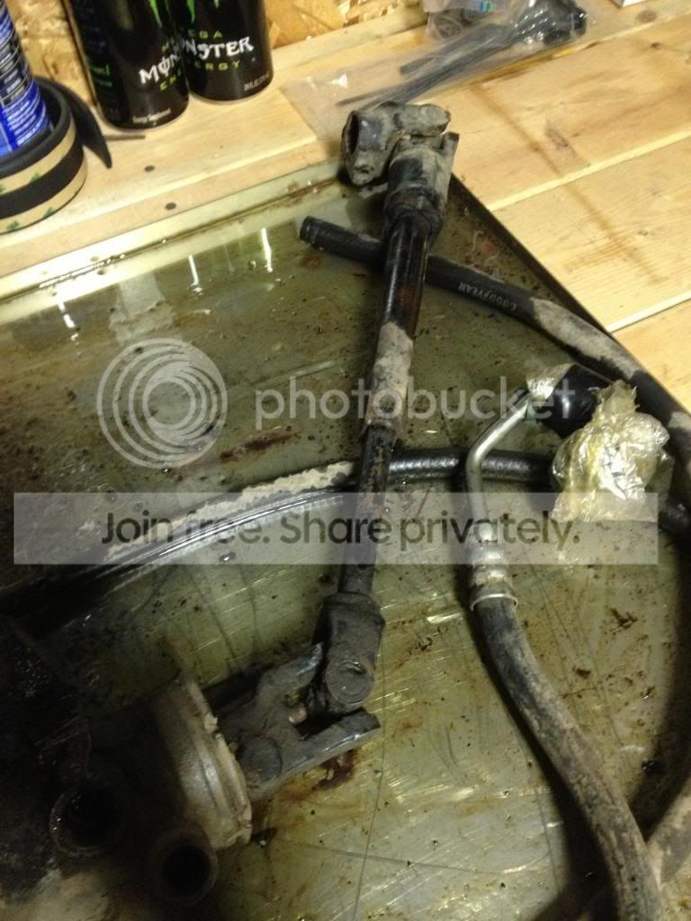

Front axle which is a Dana 60 w/ all the goodies....5.13's, crossover steering, ram assist, PS cooler, XJ steering shaft, West Texas pump mod, spool, & remote reservoir....

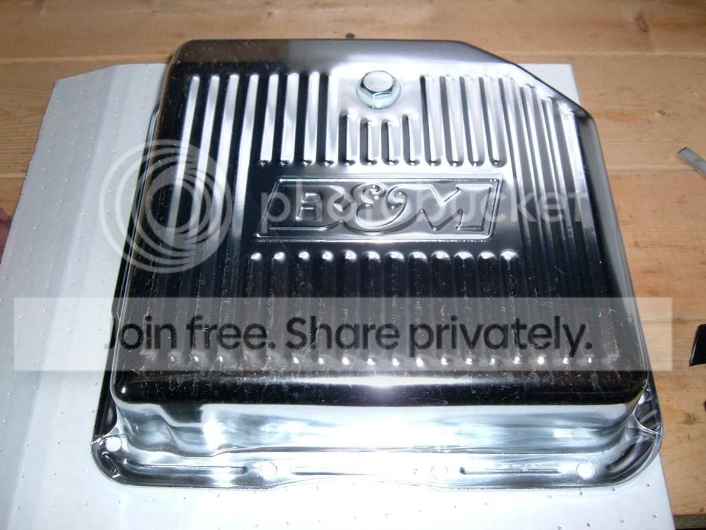

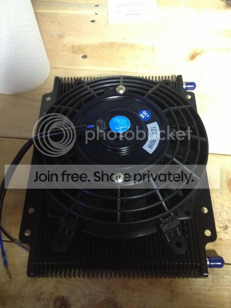

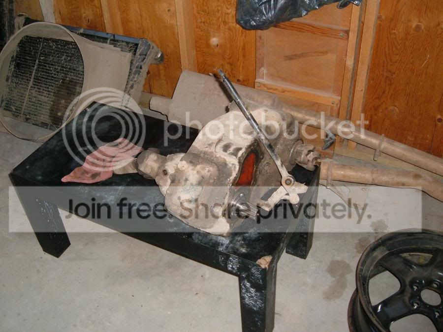

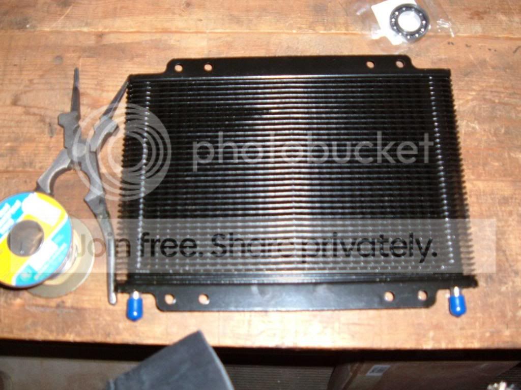

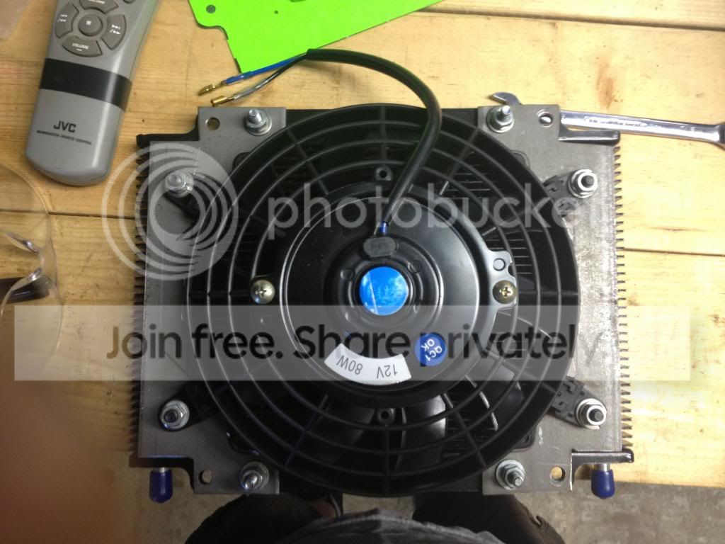

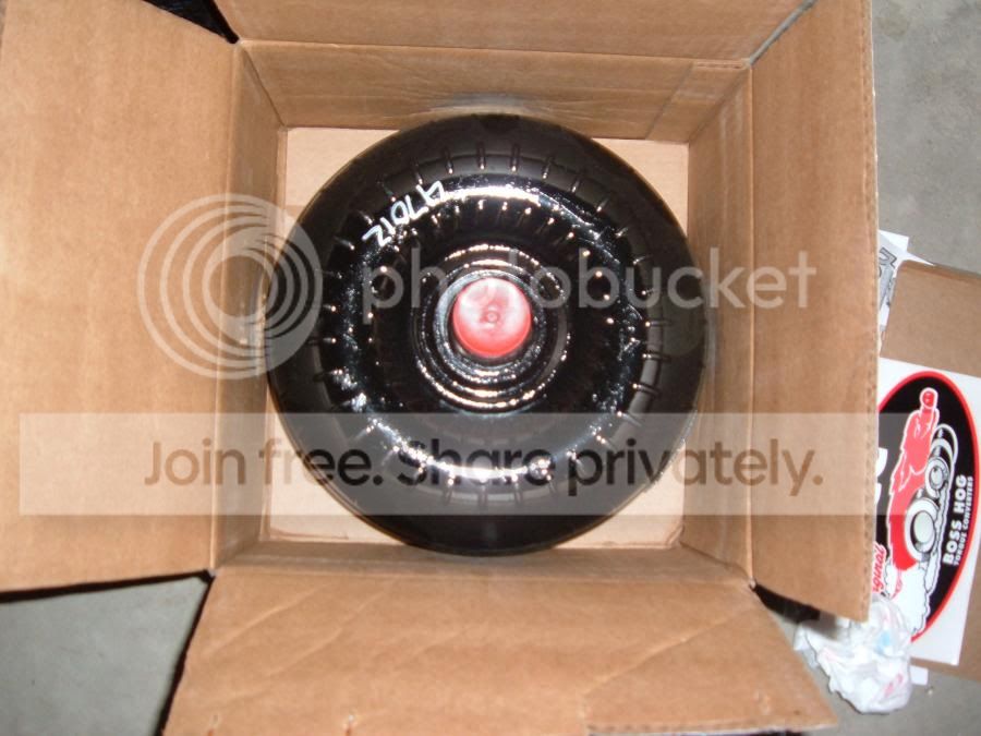

Tranny & T-case is a TH350/NP205. It used to me mated to a SM465. So I had to get the coupler adapter from AA. It has a Boss Hog torque converter, deep tranny pan & remote cooler w/ fan. Shift kit w/ HD parts

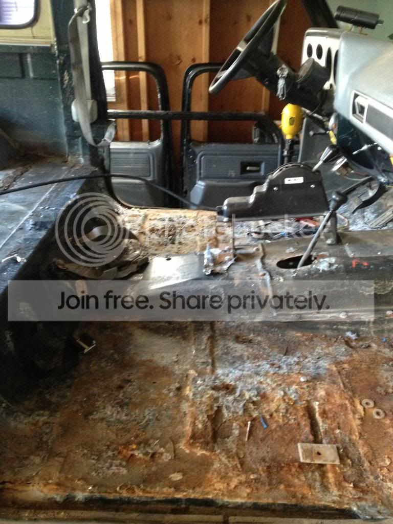

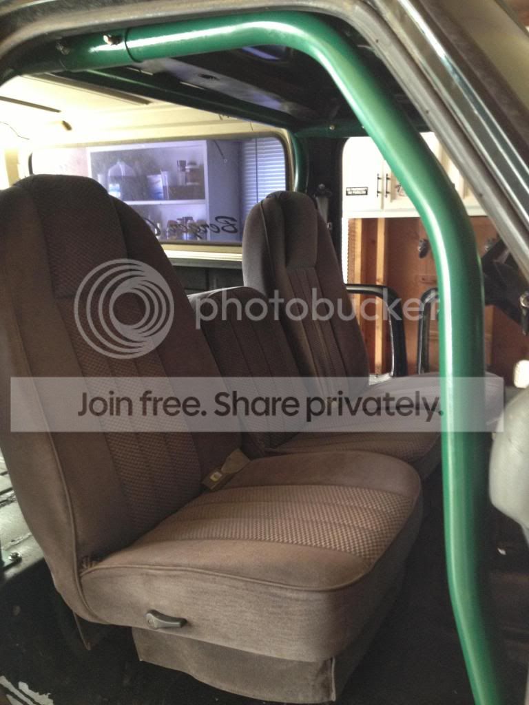

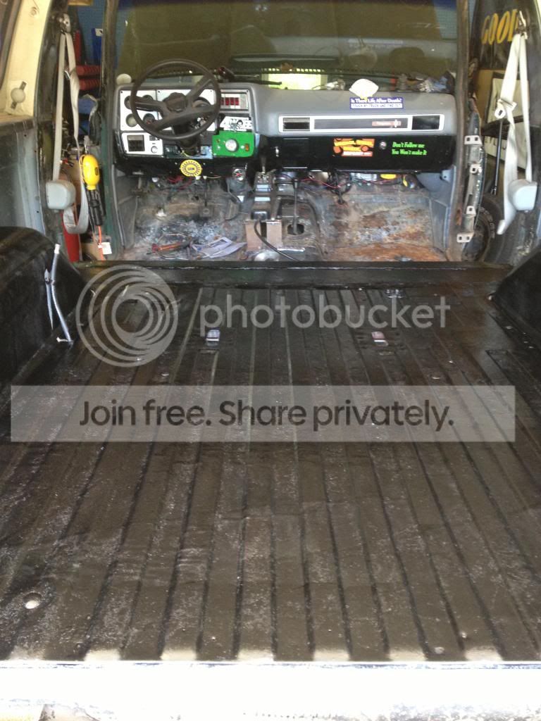

Interior is straight forward no show all go!!!
New rear lap belts

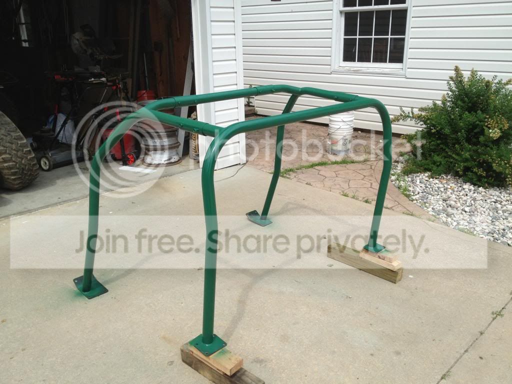

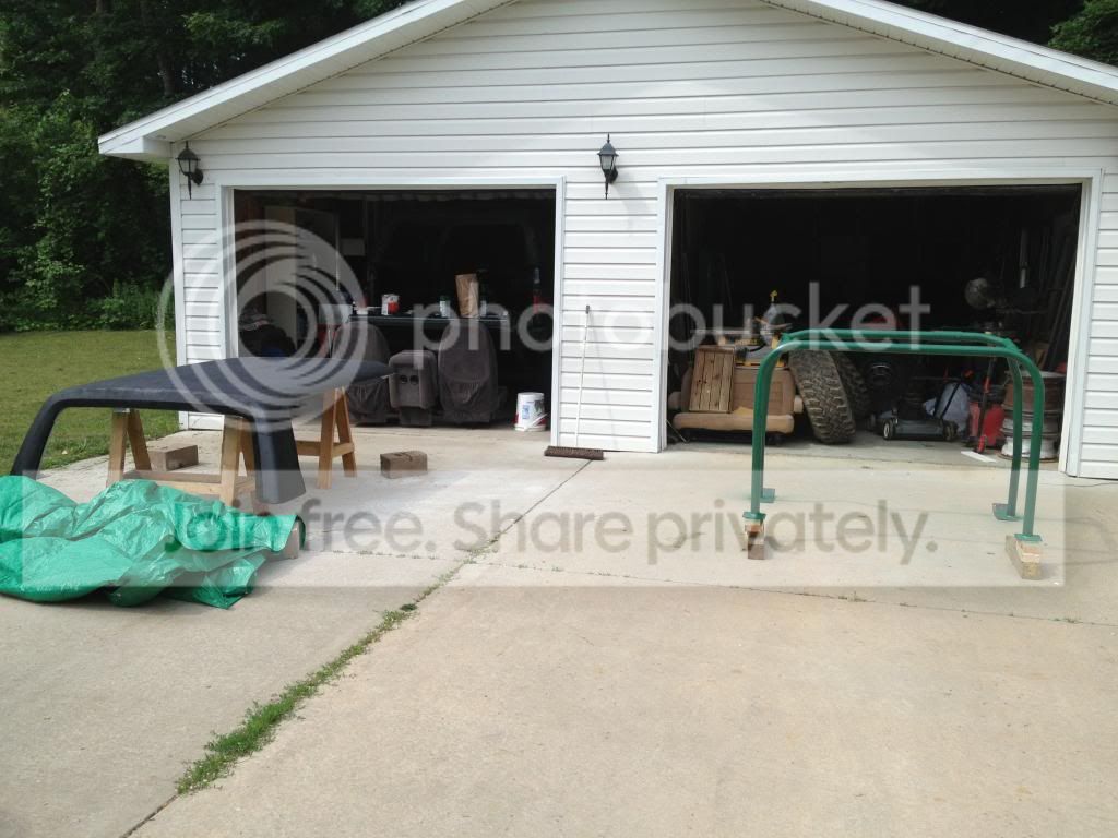

4pt roll cage...

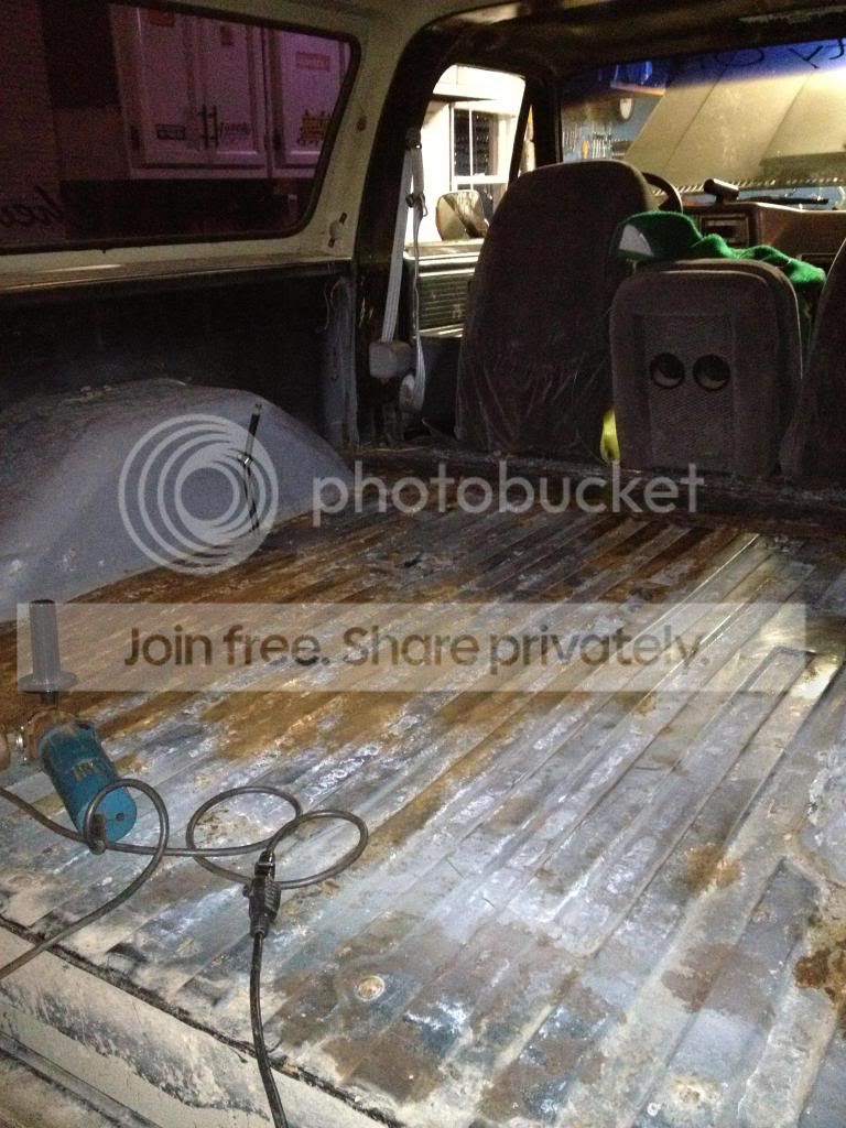

Bedliner the floor....
Racing seat on drivers side w/ 5 pt and 2pt for passanger...
Quick disconnect fire extinguisher...
