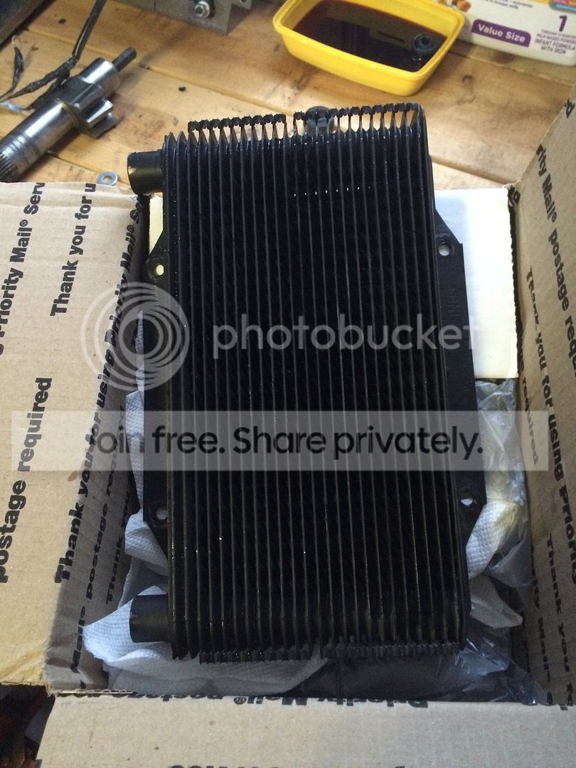

Got the cooler bracket out yesterday and figured out where I wanna put the new PS cooler I believe.....
Just make sure your reservoir is higher than the cooler or you will have issues with air/ bleeding. Ask me how I know.
