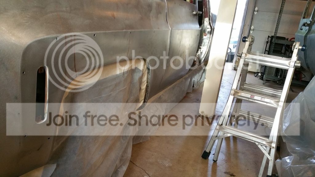

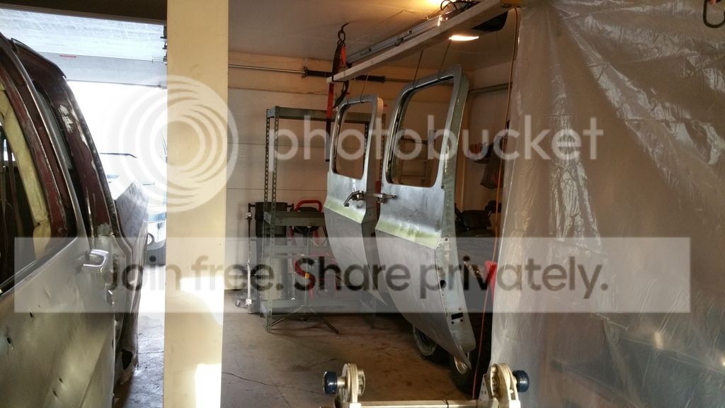

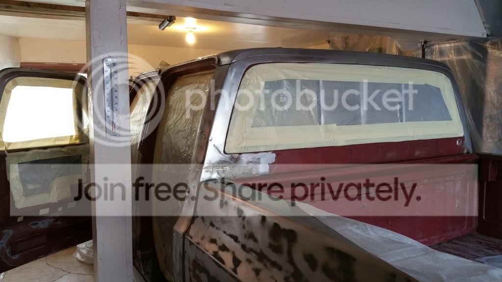

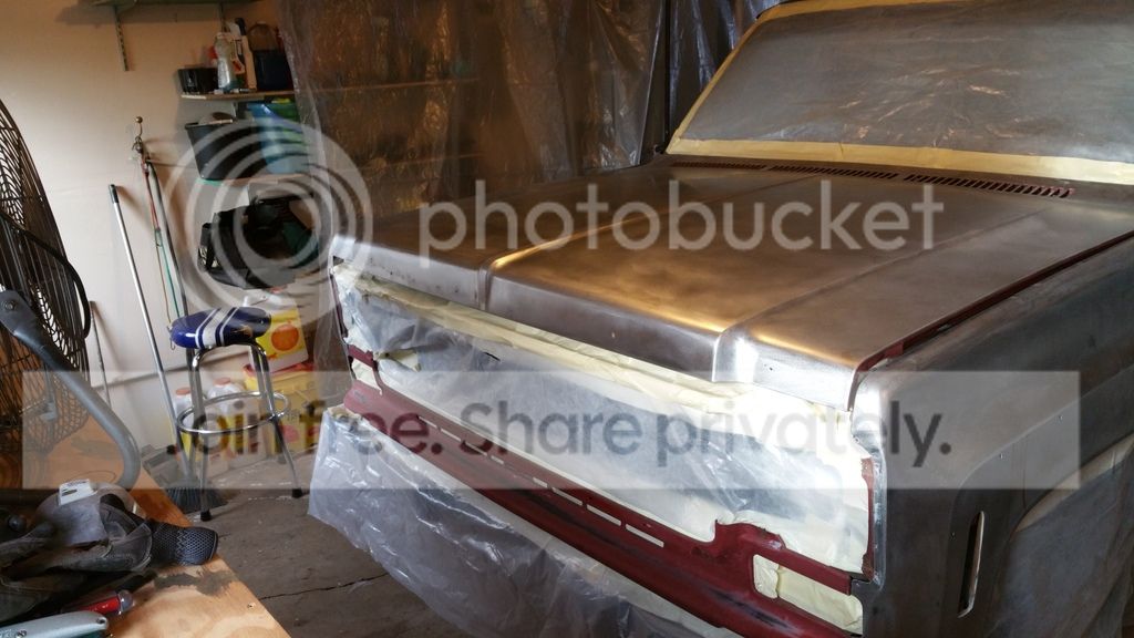

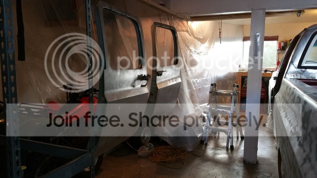

A little progress today. Started masking and then ran out of my good tape... I'll get more tomorrow. Then I started hanging plastic and re arranged how I had my doors hanging so I could paint both sides. Still hoping for primer this week but we'll see.
Is the body that straight? Or are you going to find all the door dings and low spots later?
I know absolutely nothing about bodywork. Not sure what order that happens in. I just kinda assume you prime-sand- fill-prime-sand.

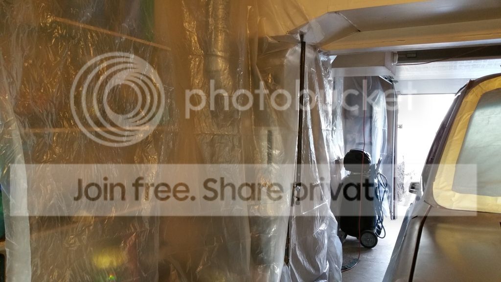

More masking done today .If all goes to plan, I'll finish masking and finish hanging plastic tomorrow Wednesday I'll get my lights and compressor set up and dialed in, and Thursday spray primer.
