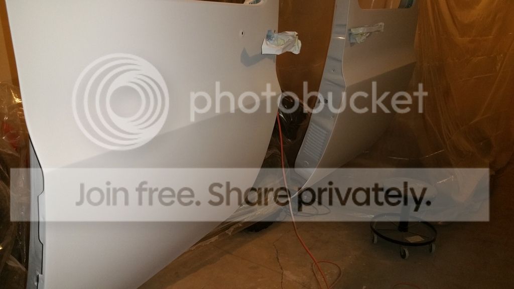

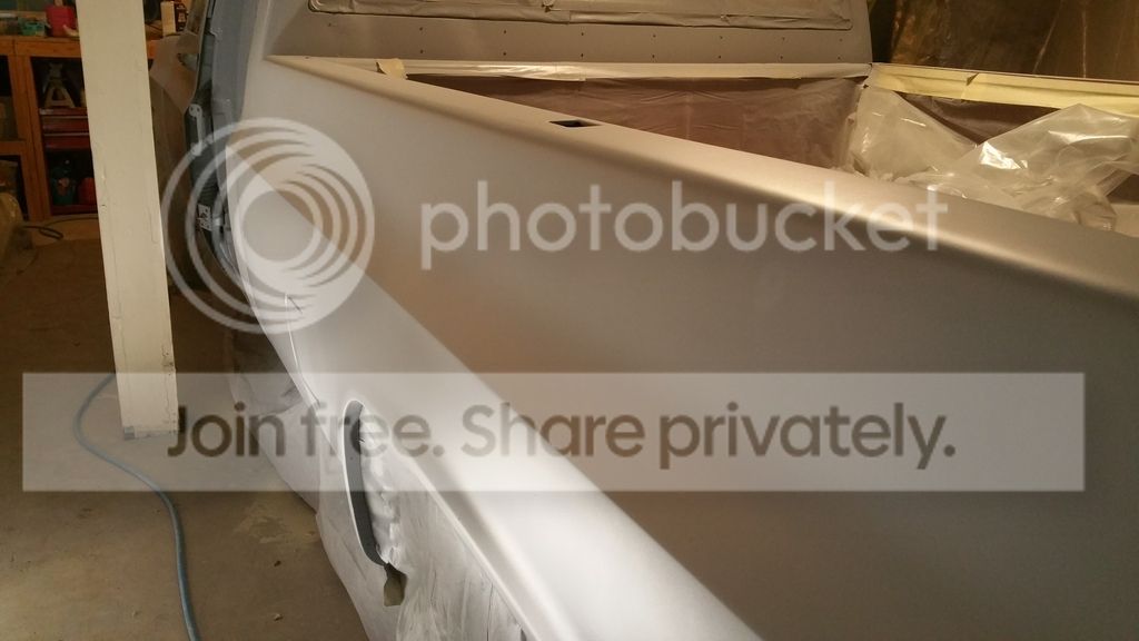

Went over some minor imperfections with glazing putty today. That stuff is awesome! Sands like butter! I don't think I'll be able to lay my high build tomorrow but we'll see. Depends on if we're supposed to hang out with friends tomorrow or not.
check your glazed spots the next day to make sure they haven't shrunk too much..that stuff is easy to apply and easy to sand but it will sink a little ...that's my experience...except on pinholes...but a bb sized spot can sink.

For sure. I put the glazing putty on before doing my high build primer so as to hopefully be able to have it all appear seamless.
