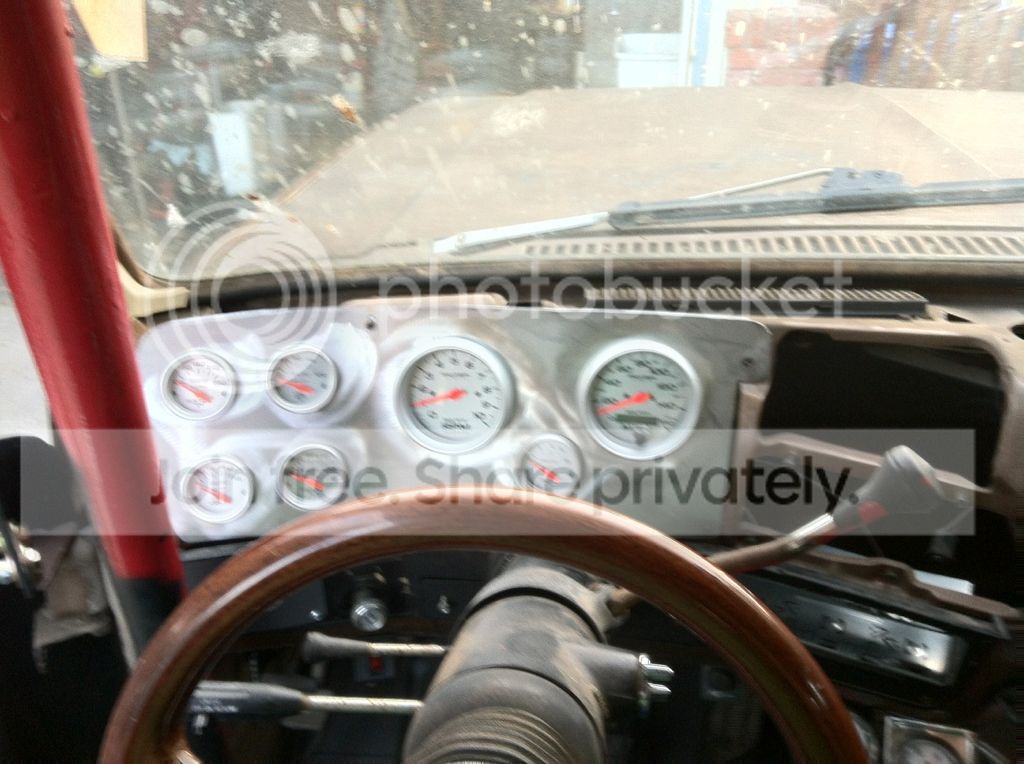

Anyways. Such is the case with my dash setup. To move forward I removed the dash pad an I'm going to make a new setup.
After that tho I got the exhaust finished. Not great but should hold it over for atleast a few trips.
Well it's still terding me so far. Went to hook em up an somewhere in my little wiring setup something were Amiss. So I pulled it all an I'm working on re wiring. It's a pain in the scrot. I hate wiring.
Well this morning we have success. Redid all the wiring while eating some panda yesterday. The only thing not hooked up is the trans temp and speedo. Both of which are waiting for the doubler/th400 to get finished an installed. No sense doing em up for a temporary situation.
