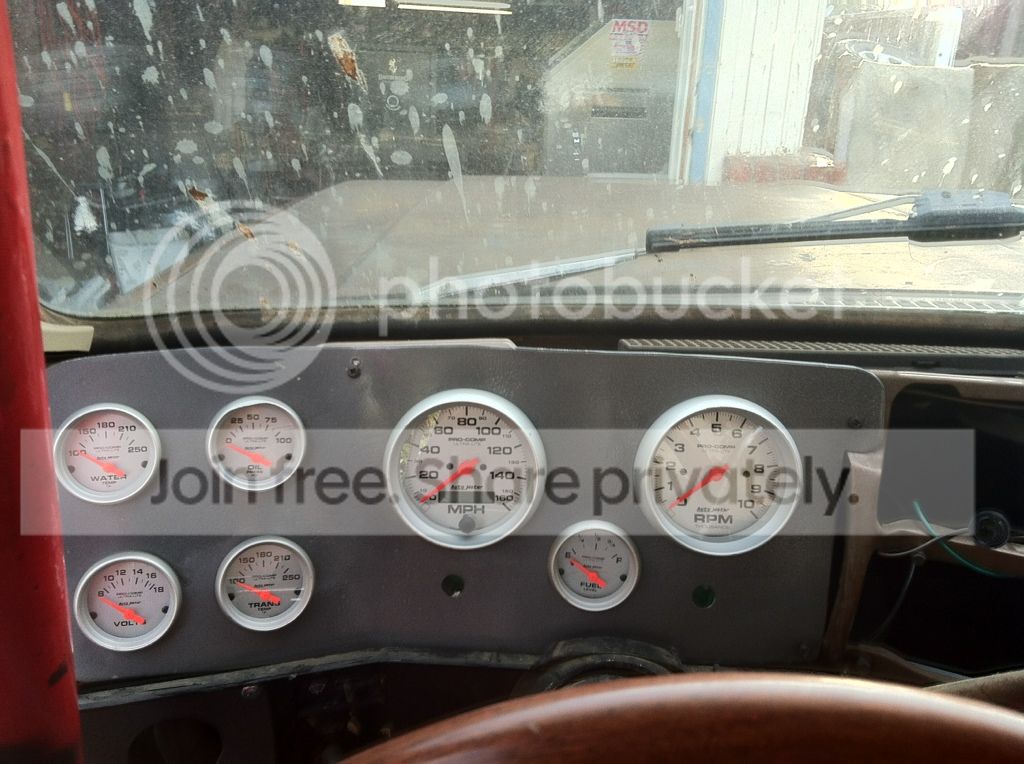

The final version of the gauge setup.
What is the gauge doing when you hook it up?
I tried that today. I'm getting a reading of like 2-3 ohms. So I guess the tank is really just that empty according to the sender. Dump another couple gallons in and see what happens
sounds right, put like 5-10 gallons in it.
but whats sad is its only a 22 gallon tank. and its got between 6-8 gallons in it?
two 5 gallons can full plus a few minutes of driving around the block. i guess i would expect it to read atleast something off the E peg.
but i'm not worried about it enough to stress right now. once i swap the trans out and it can roll then i'll see what happens when its on level ground and i can fill it up.

i'm leaning more and more toward the fuel sender in the fuel cell being bad?
not really sure how these things work but it seems like it should read higher?
i'll recheck the ground for the sender too. its up under the truck and maybe not clean enough. the only thing that gives me hope is the reading at the fuel cell and the reading at the gauge is damn close so atleast its not the wiring.
Well the less gas in the tank, the lower the Ohm rating coming from the fuel sensor will be. Say if your tank is completely full it should read between 89-92 Ohm's. And empty is should be 0-1.
Either way. Let me know.
ok thats kinda what i thought. i'll check the ground. and we'll just sit on it for a lil bit.

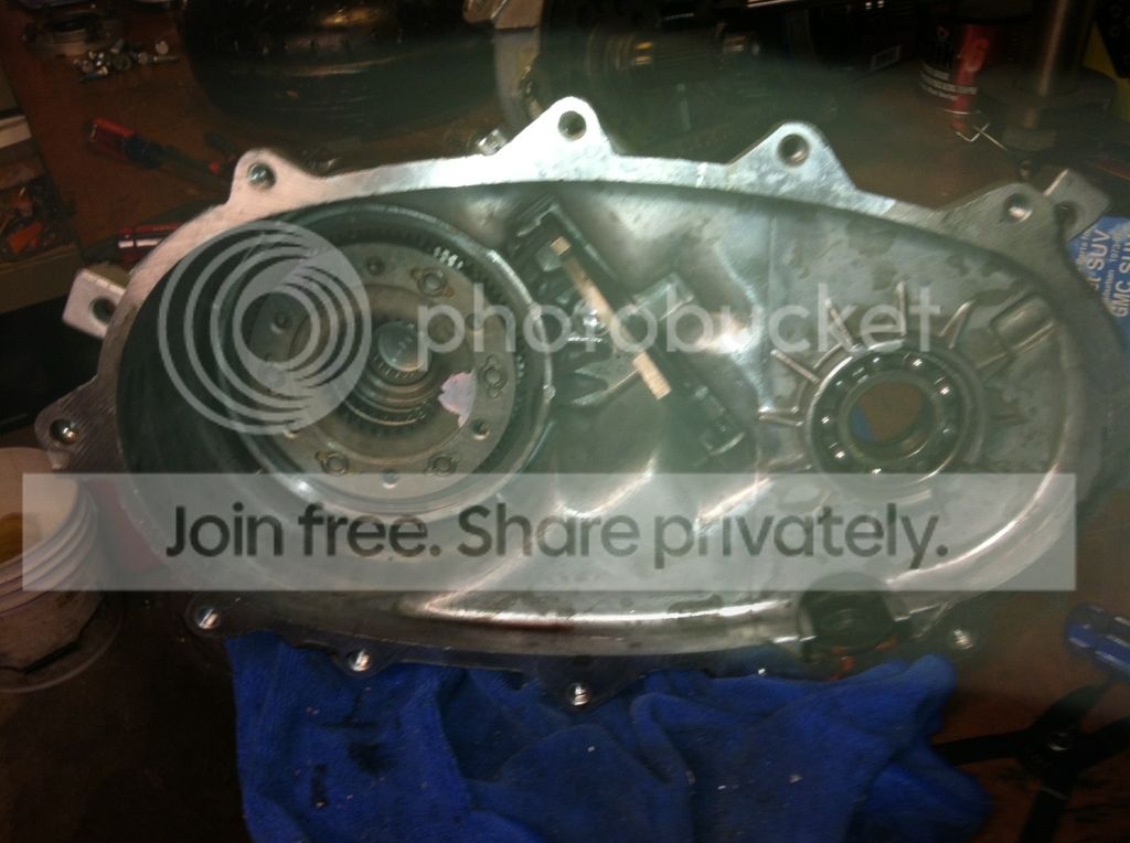

Tore apart my np241. Avery needs the 27 spline and he's gonna give me the 32 that he has. Worked great for me plus a Chance to dig inside and see how these things work.
32 spline input swapped in. Thanks avery!
Maybe I should make the cut for the doubler right now?? Nah better wait
Np241 put back together.

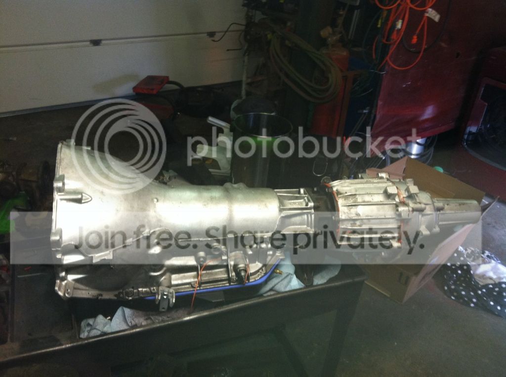

Fits right on to my th400. Sweet.
Ready to get it In then get it on!

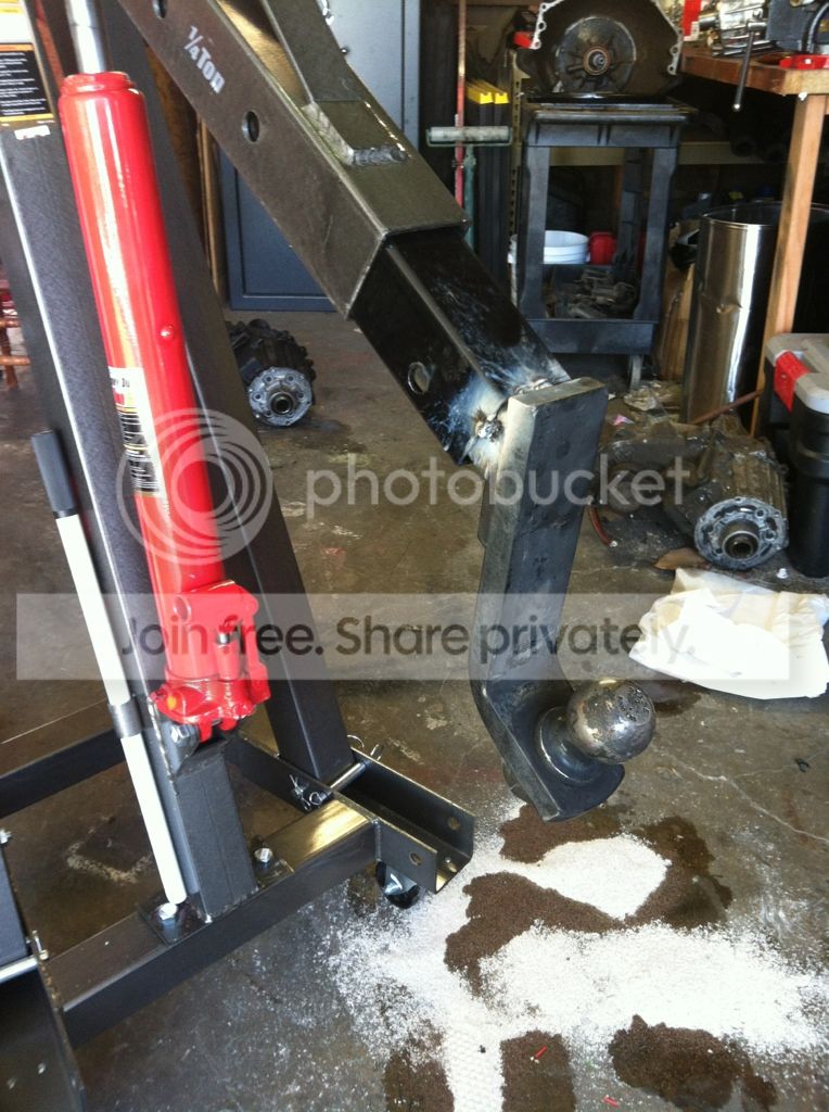

GOT the th400 up into the blazer. Used a cherry picker but it was a tad too short to reach thru into the floorboard hole. So I used a hitch I have and put a few welds on it to extend out the picker.
Worked out peachy. So right now the tranny is bolted to the engine and to the crossmember holding up its own weight. I'll try and finish the install over this week.
Why didn't you drill a 5/8" pin hole through the stinger instead of weld the hitch in place?
Martin
thats one way to do it :thumb:
