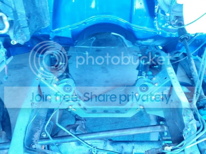

Had a busy day on today... Worked and finally got the TnA cross member in with the extra help I got now. :thumb: My frame was a little tweaked with the lack of cross members but it's good now it pulled it together and everything is set.

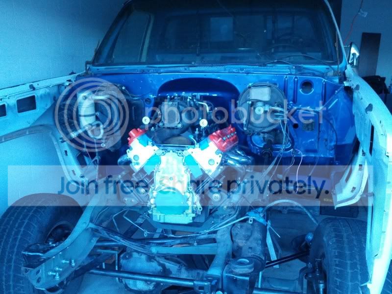

Next step in building the shock hoops was getting the engine in and setting up clearances.

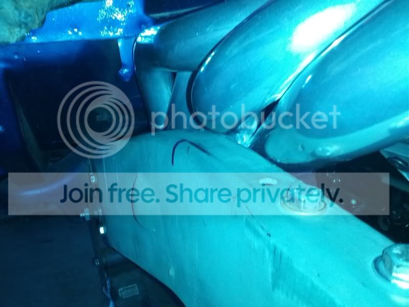

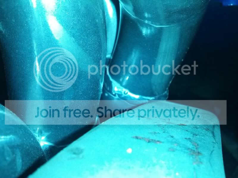

The headers don't fit as good as I was wishing. They are contacting the frame, when it revs it will crush the tubes into the frame. I have like 1-2mm between the frame and header.
Drivers side
Passenger side.

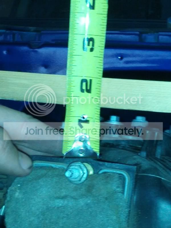

I cut down a piece of lumber and set it on the fenders to check for intake manifold clearances.
1 inch and 1/4 clearance. Good thing I have a cowl hood, :doah::grind::hack::weld: When Kurt built the first set of LS Mounts he made my set, he came back and said it could cause clearance issues, We had talked about making another set to raise the engine another inch, I think it would work very well going a inch and a half up and I'll cut the hood to adapt the engine if needed. What is your thoughts on this guys?
Holy blue pics batman! Please adjust your camera or something :p

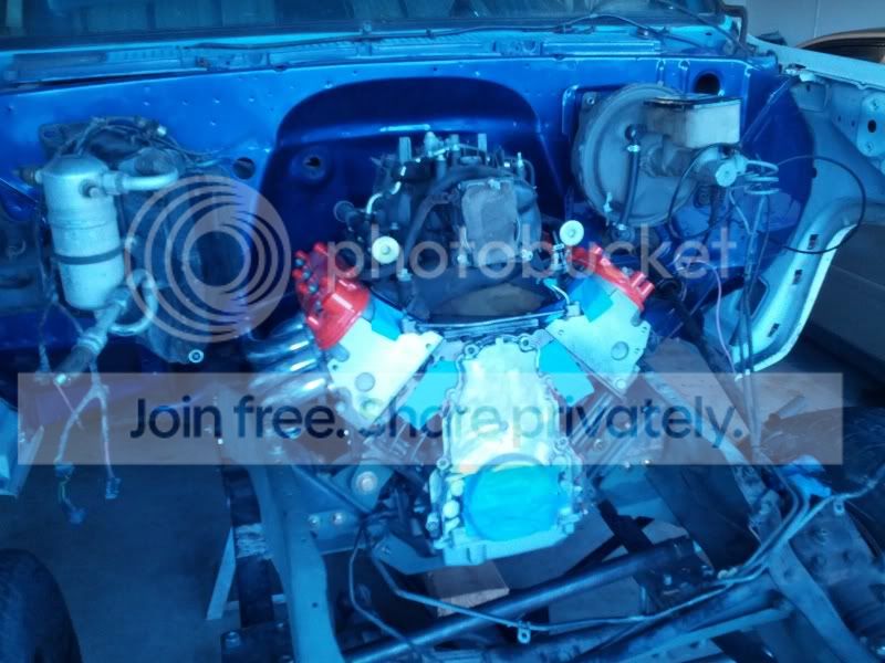

I think your engine has more clearance than you think. Use the brake master cylinder for reference. In the pics it appears higher than your engine.
Yaa my phone took goofy pictures and the lack of light didn't help. I fixed the settings.
You know I didn't think about that I'll have to set the hood on it tomorrow and see how it looks. I'm also going to maybe put the transmission and transfer case in and set those up.

that is the top of the engine, don't sweat the hood...
you have plenty of clearance...look at where your cowl is.

hold a straight edge out from the cabs cowl, you'll see how much space you have to work with...:waytogo:
I was running it along the fenders where the hood would sit. I thought that was the best way to measure clearance because of the curve of the fender. :dunno:

The guy said he had 2010 camaro headers. They look like they clear pretty well. I'll have to do some measuring of the set I have on mine for future LS swap reference.
the 2010-2012 camaro headers he has work pretty good except he had to clearance the lower part of the frame rail on both sides by about a half inch and also had to change the angle of the collectors because they pointed down to far.
The headers I have are supposed to be specific to our generation with swaps. Sense mine is such w cluster I think is where it runs into problems
