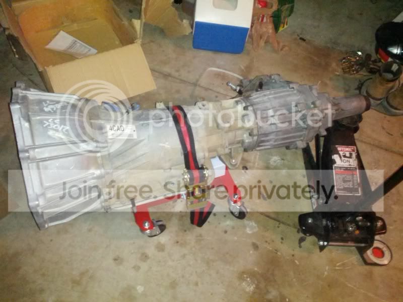

4l60/np241, Was pleased to see these go together with no effort. I pulled tcase back off and started going in.

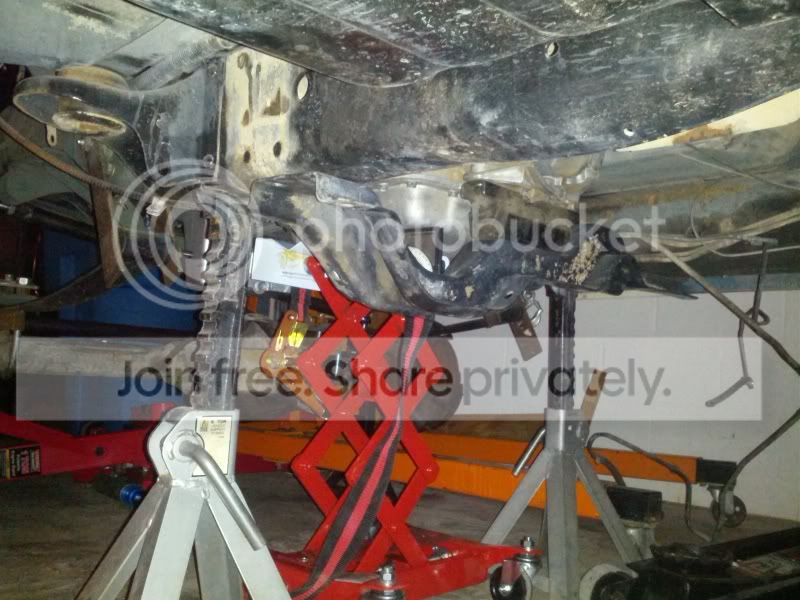

Does this look correct? I don't remember how the cross member mounts on the frame.

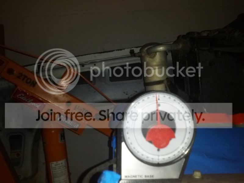

With the tranny at a 0 degrees of a angle, the engine was dead nuts at 6 back. :woot:

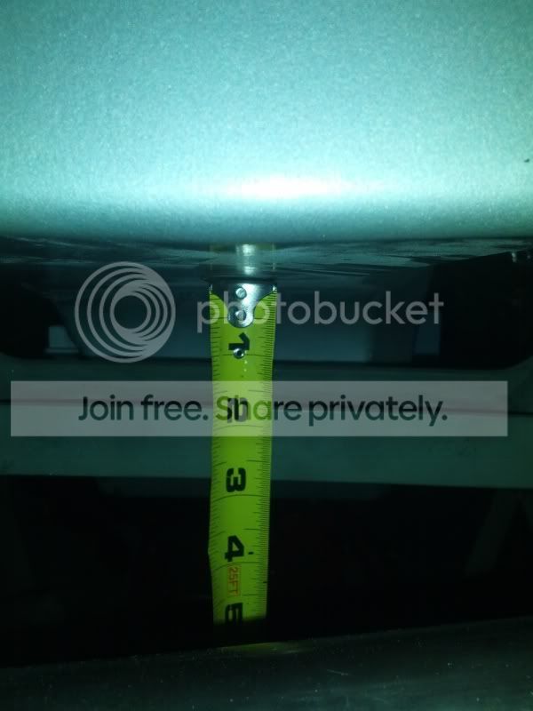

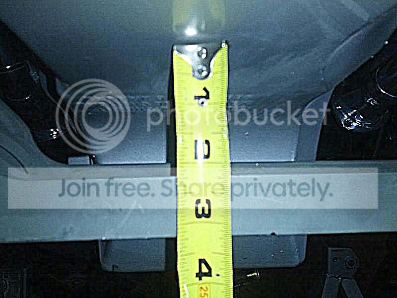

Next I decided for the quest for 2 inches. Turns out I don't need that much, everyone said 2 inches was a TON.
This is with no cranking of the cherry picker yet. With going up one inch everything clears a ton more.
I might have to do a slight notch on the drivers side rail. The passenger side was coming really close to the pinch weld on the fire wall. But this is without new cab bushings so I would assume the 31 year old bushings would be sagging.
looks like you need to spin the crossmember 180*...the drop part of the transfer case goes with the drop in the crossmember...like so...
images
1982 c/k 6.0L Overbuilt Mall Crawler Build. (Shoe horned in)
Fat. Guy is right. The t-case isn't going to go on that way. Unless you're using one with a drivers side drop, which I don't think you are.
My advice about the t-case is don't try to use a jack. It weighs less than 100 lbs., so I just sit on my creeper, pick the case up and lie down on the creeper, roll up under the truck and just bench press the case into place. It will just hang on the trans by itself while you rotate it up and start a bolt to hold it. If you try to strap it to your jack, it will fall off because on side is heavier than the other.
I built a cool little stand that sits on that jack. The TC bolts to the stand. works really nice.:woot:I am old and don't like to lift anything.
But Ben would need to learn to weld.:whistle:
Makes sense didn't think about that drop portion. As far as the tcase, that is what I planned on doing. Just needed that piece of mind it would bolt up on the trans.
That's a better idea actually, but it's probably easier to for now just to lift it into place. Haha. I sometimes use my legs and feet to help me get the case into place.
Don't try this with an iron t-case like a 205 or 203 though. Unless you're He Man.
