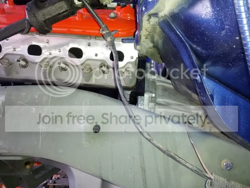

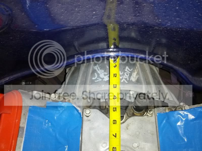

Got to messing with it today, the new motor mounts and the final shackles could be here Friday. Is it me or does the engine need to go back some?

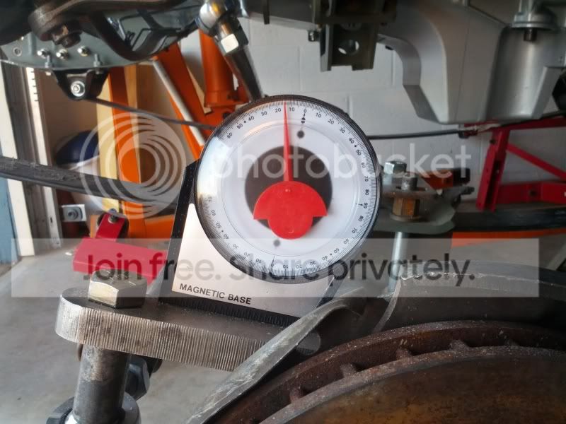

I also thought I would check and see where the caster is at, I have 15 degrees of negative caster. I need to bring it about 9 or 10 degrees positive.
Ok I got my caster wrong. It needs to be 6 degrees positive and I'm currently 15 degrees negative. So I need to bring it around 21 degrees. :doah:

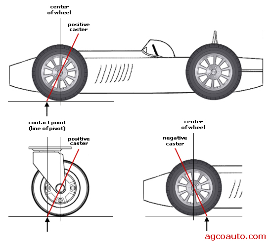

You have positive caster now. So you just need to be less positive, and I mean that in the mathematical sense. You likely have the same problem I did which is why I dropped my front hangers 3".
Negative caster would mean your top pivot point is further forward than the bottom pivot. In case I'm not understanding the perspective of the photo correctly.

Looking at that high steer arm the left is up higher then the right. Which comes to 15 degrees.
I went off of this picture to determine if it was negative or positive.

If that pic is correct, which I assume it is then I have positive caster.

Yes, you are positive now.
