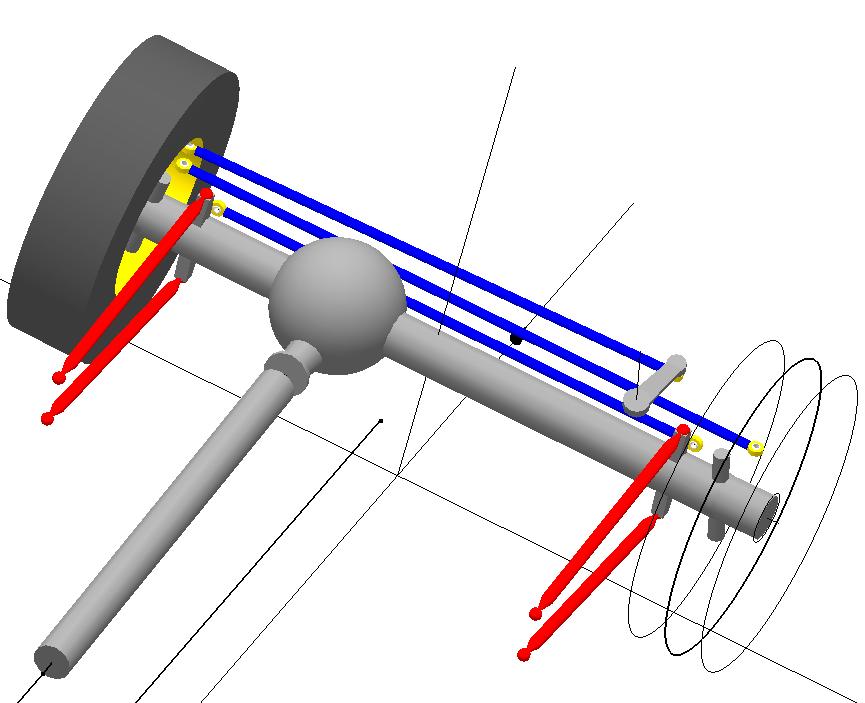

I found this program called susprog3d, has anyone ever heard of it? seems to be pretty cool and might help out
http://www.susprog.com/index.htm
Sweeeet. That looks WAAYYY easier than making every part in cad for the same end result lol.
