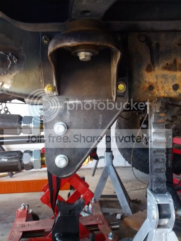

Actually, if they are the ones in this pic, 3/8 might be a bit much...
If you'll remember, this is why you were advised to NOT try and center the tire in the wheel well. And to have it a bit forward would be better. Not surethere is much you ccan do about it now short of getting new tube to make longer links. Unless you can get enough safe adjustment out of them.

Ok so I have this great idea now... by moving the frame bracket back another 5 inches or so I can get the links longer and more friendly. To get 2 inch .250 wall tubing It would cost 95 dollars.
Moving this back to the rear bolts and drilling new holes.
Never mind the crap tastic weld to the left. I should rename this project to pissing money away.:haha:
