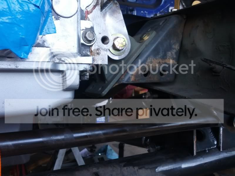

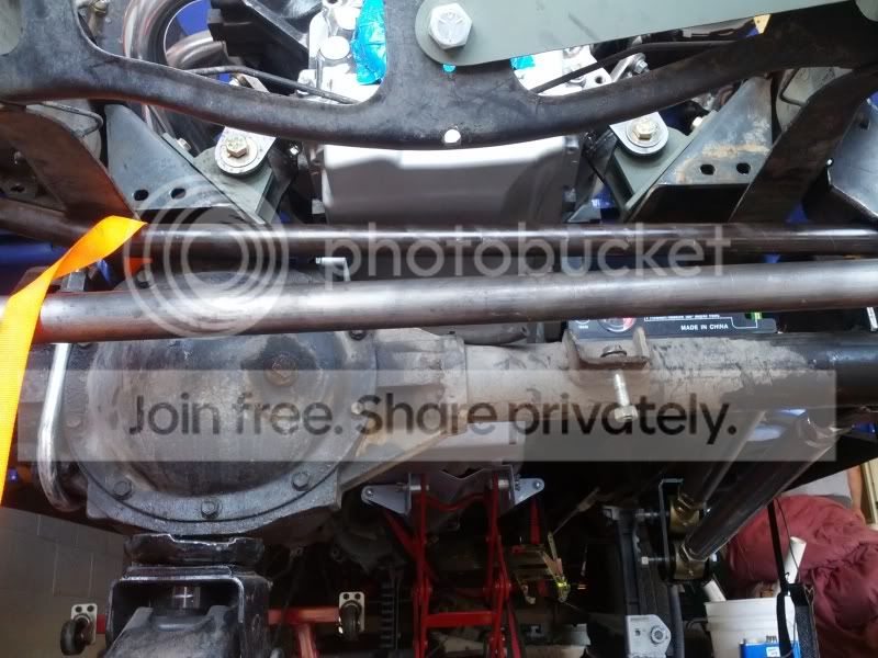

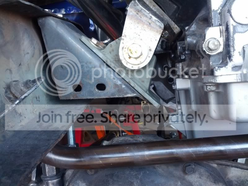

The TnA cross member has to go, just won't work without modifying it way to much. I wont be able to get hardly any up travel before the diff smacks right into things.
:rolleyes: If if isn't one thing it's another. Not really sure what to do about other then a ord cross member and who knows if that will work.

I have an empty engine bay with an ORD crossmember in the bottom of it. Im doing a 5.3 swap and my motor mount brackets will be here next week. But it might be another week before I set the motor in.
Tell me how much the pan hangs below your frame where the crossmember sits and I will tell you if the ORD part is going to work for us :thumb:
Your pics make it almost look like it might work.

Sounds like a plan I want to venture to say i have about 2 1/4 of allowable clearance for a cross member. I wrote this measurement down and can't remember what it was for though... Hope I'm correct, I'll be back over tomorrow to take a look.

So why is it suddenly interfering now? I thought you had it all but finish welded at this point.
If the tube is made of steel, I don't see a difference :screwy:
I made the mistake of not really checking the passenger side, I was mainly focused on the drivers side and thought the diff wouldn't matter. :rolleyes::doah:I thought it would fall into place but the truck had other thoughts. So I'll bump the jack stands up another notch and see what that does.

Just make sure that once you get the crossmember cleared you don't smack the pan or balancer... :rolleyes: :eek1:
