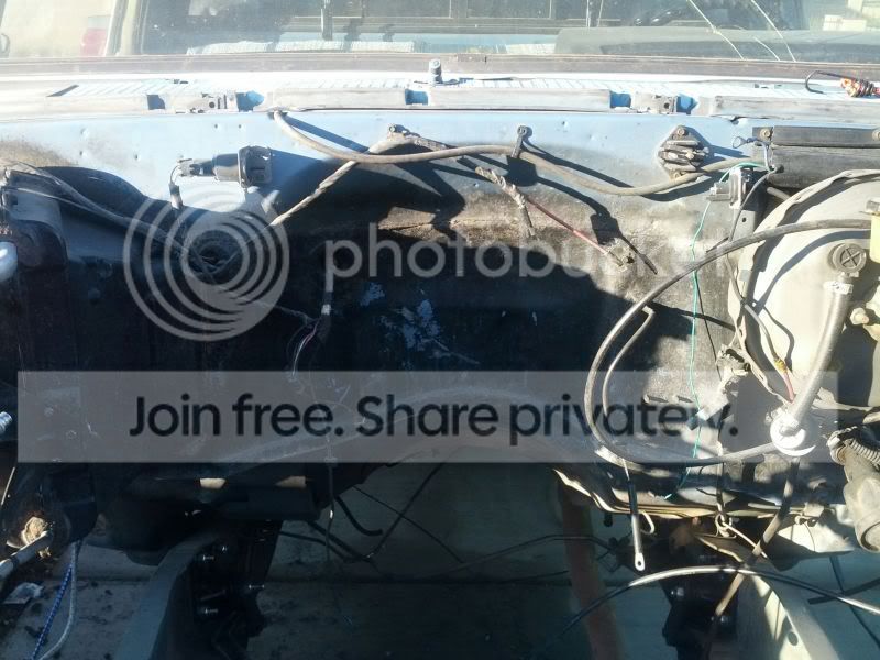

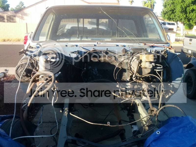

Are you planning on stripping the wiring, heating and brake assembly off of it? If not, it will be difficult to make it look good with the high mica color you want to spray on it. All of the sealer around the components needs to be stripped. Are to trying to spray the tunnel also. If so, that needs to be stripped also.
Good cleaning. Scuff well. Primer. Sand. Repeat until smooth. Then you can lay down color and clear. Not sure if that's the route you want to go.
Sound like I better get busy, what primer would you suggest?
I would like to remove it all and start fresh.
Start pulling the stuff off. The easy to use and high build stuff it would use for that is the SEM spray can. Easy to use. No gun clean up. Gets into tight areas.
