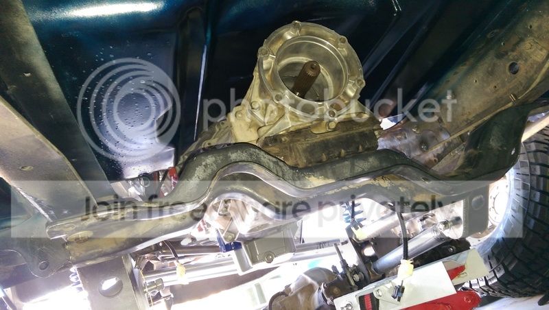

Trans is in,
What a pain it was....
Had to lower the truck down on Jack stands twice and my harbor freight trans Jack was making it go up sideways...
Odd angle of a picture but it looks cool.

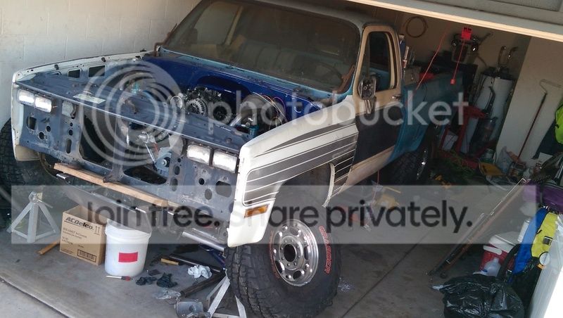

Nevernmind the mess I was to tired to clean so I shoved it away.

Have a couple questions, does the front core support have shims under it and above the frame to space it up? Mine seems to be a inch off. Can someone take a picture of their setup?
