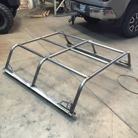

OR build a very basic bed rack system with good frame tie in and not have the roll cage inside with you. If your desire is to have a nicely street-able truck that does mild wheeling and sort of hauls ass across the desert a very simple bed rack type system with a good external B pillar setup will provide more support for the back of the cab and keep the interior uncluttered. As long as you maintain the intact hard cab with the factory structure intact this works.
