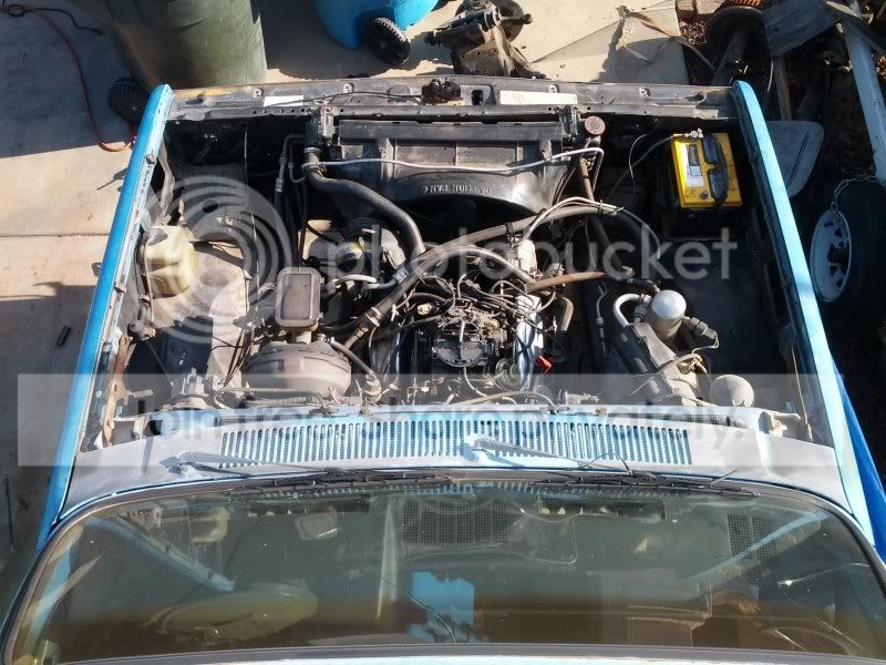

Plan for tomorrow is get the front end off, get the engine ready to be pulled, and possibly start mocking up the front suspension brackets. Saturday I plan on pulling the engine and trans, and finishing up the front end.
almost ready!
