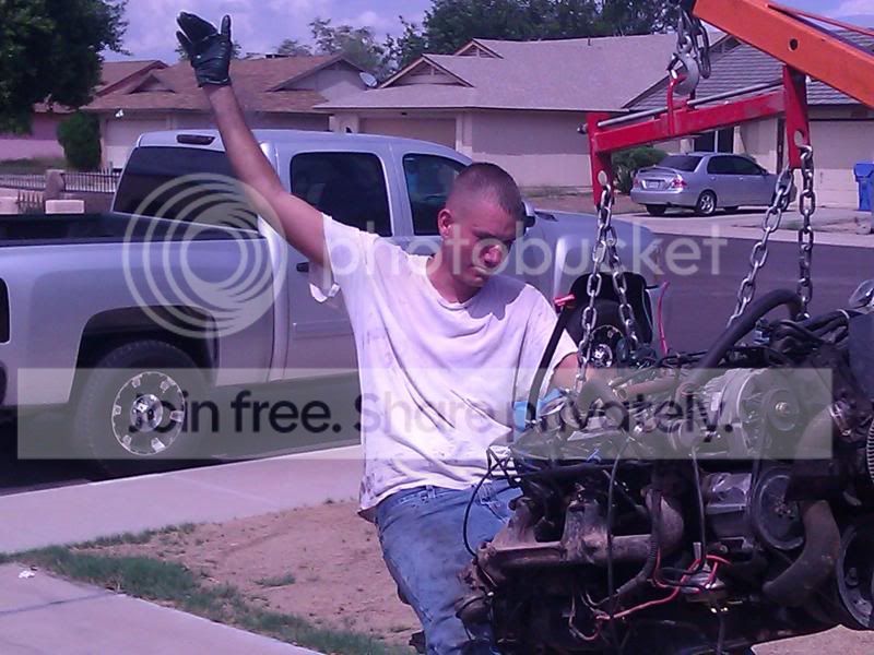

Like Slim Pickens riding the bomb? :haha:

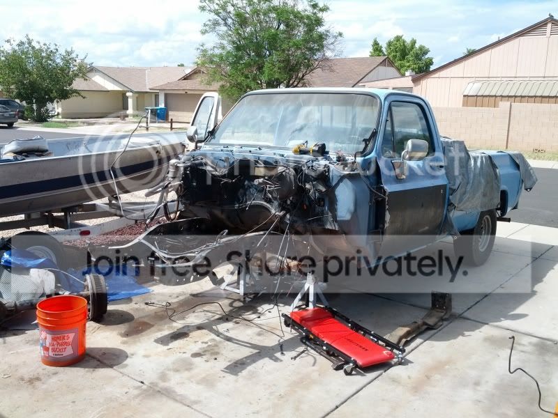

Truck now looks like this... :eek1:
Oh yes I did. :haha:
I know, I'm going to get some quotes from a mobile welder for welding up the swiss cheese.
A buddy of mine from Georgia asked me if I started painting the frame already, I said no it's just that clean.
very important safety note..........
make sure you wear gloves when you ride your transmission like a bomb
Almost...
A guy my brother works with is a welder, so I'm going to see about welding up my frame. Does anyone know if the ORD weld in repair kit for the steering box work on a 2wd frame?
Almost...
Don't see why not. The steering boxes are interchangeable -- 2WD boxes are often used for 4WD crossover -- so the bolt pattern / shape should be identical.
-- A
Looking at the frame today trying to accomplish something I came up with a idea.
What If I reused the IFS engine cross member and cut the ears off the over hang the frame rails. This would add a lot more strength I would assume but the problem comes with contact of the front diff. What do you guys think?
It is big yes but I think it would add strength for sure and we all know these frames are limited.
i'd leave it man. you are plannin on liftin it, right? once you lift it the diff should have plenty of room, which means its more important if it clears your engine oil pan?
What do you mean by leave it? It is getting 4 inches of lift and the lq4 would clear both the ifs and the factory 4wd cross member.
