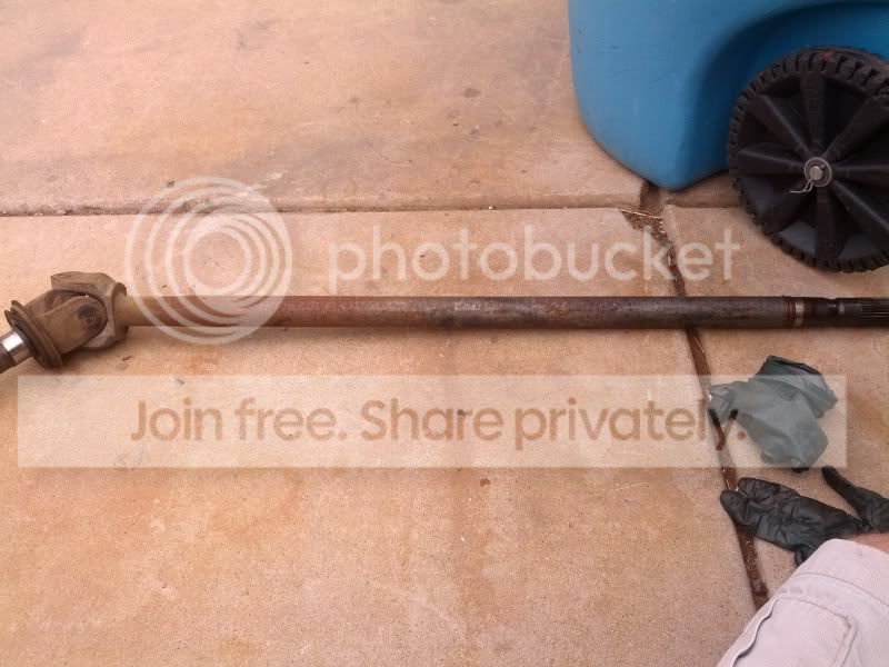

Got both knuckles and both axle shafts are out... They both look a little rusty, is this going to be a problem?:confused: I sprayed them down with some wd40 and lightly used a scotch bright to shine them up.

Gear oil is not supposed to go past the seals at the pumpkin.
The shafts are not bathing in oil.
Find out what the o3iginal diameter of the seal surface was for that axle. And check it. I had to speedi sleeve both of mine.
