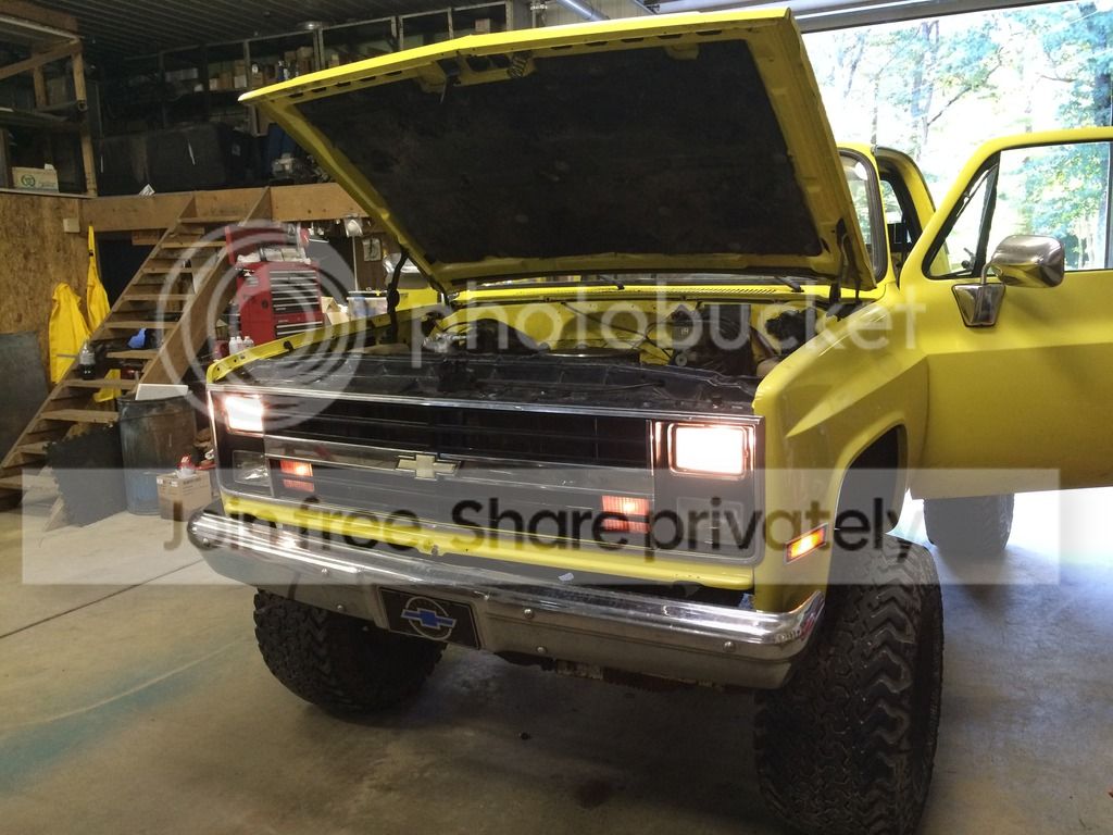

Today was a great day of just fixing alot of bad little things.
The thing was vapor locking like crazy and literally blowing flames out the exhaust when it would backfire.... Shannon was very down this morning after the drive to Bretts because it literally was running terrible, and it was raining and wipers wouldn't work, and it kept dying etc... Just no good lol.
For some reason people really love to remove return fuel lines from these old rigs. Im not really sure why, or how they ever run correctly without one.... But this is the 3rd vehicle I have installed a mopar fuel filter on with the return barb on the side and ran a return line.... Guess what, no more vapor lock.
It had wires everywhere just laying on the headers too... So i spent alot of time fixing wires, and removing crappy normal crimp connections and using the heat shrink style weatherproof crimp connectors. I freaking love these things. They like melt to the wire after you hit them with the torch.
This is how the fuel line was run... Ugh just rubber line laying on everything, nothing really holding it, just sitting on tcase...
Then I added new return line, all metal from tank to fuel filter before carb besides the 2 rubber line connections. Also i tied everything to the frame with cushion clamps and bolts with nylock nuts. I know people know me for being zip tie loving deuling, but when it comes to fuel lines next to exhaust and headers, that **** needs to be done right.
Good work. Thats a lot of half ass there by the PO.
Whats with you Michigan guys and running exhaust under the frame? lol
Much better, and the metal line looks really nice in person, I was actually super proud of how clean it turned out, with nice 90* bends with the little bender tool I have.
Also the electrical was all janky and lights and wipers werent working, I found that the bolt to tension the alternator had stripped the threads out of the alternator, so I drilled and tapped it for 3/8-16 and now the belt actually stays tight... :whistle:
While I was doing all of this other junk shannon was ripping every ground wire she could find off and sanding down all the connections and coating everything with wd-40.
I really liked watching her do that, im not sure why..... :whistle:
But now the lights work, it isnt blowing fire out of the exhaust, and the wipers and turn signals work too :woot:
Went for a drive and got chinese food. And she had a grin from ear to ear the whole time. She acted like it was a new truck....
Solid day. Gotta address getting a new fan in it with a clutch and a fan shroud, and mounting the radiator. PO had it just sitting on the frame and tied up top with a few zip ties... Ugh its gross lol.
But end of the day, lady can drive in the rain and at night, and that makes me feel much better.
