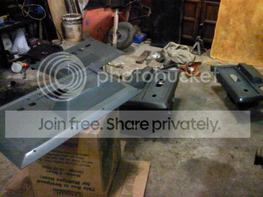

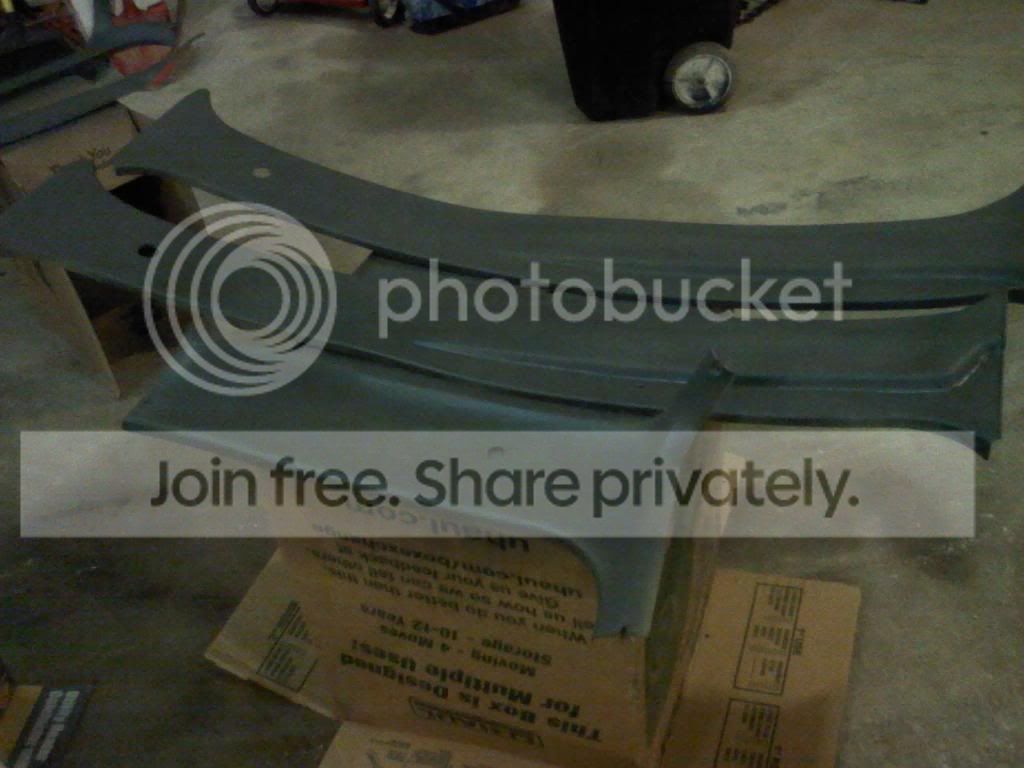

To date, I have pulled apart the interior. I finished changing the color of the trim pieces today.
The motor is pulled apart, not fully rebuilding it but new bearings and seals. Pricing out some head work tomorrow.
Here are some pics of what I did tonight

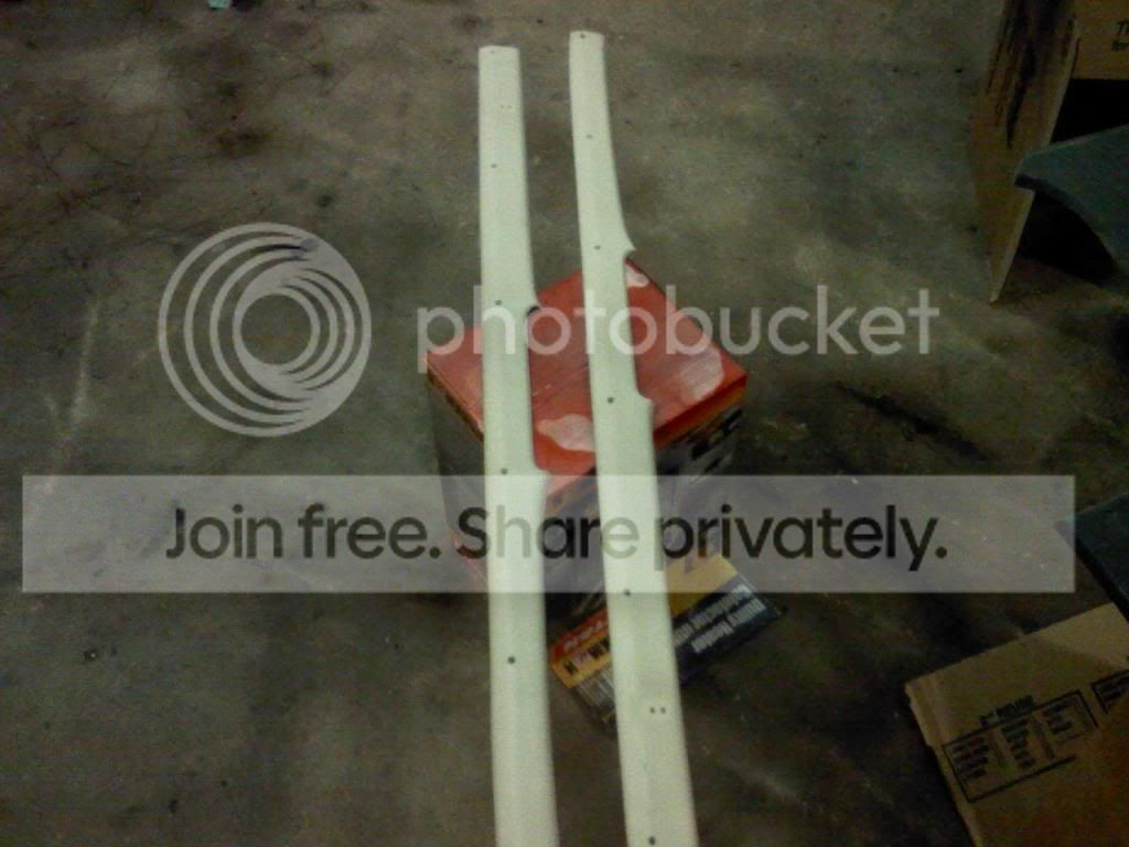

The orginal interior color was tan or white or yellow depending on how sunfaded it was
The new color is gray, sorry about the cell phone pics, I used dupli color vinyl and plastic spray stuff, Didn't want to spend a ton on this as I have different plans for these trim panels later in life

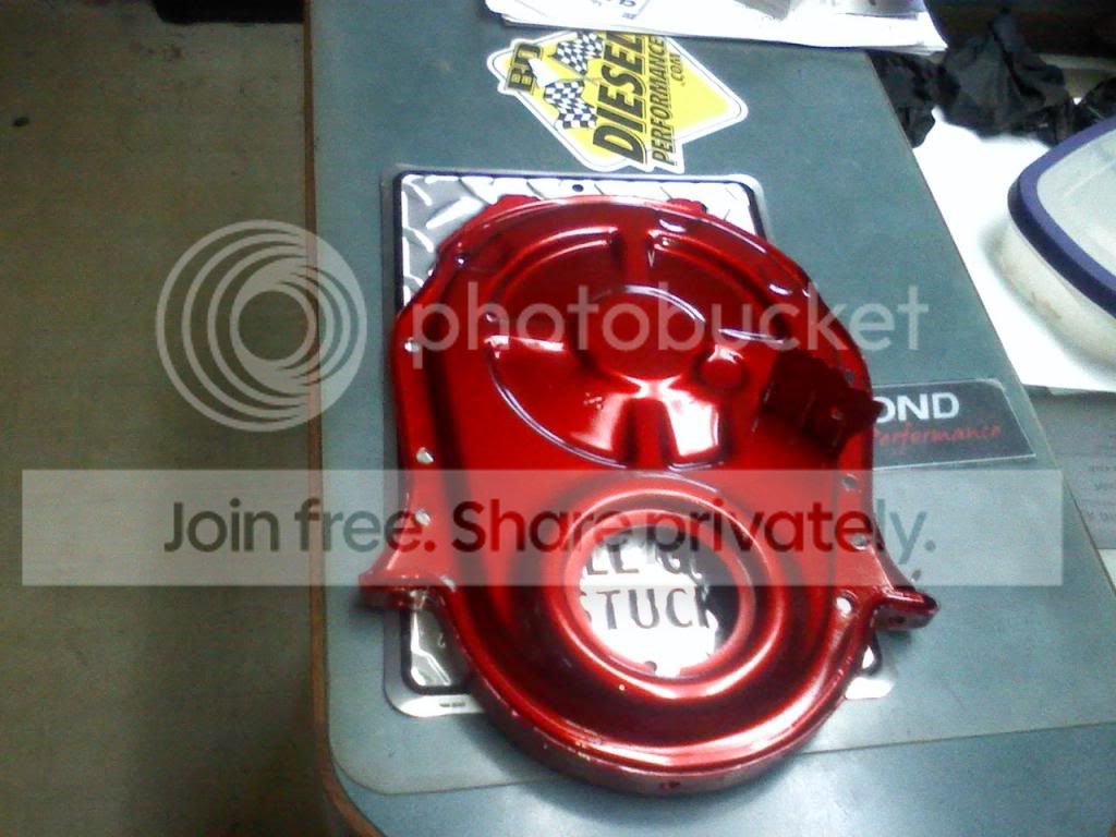

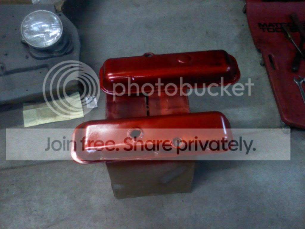

Got some stuff done at work today. Cleaned the heads and valve covers and timing chain cover. Painted the valve covers and timing chain cover
timing chain cover

Its a two stage paint that comes in a spray can, got it at autozone. Its duplicolor metalcast, I really like the paint its pretty tough too.

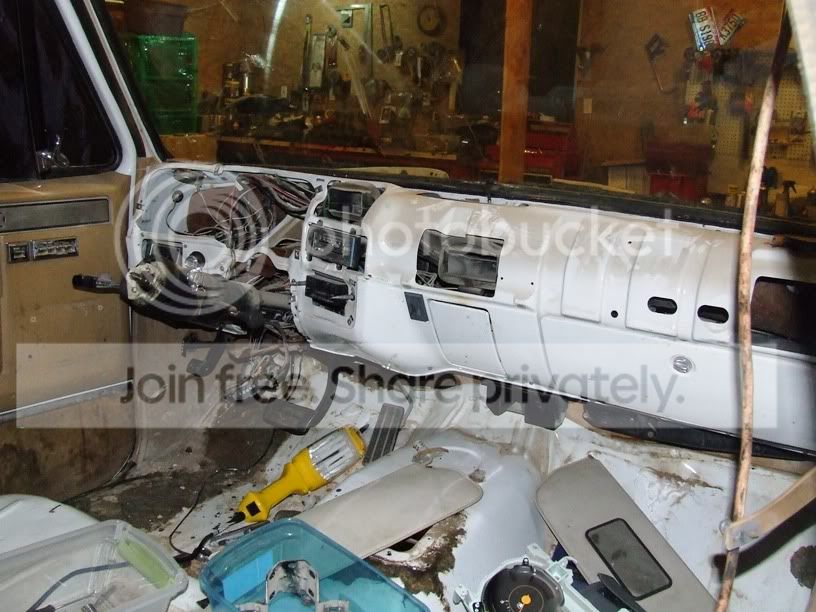

Steering column is about ready to come out pedal assembly will be in soon, here is the shape the interior is in now
I dig the duallies Eric...And that valve cover paint looks like Candy Apple Red, how does it look in the sun?

The paint looks good in the sun. Doesn't really pop like a real candy apple red would but hey these are underhood parts and the paint is actually pretty tough

What kind of prep work is required to paint those interior trim panels? Im doing a similar build on my 88 crew cab, currently its white exterior with blue interior. Im changing it to satin black exterior and red/black interior.
I actually have other plans for my trim panels so this is just a temorary solution.
If you are going to do a permanently the only thing to do different is SEM I used dupli color stuff.
I washed all the panels with soap and water and then used a wax remover and degreaser. Getting them very clean is key. Since I am going to do something else next year all I did was paint them, if it was going to be permanent I would have used an adhesion promoter. I have had good luck with Bulldog and you can get it alot of different places.
I hope to have the truck up and running by middle of the month next month. I will report back on durability but I have moved them around a couple times and accidentally rubbed them on whatever and they held up well
