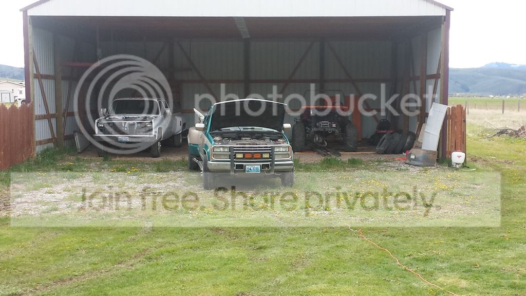

1986 crew cab dually. It takes FOREVER!

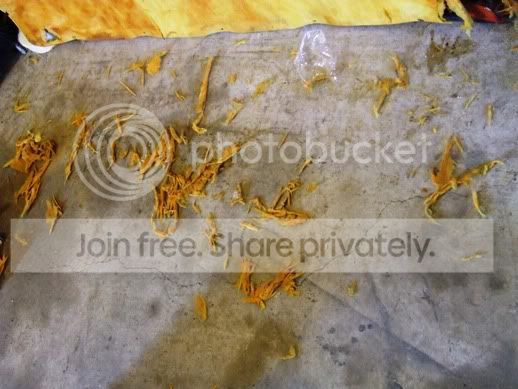

My first big project with this (well for me at least) was the headliner. When I tore the fabric off it some of the headliner came with it, leaving me with some very uneven lines that I was afraid would show through. In addition to this some of the headliner was delaminating for lack of a better term. I had several cracks around the edges too.
I have never repaired a headliner and there is not alot of useful advice out there, but some. So here goes, how I am repairing my headliner

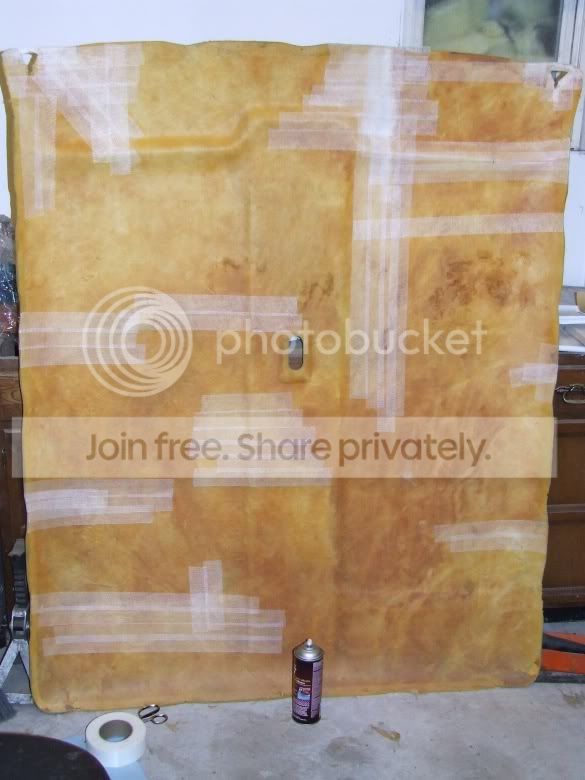

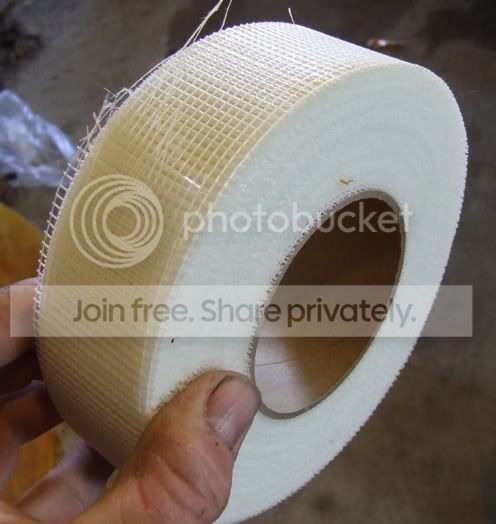

I had to figure out a way to hold the parts that were coming apart together. Drywall tape came up in a conversation I was having with someone about it. I decided to use the mesh stuff that already had adhesive on it.
I then sprayed 3m adhesive onto it

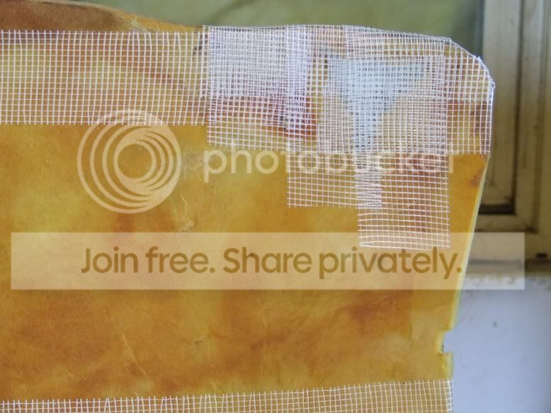

then spread the tape out on the headliner to try to achieve a more even surface. I also used it to repair some tears on the sides and to rebuild a little of the headliner where the visors mount
I put the tape wherever the board was coming apart to hold it together, almost every peice that hits the side actually goes all the way around the back of the headliner to help it stay together a bit more. All in all I think it came out good.
I will be recovering the it with headliner material soon so we will see how it come out but it feels pretty smooth overall.

Thats why some of the tape seems to be in random places, still a couple places where it was loose (where the headliner seemed to becoming apart) the tape goes over those areas and across to what I think is a pretty solid area. Still only time will really tell if i succeeded or not

Damn I can't believe I haven't done anything to this in 6 years.
For shame for shame.
I got the headliner done.
And a new engine trans donor
6.5 with a 4l80 that needs rebuilt.
I really hope to chronicle progress this spring summer. I'm gonna get it together with what I have making it as nice as possible for as little as possible
Here's the 86 eyeballin the 93
Oh and I'm doing a 73 front clip. I must have another thread on this thing somewhere
