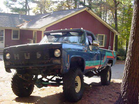

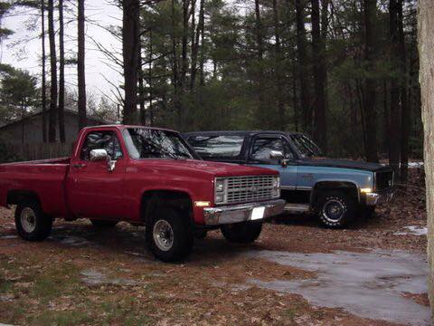

My first was an 87 blazer but it was so rotted i ended up parting it out. I got an 84 shorted shortly after. It had a newer crate motor, not the best thing for a 16 year old kid. The frame was rotted on the left side and broke at the front spring mount. Ended up selling it, got it back years later and parted it out.

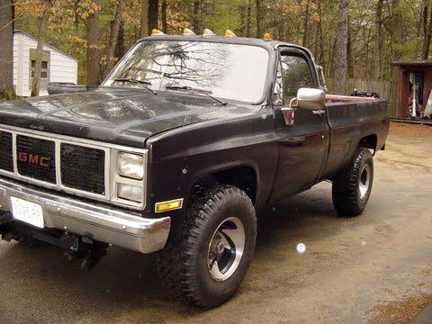

My family had an 87 gmc 2500 plow truck. It's what i learned to drive in

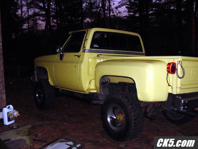

Then came an 81 stepside, the steering box tore off the frame, and i eventually got it fixed and sold it
