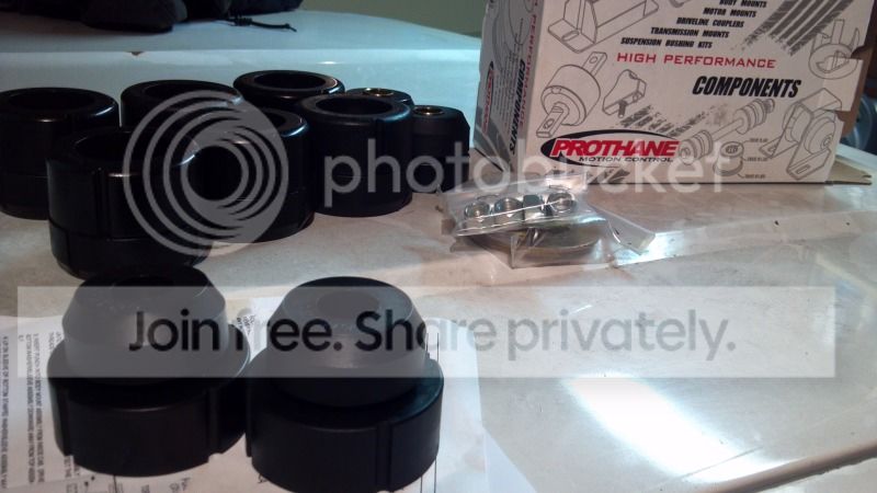

Body mount are going in. Got the fronts and the 4 cab mounts out but one. The bolt broke and left half of the bolt still threaded in the nut welded in the frame. Of course its boxed in so going to have to drill a hole in the floor then drill it out. Any other ideas?

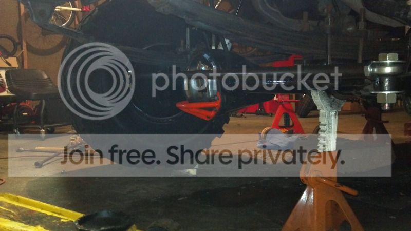

Dana 44 with 4.88s and lock right locker is under the truck and all ready to go. Time to start the rear gear swap now.

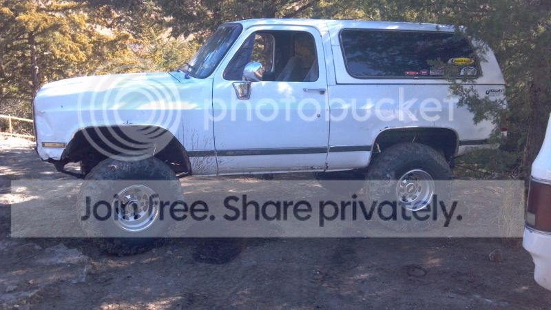

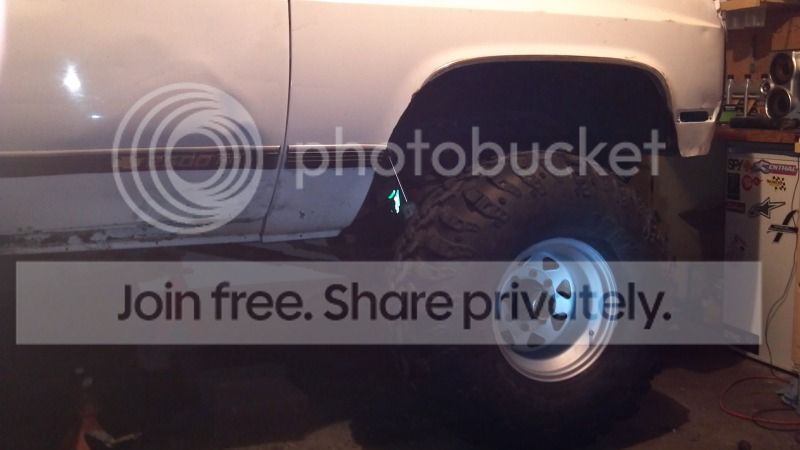

Did some more trimming and wheels are silver now

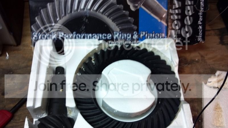

Pulled the carrier and found a gov lock:woot:Its no detroit but it will do for now.
These are going in tomarrow and hopfully have it back on the road
Yep got them in the mail today, Ill get some pictures later. I went with the pre 99 caps

Was able to get 3 cab mounts since one broke, still need to drill it out. The front 2 were in but the hole in the frame horn is bored from the old rotten mounts moving around. Ended up poping out the front right one, have to use a bigger washer i guess

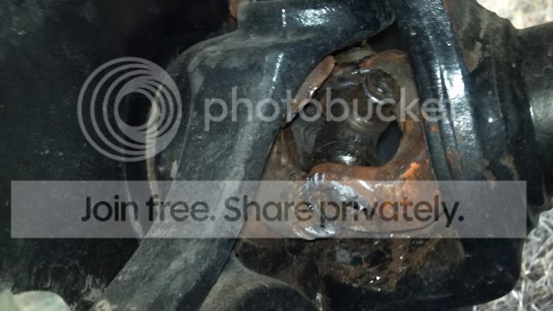

Then off course since its my daily it had to break. Popped a u joint while i was crossing the creek out at the farm. Was in a tough spot as i was and had to keep it 3wd to get out so i destroyed my RH outer shaft. This was my weak link and now will have to be upgraded
Time for a chrome moly short inner and outer and a heavier u joint

Has a chrome moly long shaft the short was broke when i got it and i threw in a junkyard pullout, didnt last very long
I have another extra outer i could just throw a new u joint in and run it

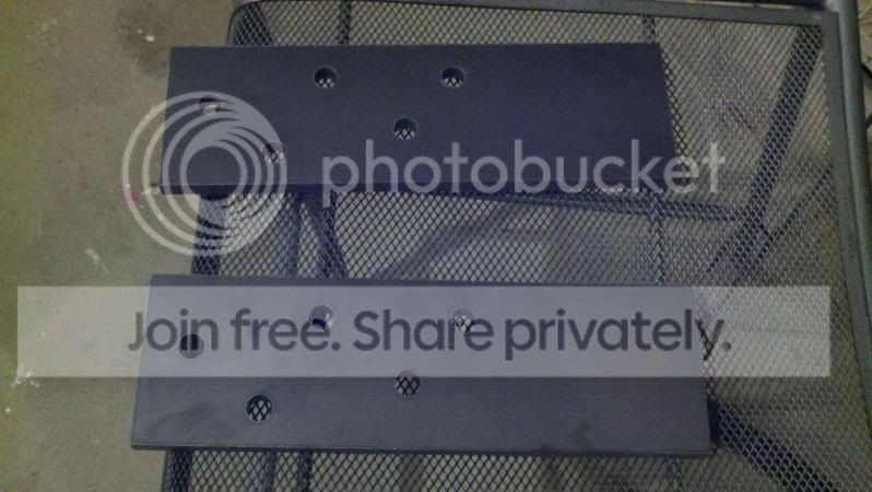

Also got these laser cut so its about time to start the bumper

Got a good start on the bumper last night, its on the truck but not usable or nearly done yet
