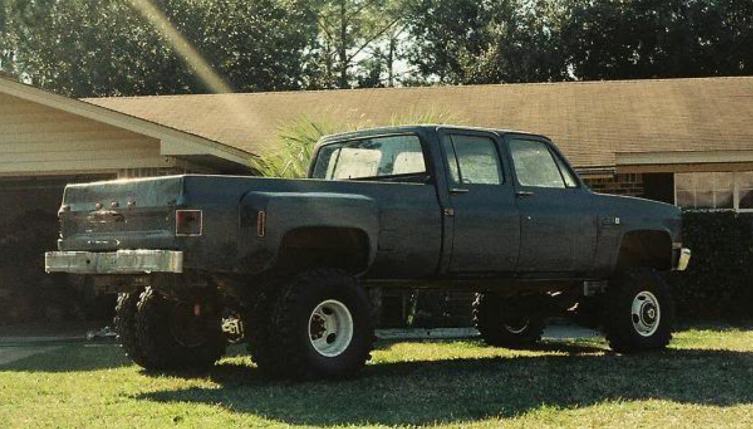

Ok guys it’s big dumb mud truck time.
The k30 is going to get some honkin tires on it one way or another. The plan right now is as follows:
8” front springs, zero rate 1.5 forward. I already have a 1” body lift on it.
42 tsl on 17x10 hubcap wheels with a 4” backspace.
I’m afraid it’s gonna rub the back of the fender. I’m probably OK with cutting the front fang off a little.
I’m also afraid it’s not gonna stick out enough and look as ridiculous as I want.
I swear the internet has blocked all pictures of 10” lifted squares to see what this looks like.
Just to get this out of the way, I will NOT run a 52 up front.
Who’s got pics to talk me into this further?

My old crew cab had 6” and 35’s on 12” wide wheels (4.5” backspacing, iirc) and it rubbed occasionally. 8” and 42’s might drive around ok but I guarantee they’ll rub off road.
Since you mentioned 10” lift trucks so…
This is @tarussell old 83 dually with about 10” lift and 38’s, it’s a narrow set up but you can see the height bs tires.
Also check the Chevy’s in the Wild thread, Tom posted a couple of other pics of the dually there yesterday.

My math didn’t quite work out so good on leveling out that truck using two sets of springs to achieve the lift.
The rear came out to be right at 9-1/2” but the front was 11” dead on so keep that in mind for judging the front clearance.
