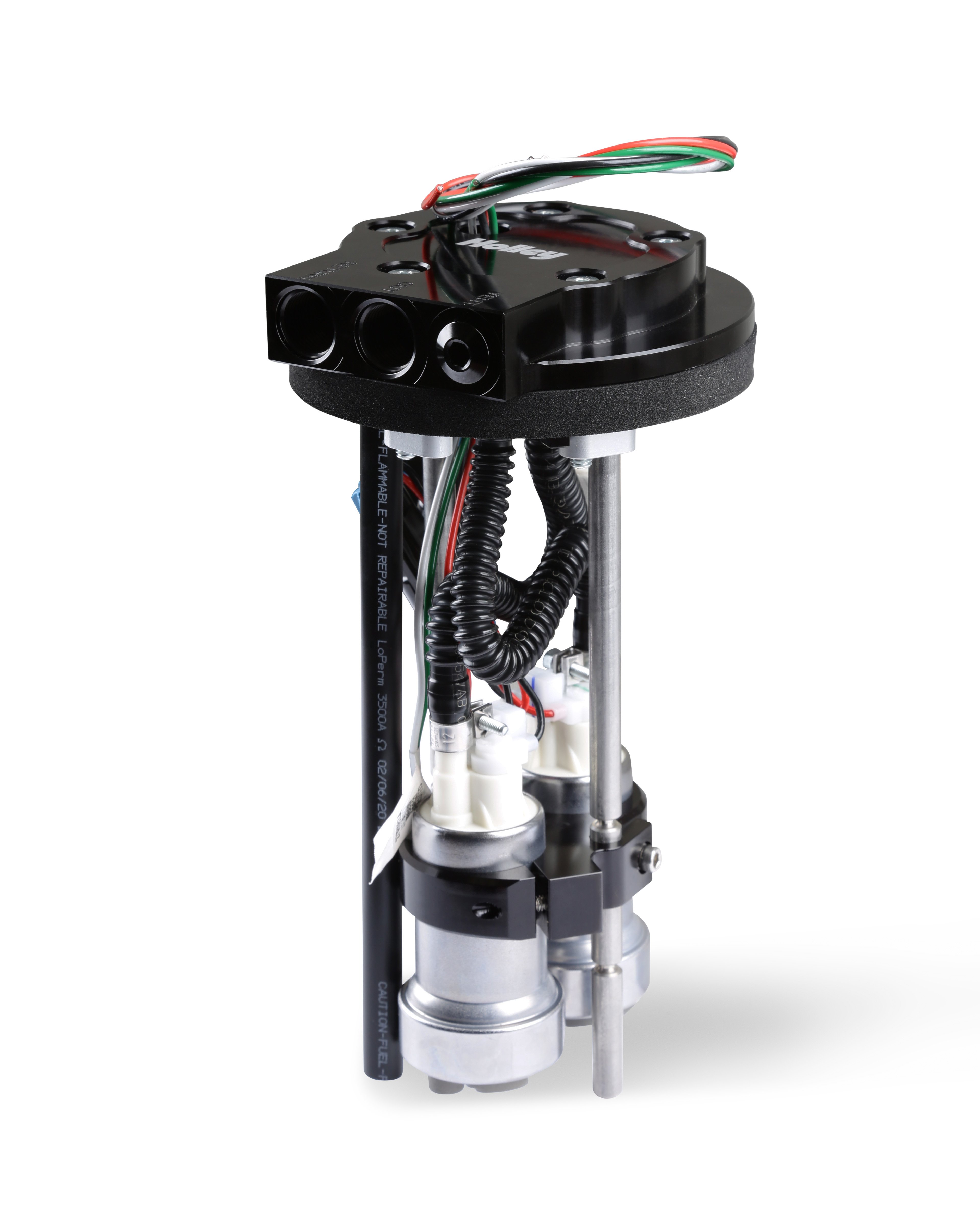

I vote for dual pumps cause I want to see how you do it.

Since I decided to move forward with the dual 450 Walbros, I have already cut the tank inlet to about 4" to clear the dual pumps, and drilled for the sending unit and deburred both with a mirror, then cleaned inside the tank first with a vacuum then the hose, and dried..
