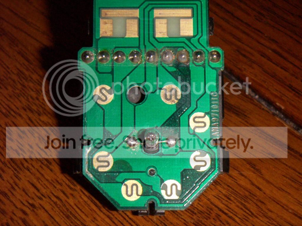

I fixed the power mirrors tonight. Cleaned the switch and went from no movement to having only left and up. Checking deeper, I found a bad trace on the switch circuit board (see where I was scraping):

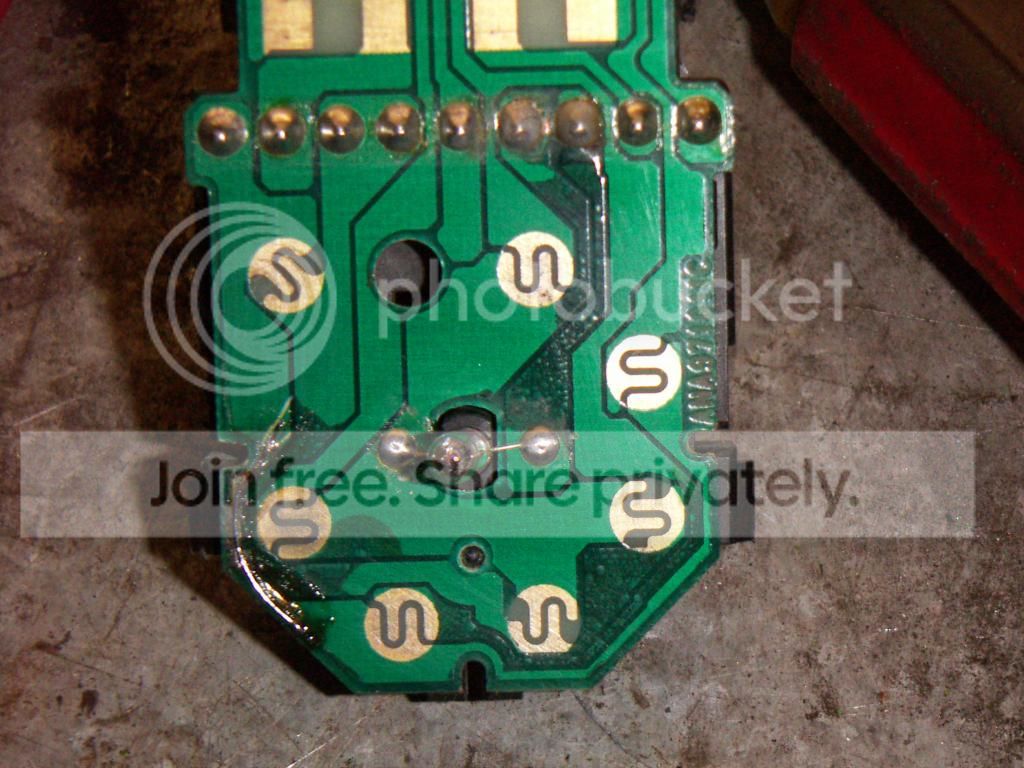

This was an easy solder fix with a strand of wire:
Now it all works.

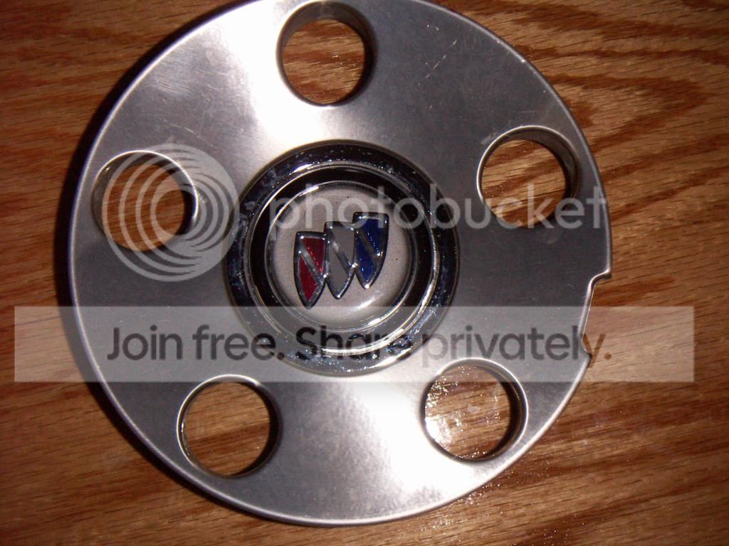

I was running Mustang wheels on the GTP for summer tires and had grafted Pontiac center caps where the horse logo went. I swapped them onto the Buick to check them out:
I decided to keep them, so I converted the center caps again:
