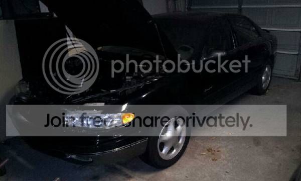

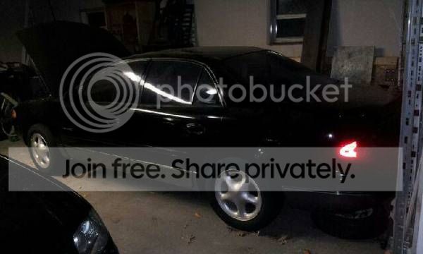

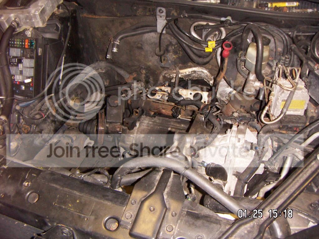

OK, here's the pics I have:

My other option is to build an engine. The parts car will include two engines. The original engine has 3 or 4 chipped pistons and some kind of head damage I haven't seen yet (heads were at a shop when I was there). The other engine is from some Olds (LSS?) and has bad bearings. I guess I don't know where the heads are from that engine. So I could pull the Olds pistons and put them in the Buick engine and get some used or refurbished heads. I don't know anything about mixing together used parts to make a running engine.

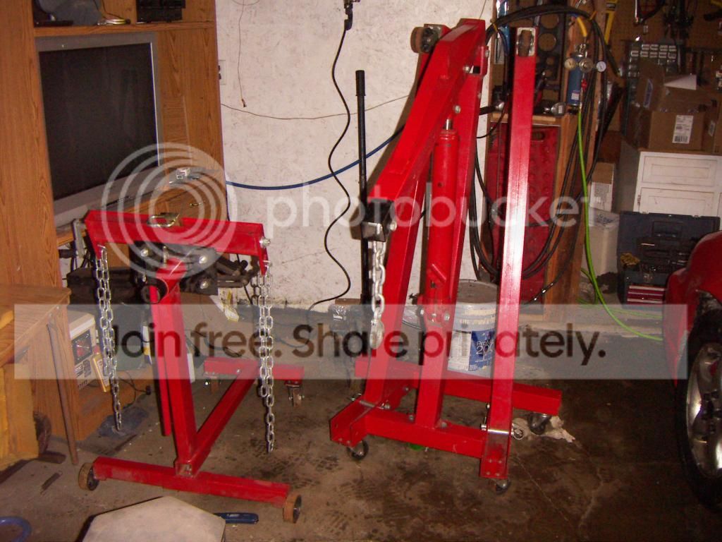

Tonight's score:
2-ton hoist, engine stand and load leveler, all for $122.
